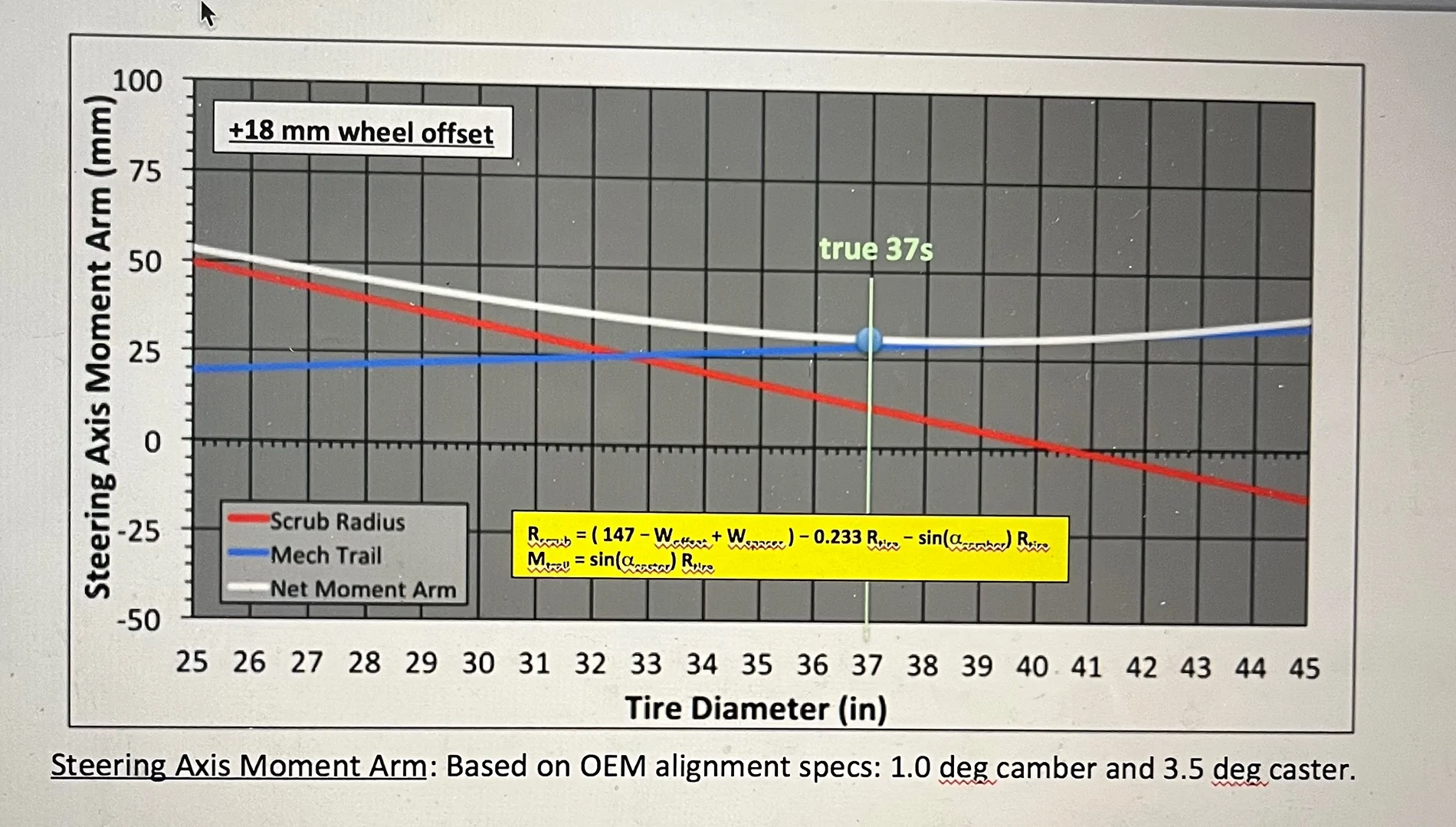

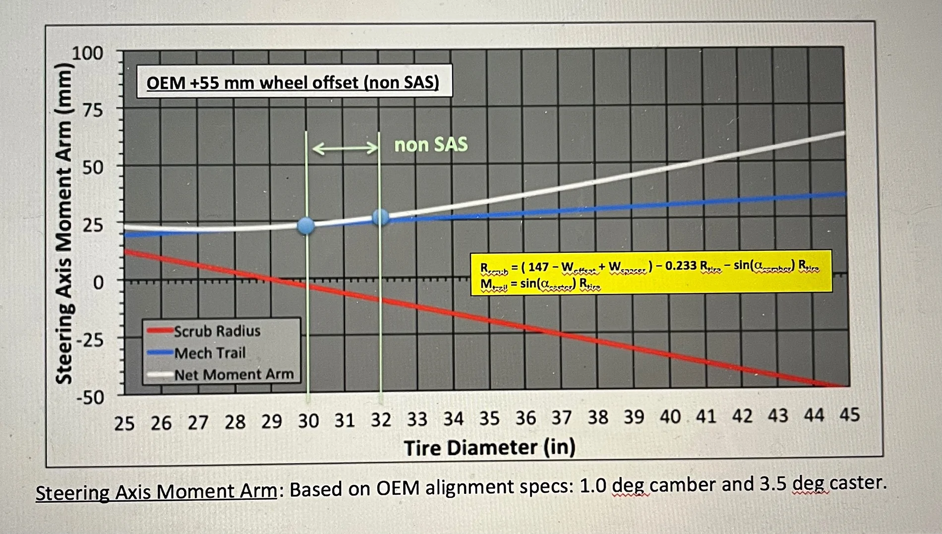

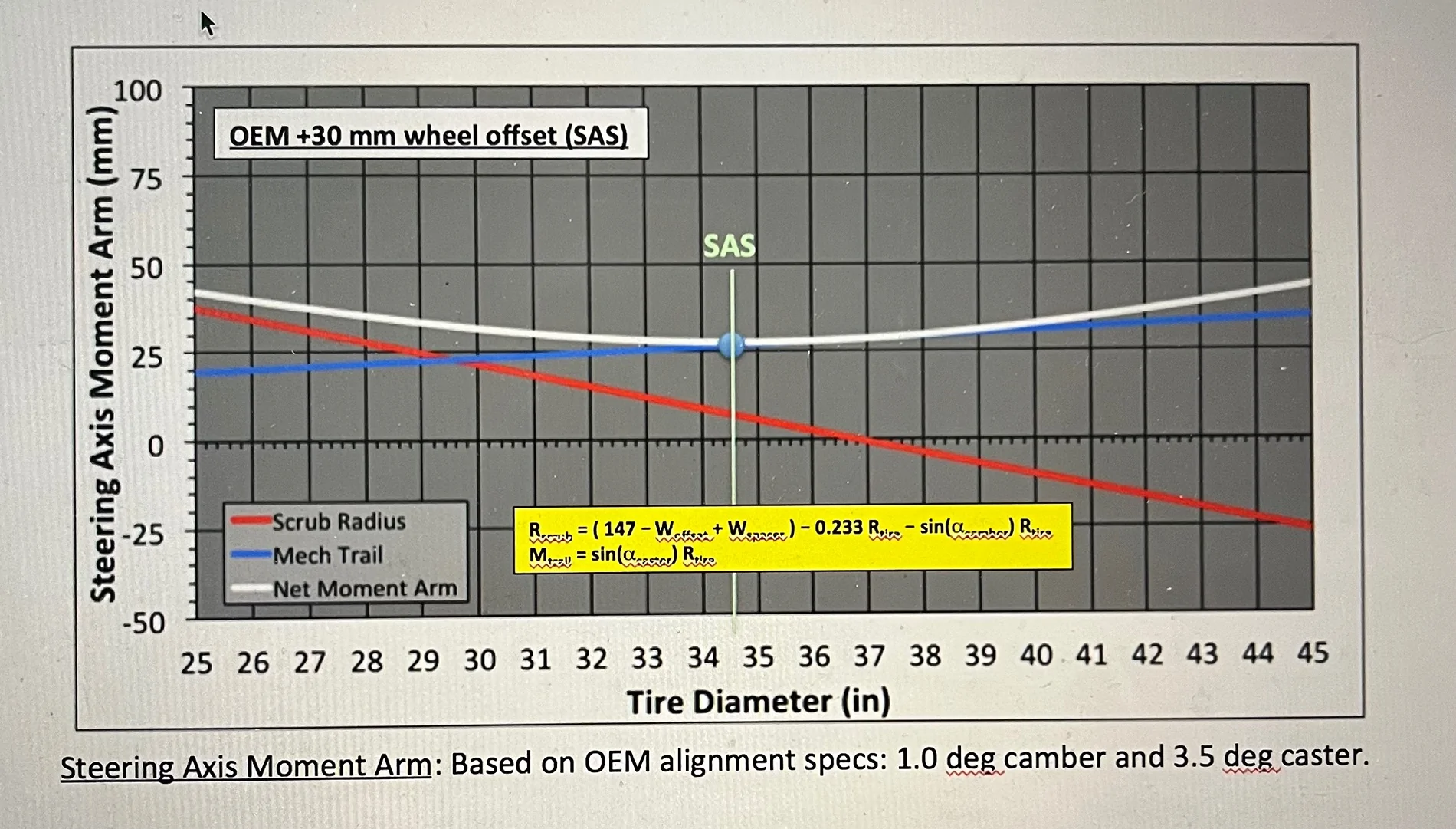

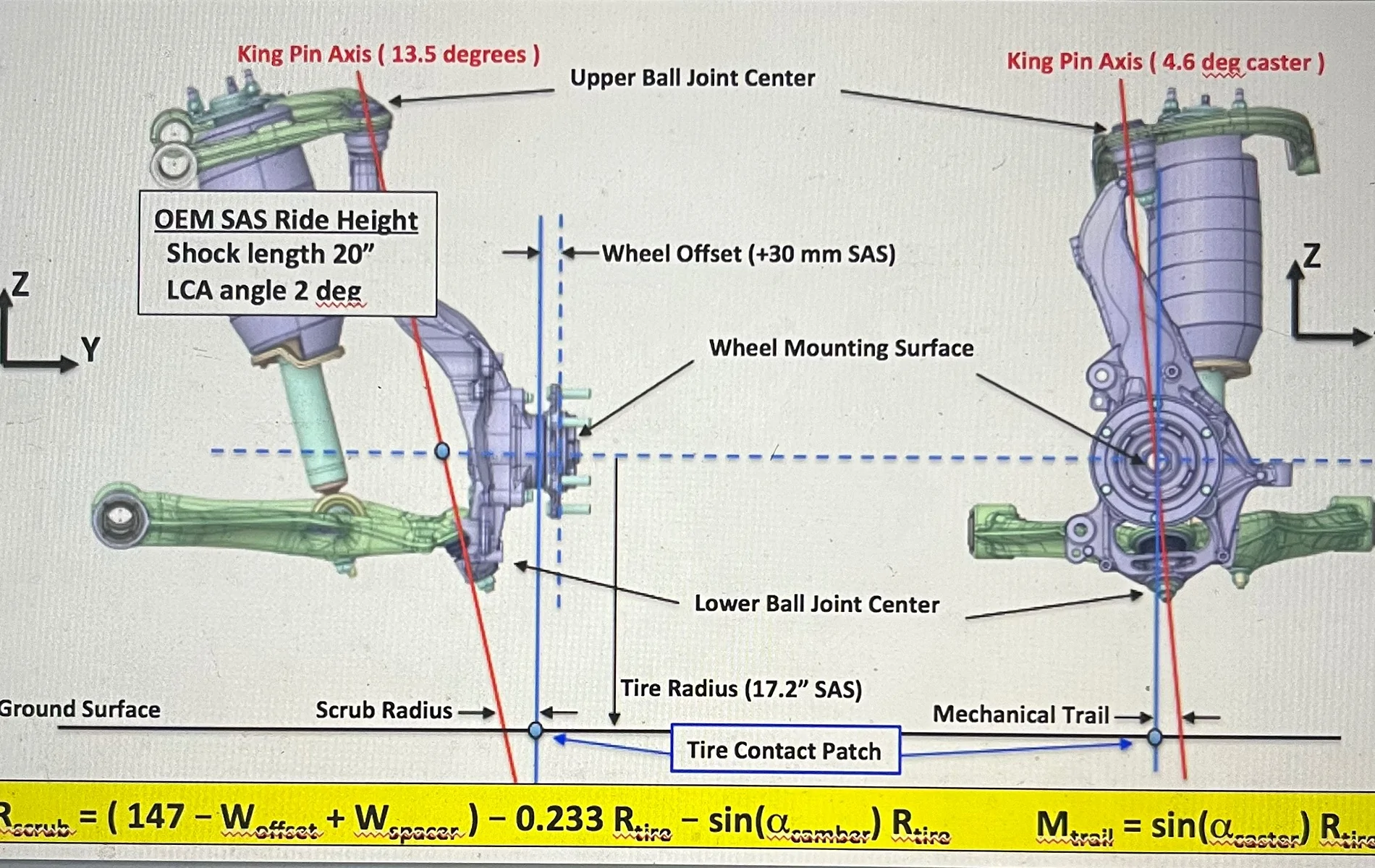

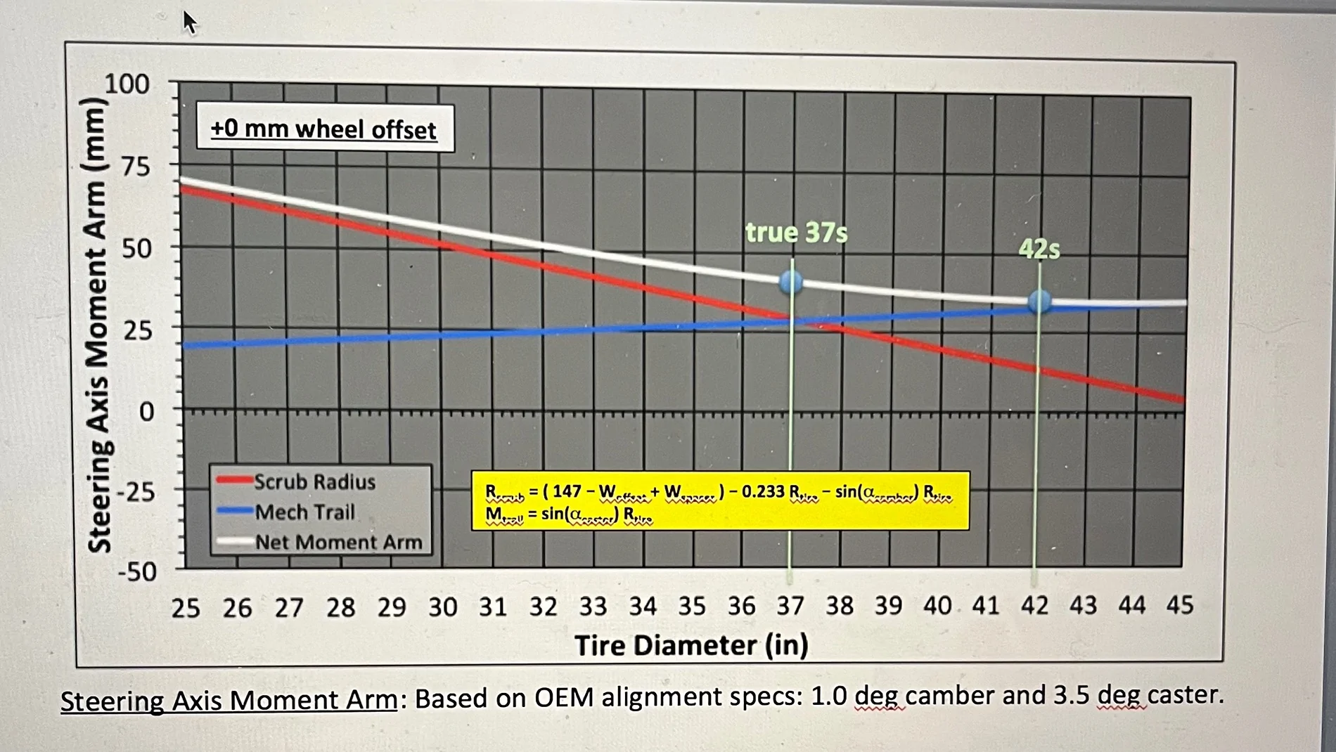

For those interested. Plots of scrub radius for various tire diameter and wheel offsets. Shown for Bronco king pin axis.

For those interested. Plots of steering moment arms as functions of tire diameter and wheel offset. Shown for Bronco king pin axis.
That is really fascinating, and I wish I knew what it means. I do see that 35" SAS tires sit comfortably at the Centerpoint of the data curve, and 55 offset (32" and 33" tires) right before that. Would you care to elucidate how to use the data?
DaddyO

I would be interested as well. it all looks Greek to me.
elucidation: plots of scrub radius for various popular wheel offsets and tire sizes.
the OP specifically asked
I'm planning to upgrade the suspension, wheels, and tires on my 2025 Big Bend and I am curious about how I can figure out which offset I need.
scrub radius is a common metric used to evaluate the stress on steering rack due to various tire/wheel offset combinations.
