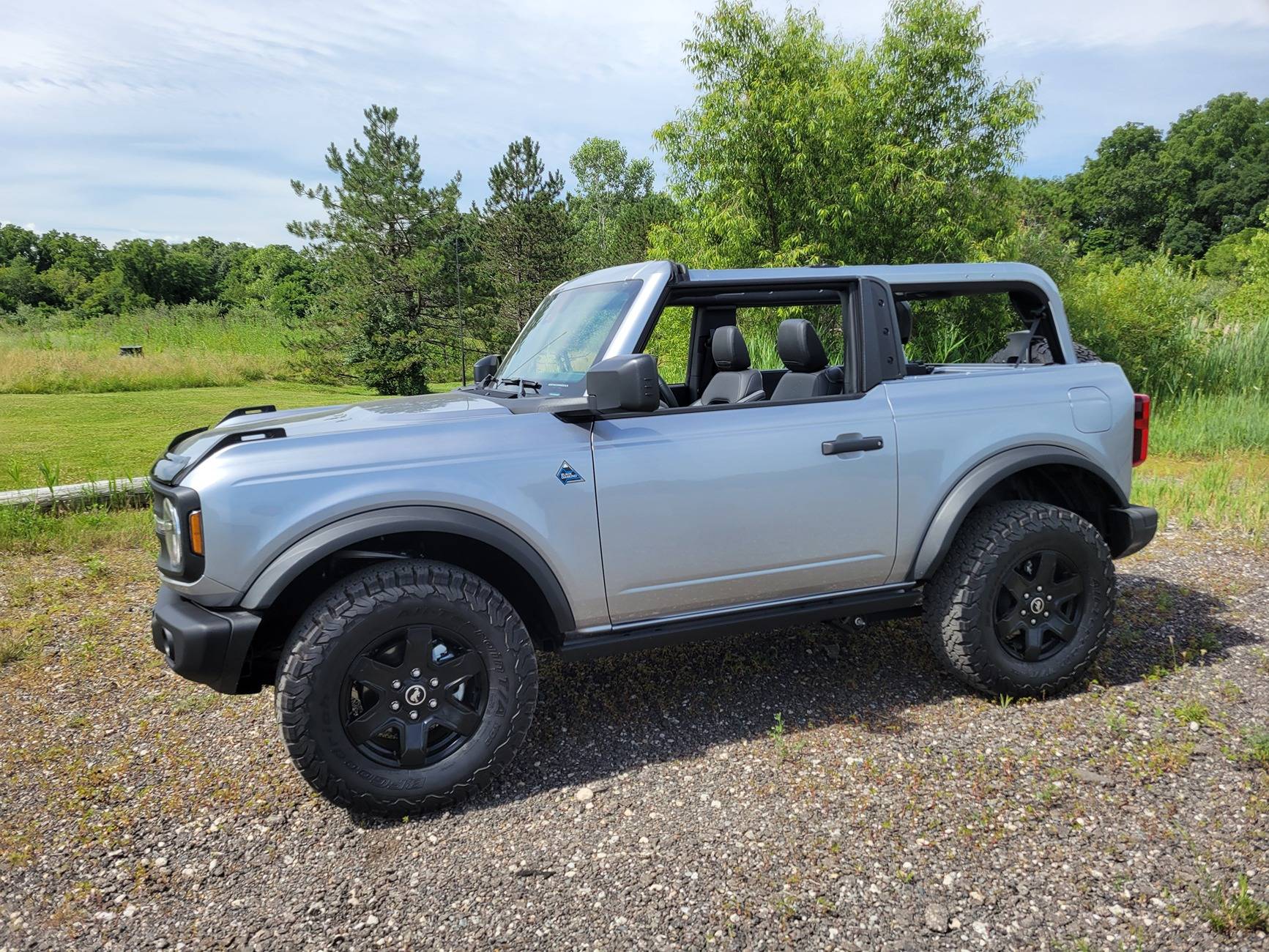

Just in case you want to see a Black Diamond with 285/70R17's on stock wheels. I have the aluminum wheels but they are the same spec as the steal. No lift or mods.
Looks great! I want to save the extra inch with 16" wheels as easier to slide in and get a nice offset with SAS flares to give the wide look. Nice rig! Love my 2 door top off too.

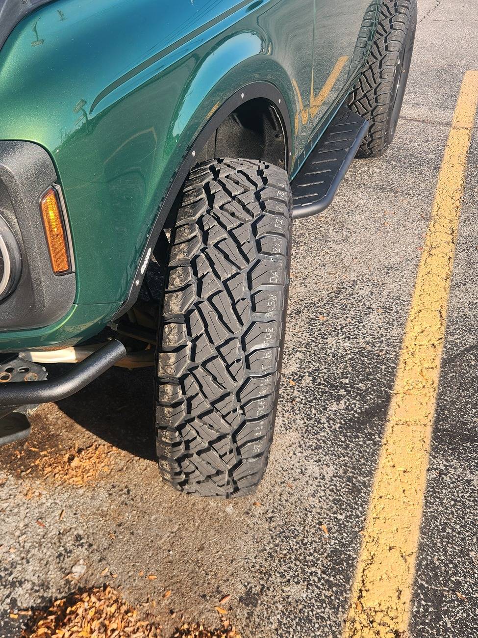

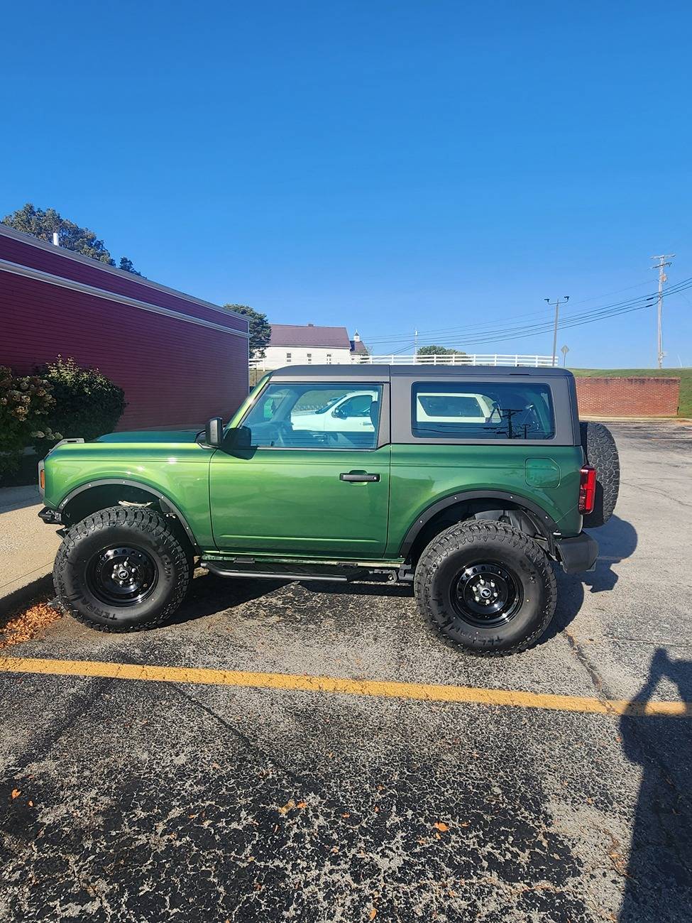

37 12 50 17 on a steely.
Ford Bronco What offset for BD with these wheels and tires? 1000000796
Ford Bronco What offset for BD with these wheels and tires? 1000000795
Mike leggiero
Jul 31, 2022
181
258
Ky
they are 37 12.50 17 but there about 10.50 wide i have 1.5 wheel spacer and a 2 in lift. tire are terramax rt they run skinny
