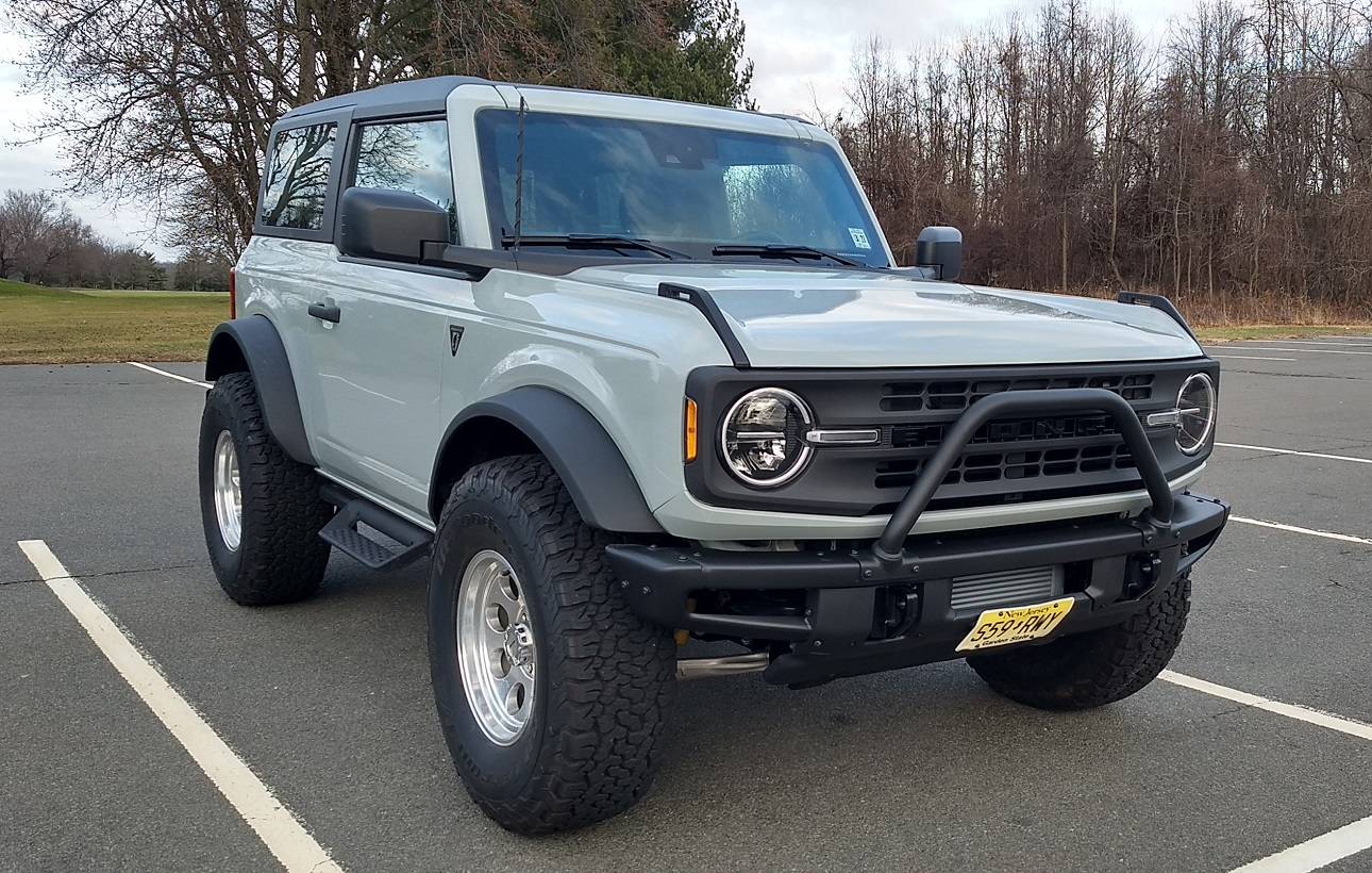

Here is my base Sas with 37x12.5x17 tires on 17x9 -6 offset wheels for reference.
Ford Bronco What offset should I go with for my 2022 base mybronco_37stock12
I think the -6 offset would stick out too much with the stock flares.

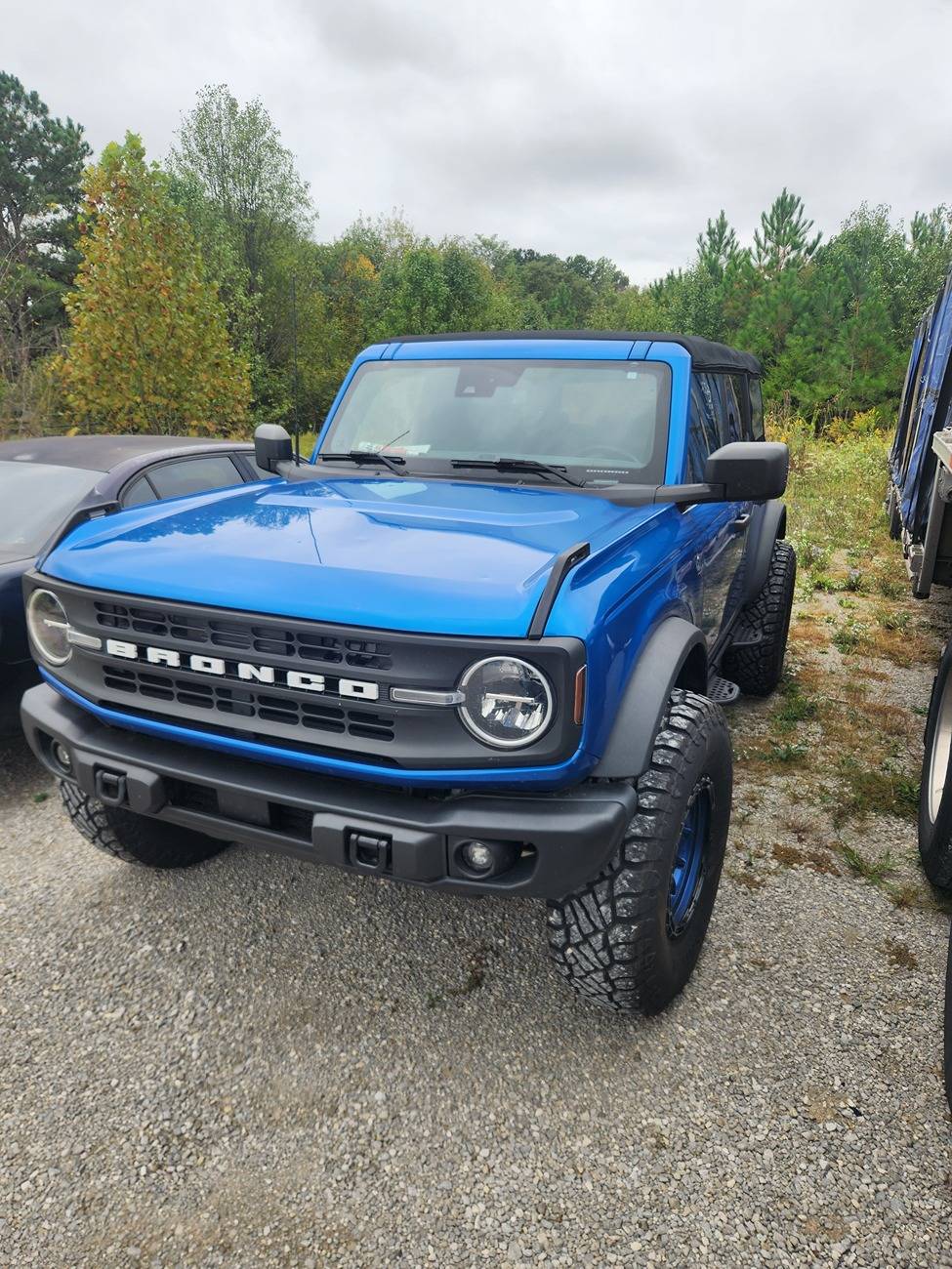

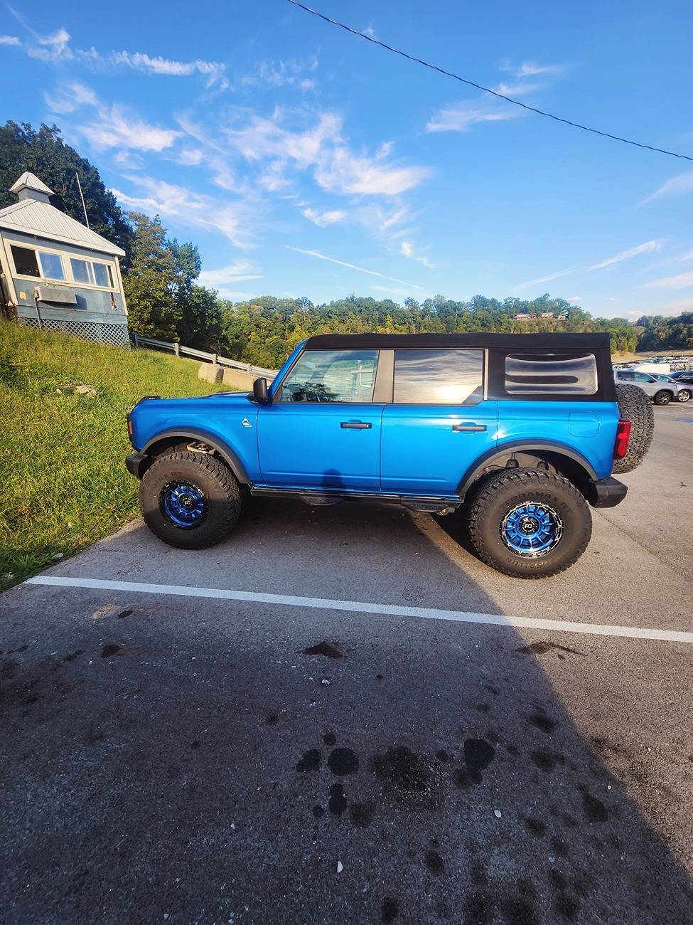

my other bronco on black rino -12 with 37terramax rt 2.5 lift. the green 2 door is mine with the steelys
