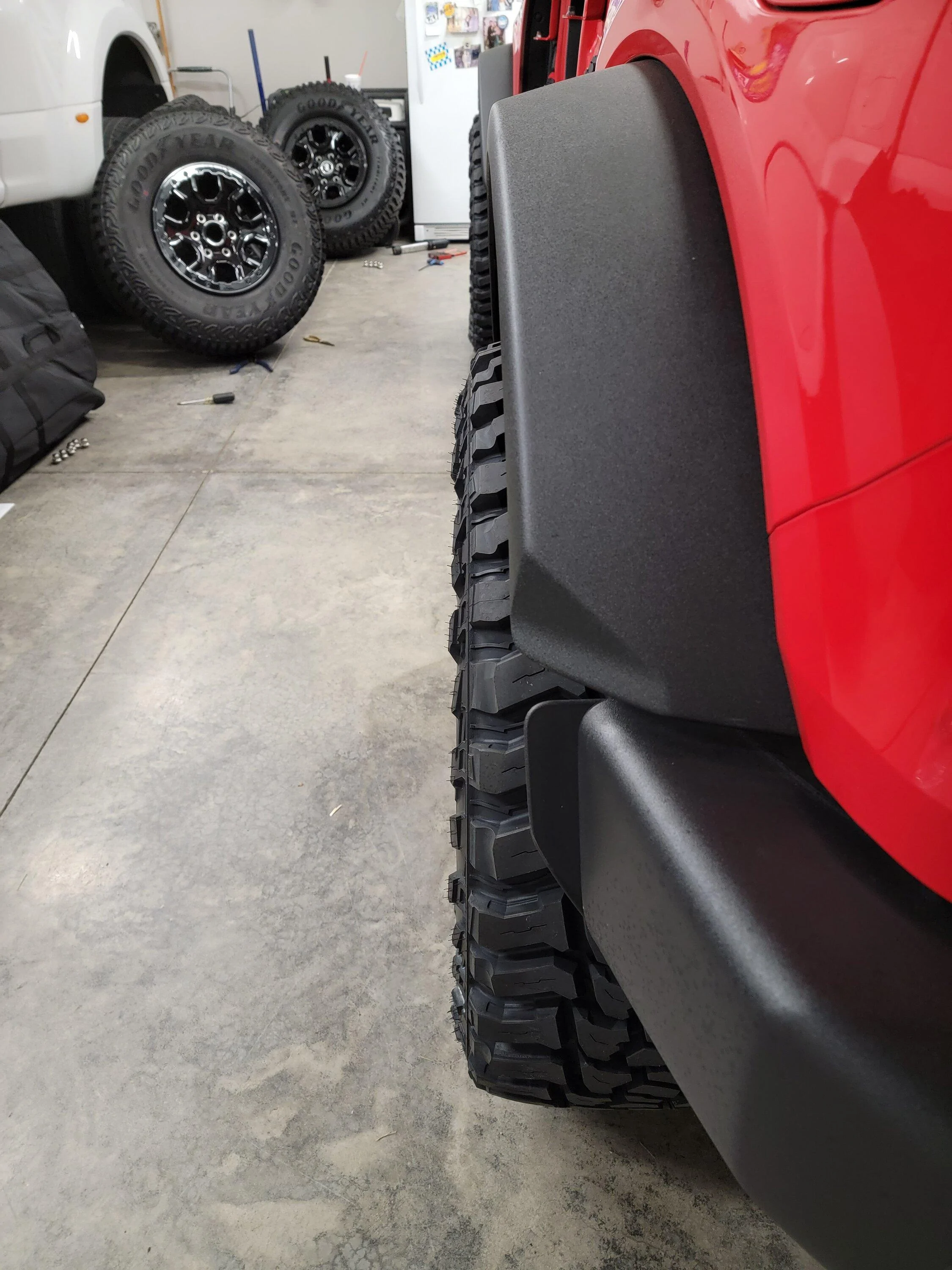

Yes and no. Since mine is a big bend they are not stock size but are the stock tires/size for the badlands. 285/70/17 BFG KO2's.
I think the fact that my wheels are 17x8 also helped keep the poke in check. The backspacing of the wheels is 5.21".
You have any other pics from a little further away? I want this exact same look. Thanks!

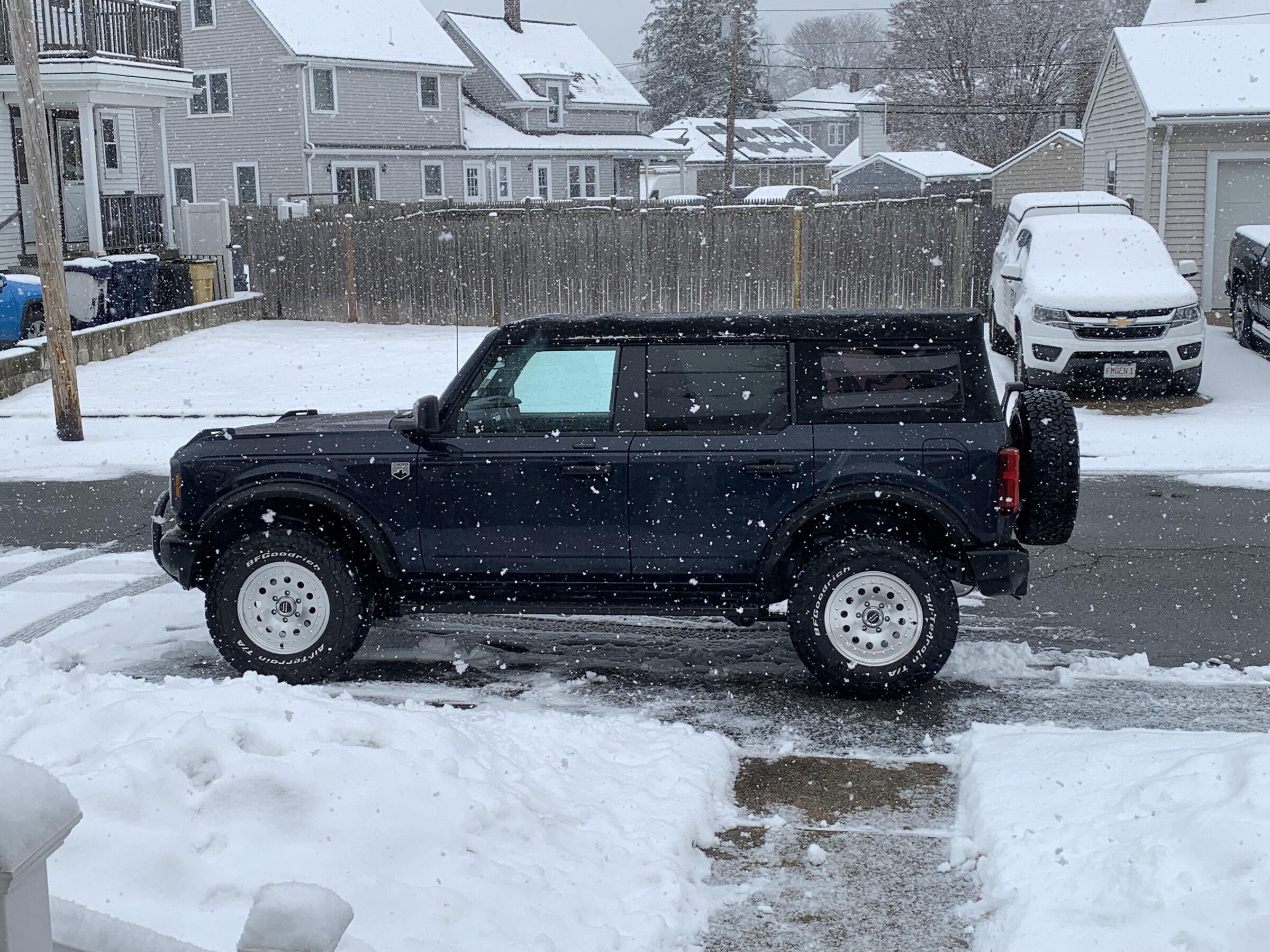

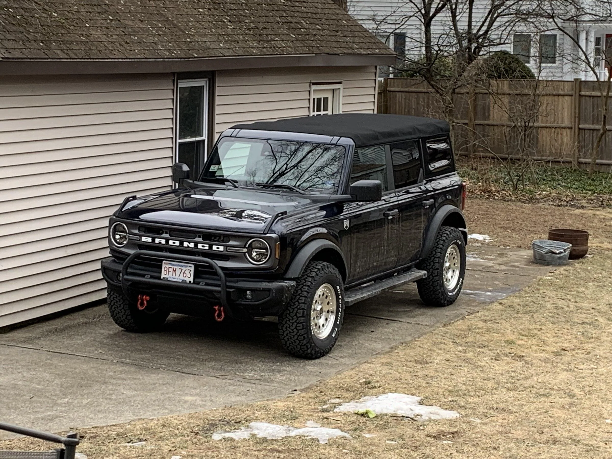

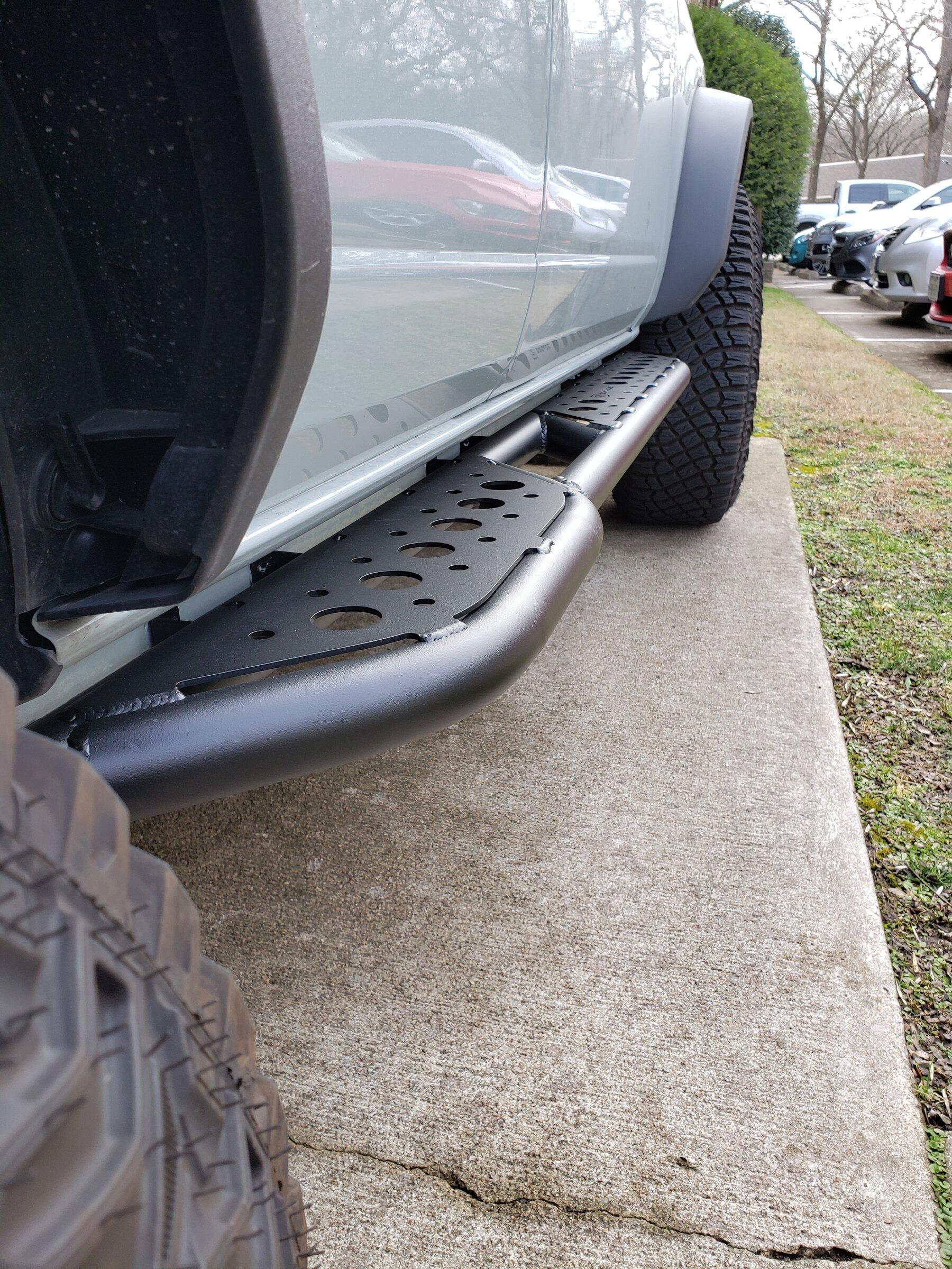

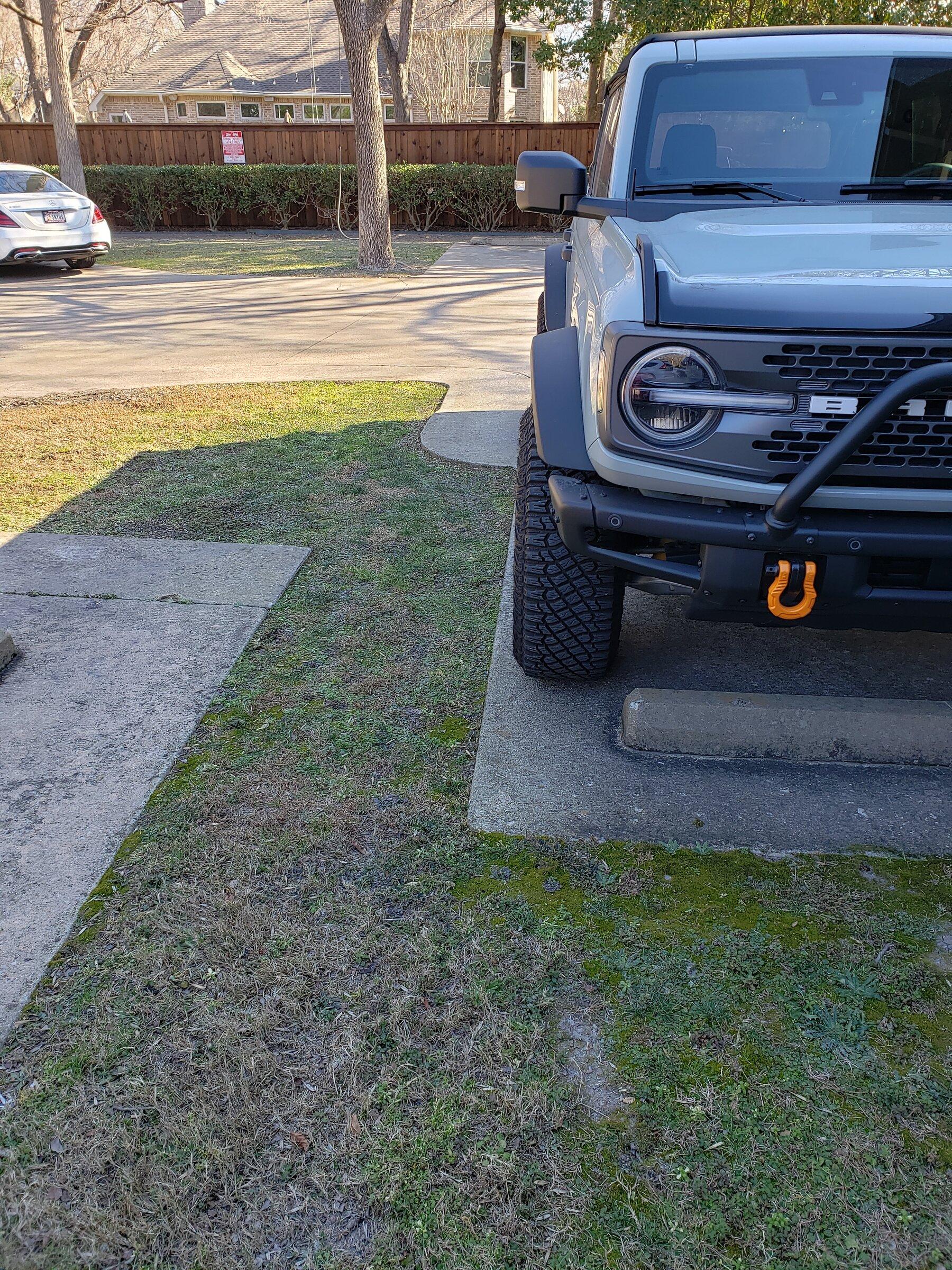

I don't have any straight on from farther away but hopefully these help.
Ford Bronco What offset are you running? IMG_6437
Ford Bronco What offset are you running? IMG_6430
Ford Bronco What offset are you running? IMG_6422
Ford Bronco What offset are you running? IMG_6411
Ford Bronco What offset are you running? IMG_6412
Ford Bronco What offset are you running? IMG_6402
Ford Bronco What offset are you running? IMG_6401
Ford Bronco What offset are you running? IMG_6386

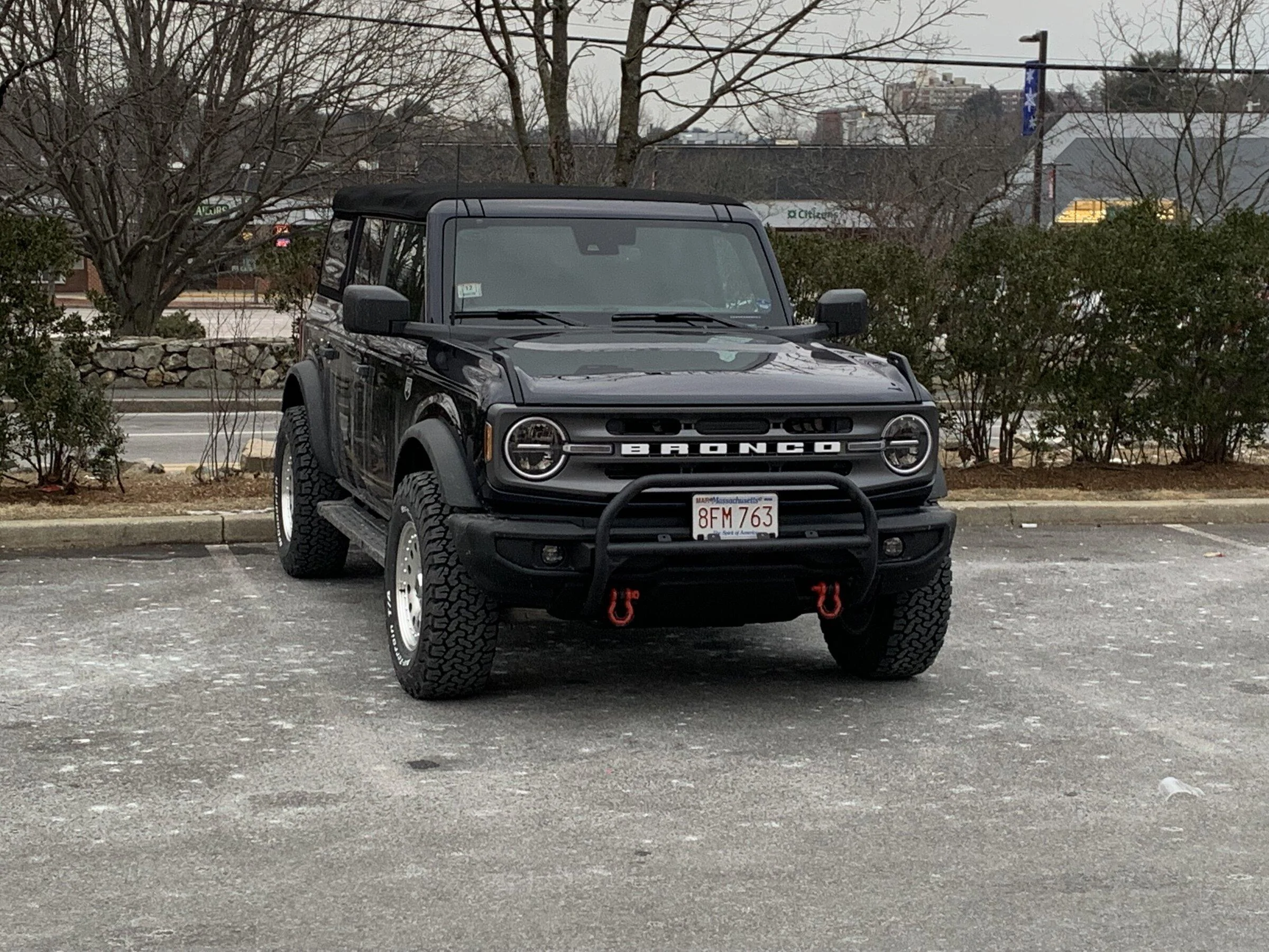

Bybotie
Nigel
91
148
Edge ST, 2021 Mustang Mach1 HP, 2021 Bronco

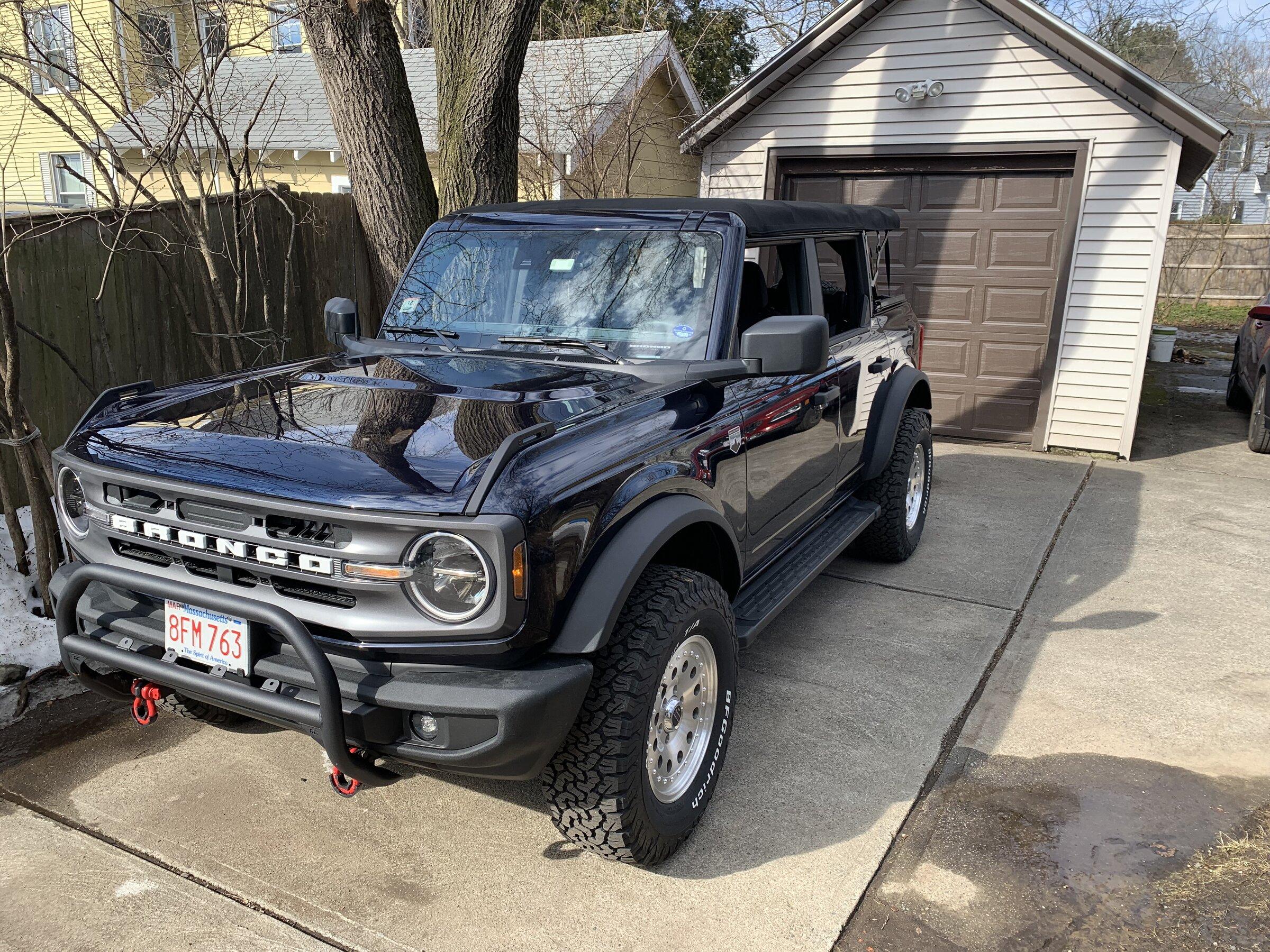

Method Racing 703's with 0 offset.
Ford Bronco What offset are you running? 20220201_153319
Ford Bronco What offset are you running? 20220121_112613

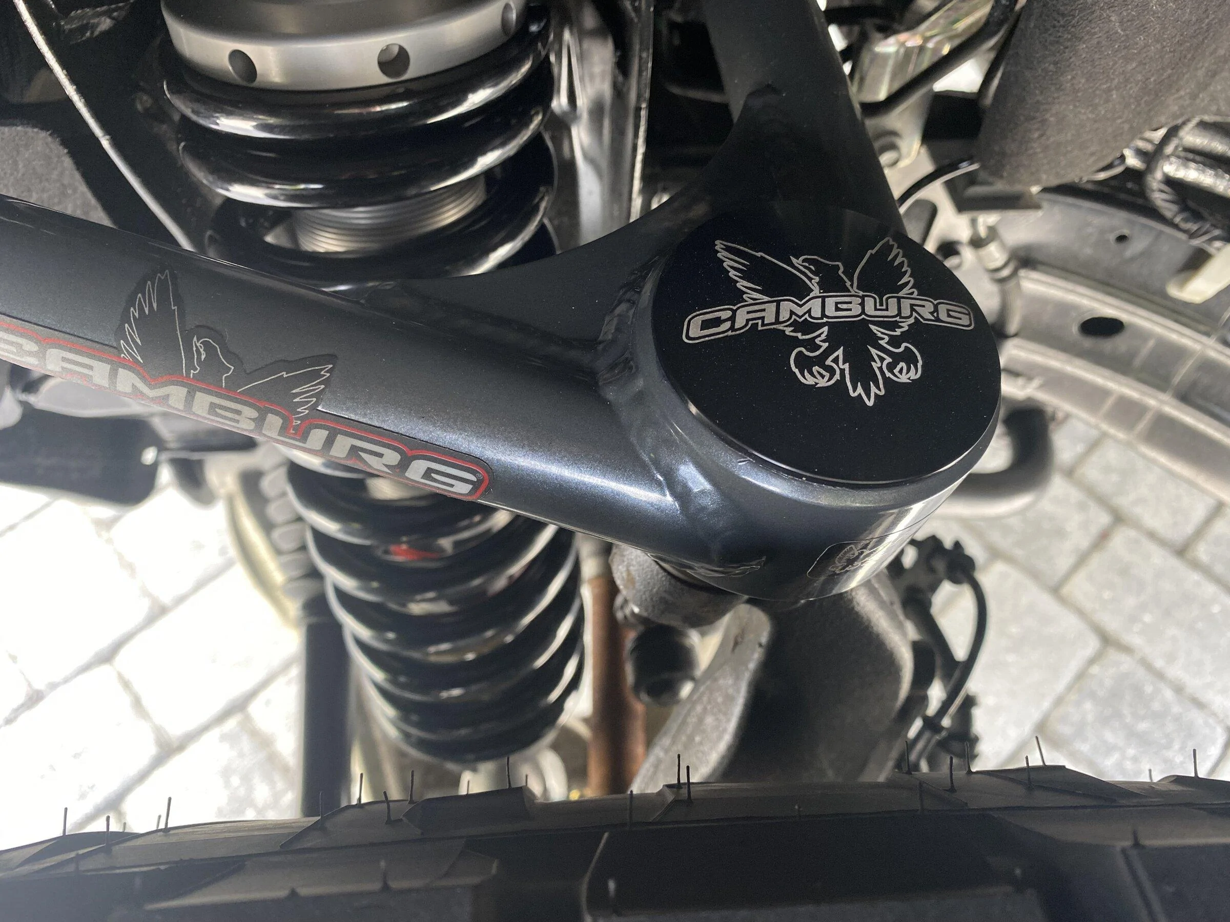

rguest3
Raymond
Jul 29, 2020
1,050
1,510
Florida and Virginia
F-350, F-450, 23 Bronco, 24 Raptor, (2) 77 Broncos

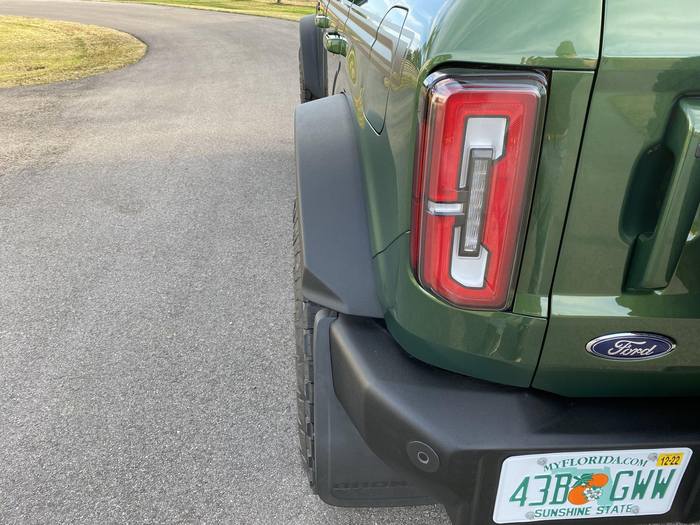

Method 705s - 18x9 and +18 offset
Toyo ATIIIs - 37x12.50x18
3" Coil-Over Lift
Ford Bronco What offset are you running? IMG_0262
Upper Control Arms have plenty of clearance with the +18 Wheels. NO rub at all.

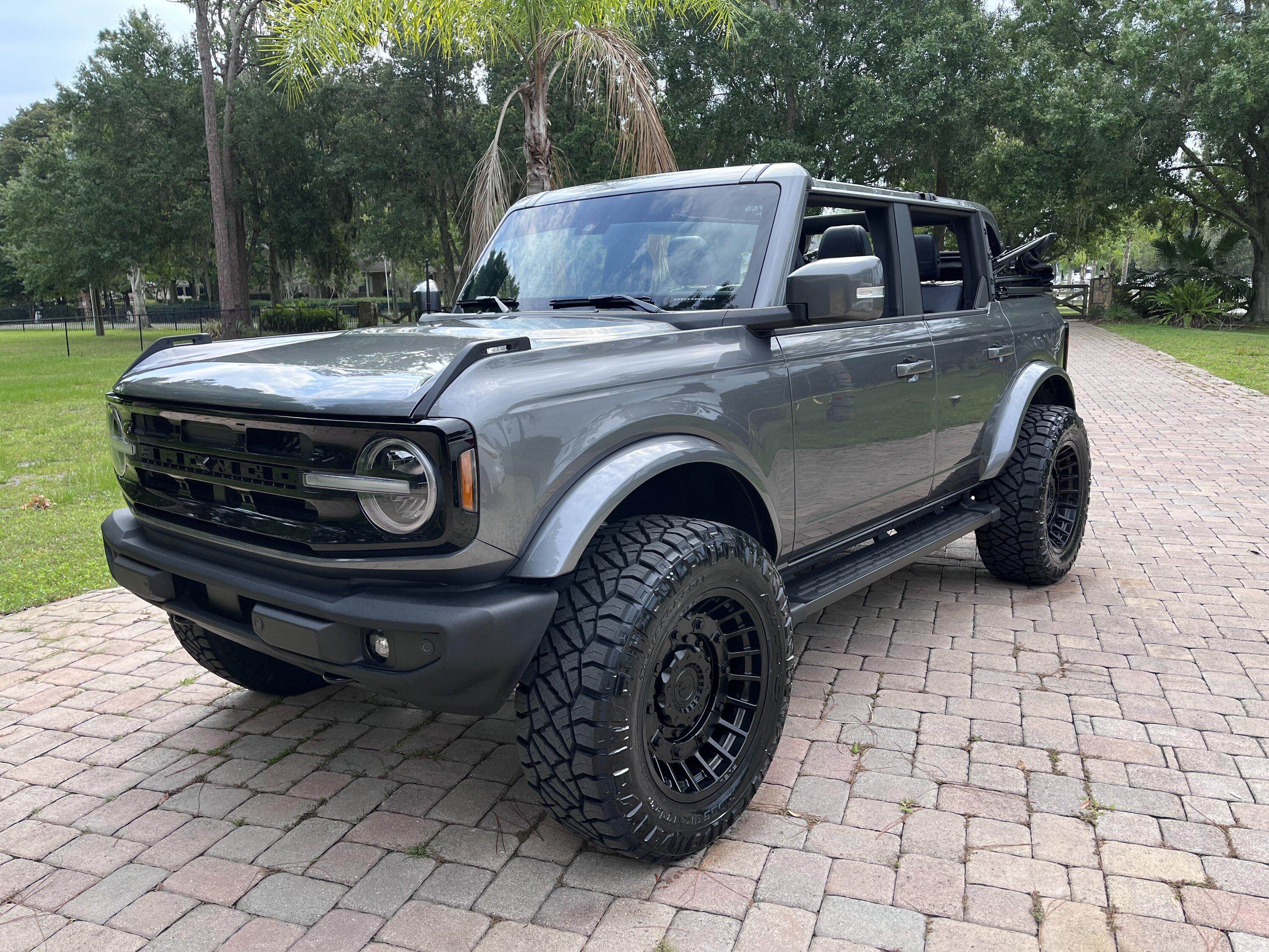

equitasforall
Mar 1, 2022
506
1,251
Out of the country until late 2025
2021 Bronco Badlands
I’m looking at fuel trophy wheels with +6 offset. Worried they may stick out to far. Bronco I have ordered is a 4 door bigbend will be adding 2 inch lift. Any thoughts??
20x9 Fuel Blitz with 35/12.50x20 Nitto Ridge Grapplers. The Blitz has a +1 offset. Bronco is a Badlands with Sasquatch and Ford Performance Flares and a leveling kit, all installed by the dealership prior to my purchase (originally spec'd out for the initial customer order before they backed out.)
Ford Bronco What offset are you running? 1647383077090

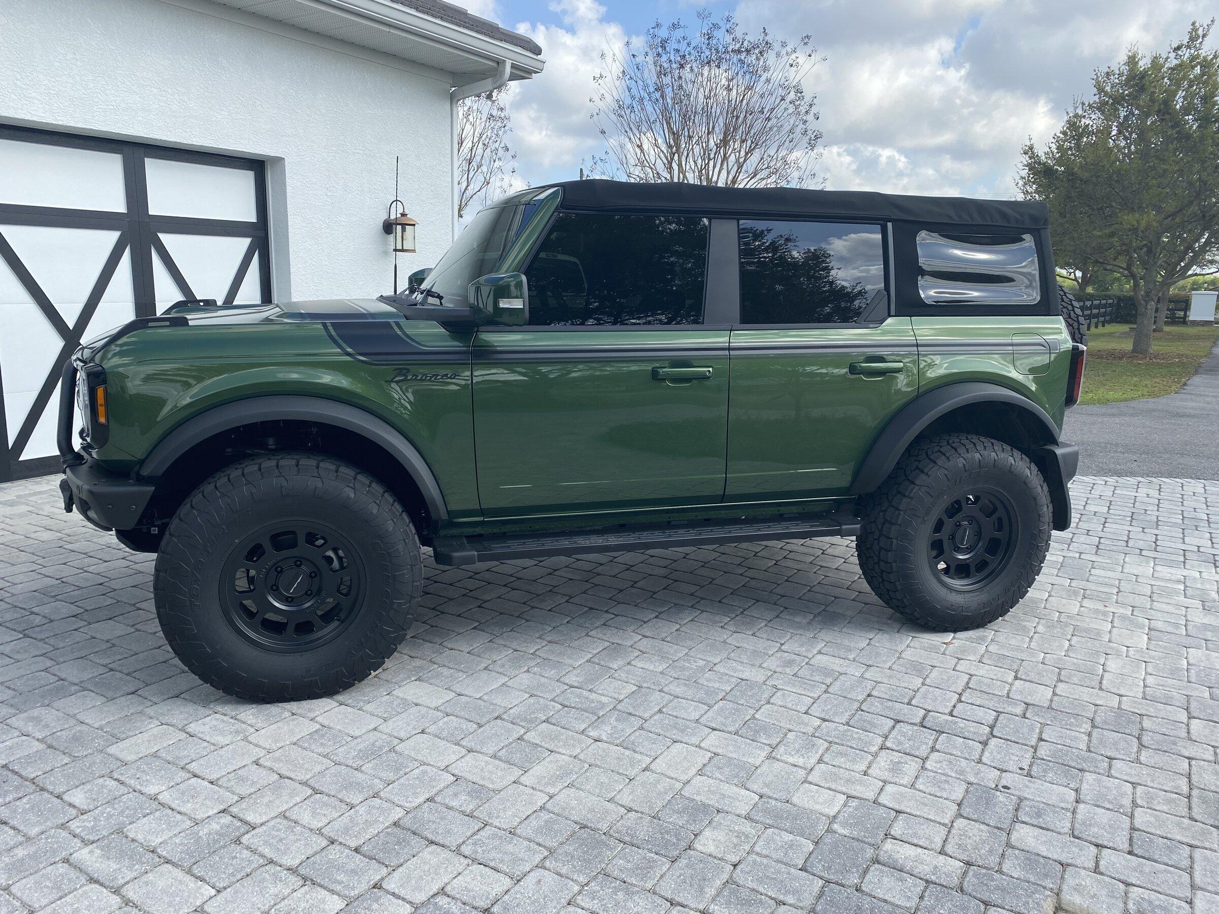

Mickey Thompson Sidebiter II wheels, 0 offset, 9" width, 17" dia., running Mickey Thompson Baja Boss MT's 35x12.50x17 tires, SAS flares.
