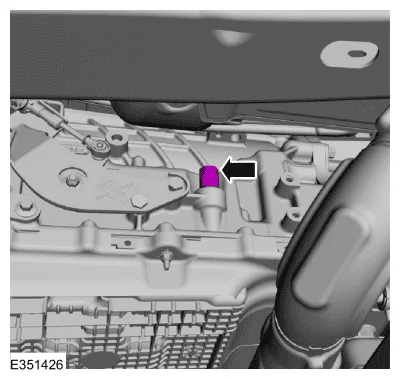

Anyone else got something that sounds like torque converter/transmission whine? Didn't notice it the last couple days but it's very noticeable today. Little bit of googling said it was semi-normal for the 10r80, didn't see anything about the 10r60 though. Haven't heard it in any other 10 spds I've driven. Does it both in and out of gear. It's very noticeable and really kind of annoying. And no, it's not the turbo noise. Not seeing anywhere to check fluid level, though did get a nice look at the unprotected plastic trans pan.

Boy that is in a pain in the ass spot and tight as hell. Guess I'll let the dealer worry about it when I get off work next week.

Check your fluid level?
