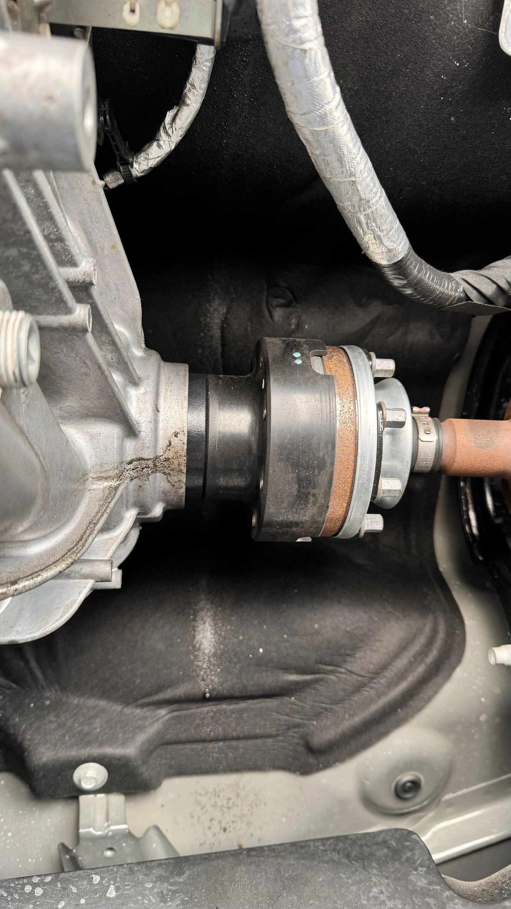

Realized I have a leak and found this thread. Found fluid splatter and drip marks.
