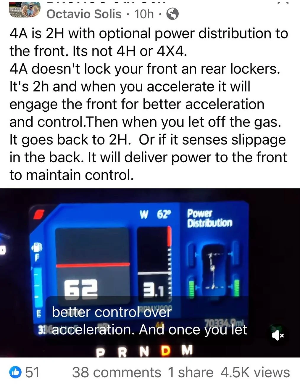

When Octavio speaks, people listen…and he says,
Ford Bronco '22 OBX 4A Binding issues... Need TSB IMG_8785

It's a complex world, and the Bronco is a complex machine. Through the miracle of modern engineering, the Bronco (well, models with 4A) is both a "part-time/4x4" machine and a "Full time AWD" vehicle, depending up user selection.

But Ford does not refer to the 4A transfer case as part time at all. The only transfer case they refer to as part time is the base transfer case without 4A. This is because with only 4H, it is designed to be part time.
The upgraded transfer case is called the Advanced 4A transfer case. Nowhere in it’s description is it listed as part time. Now while it also doesn’t technically say “full time” that is how it operates. Ford considers 4A its “full time” AWD system. If it wasn’t full time, why would they even add the clutch? Why would you need part time 4A and part time 4H?

“Customers have a choice of two four-wheel drive systems, an electronic shift-on-the-fly system, or advanced full-time 4WD system with a reassuring set-and-forget mode, designed for capability when and where customers need it.
Ford’s Advanced 4WD system is an automatic on-demand system with four settings – 2H, 4A, 4H and 4L. When set to 4A (4WD Auto), the on-demand system is fully active and constantly monitors traction conditions, sending a proportional amount of torque to the front wheels as needed.”
