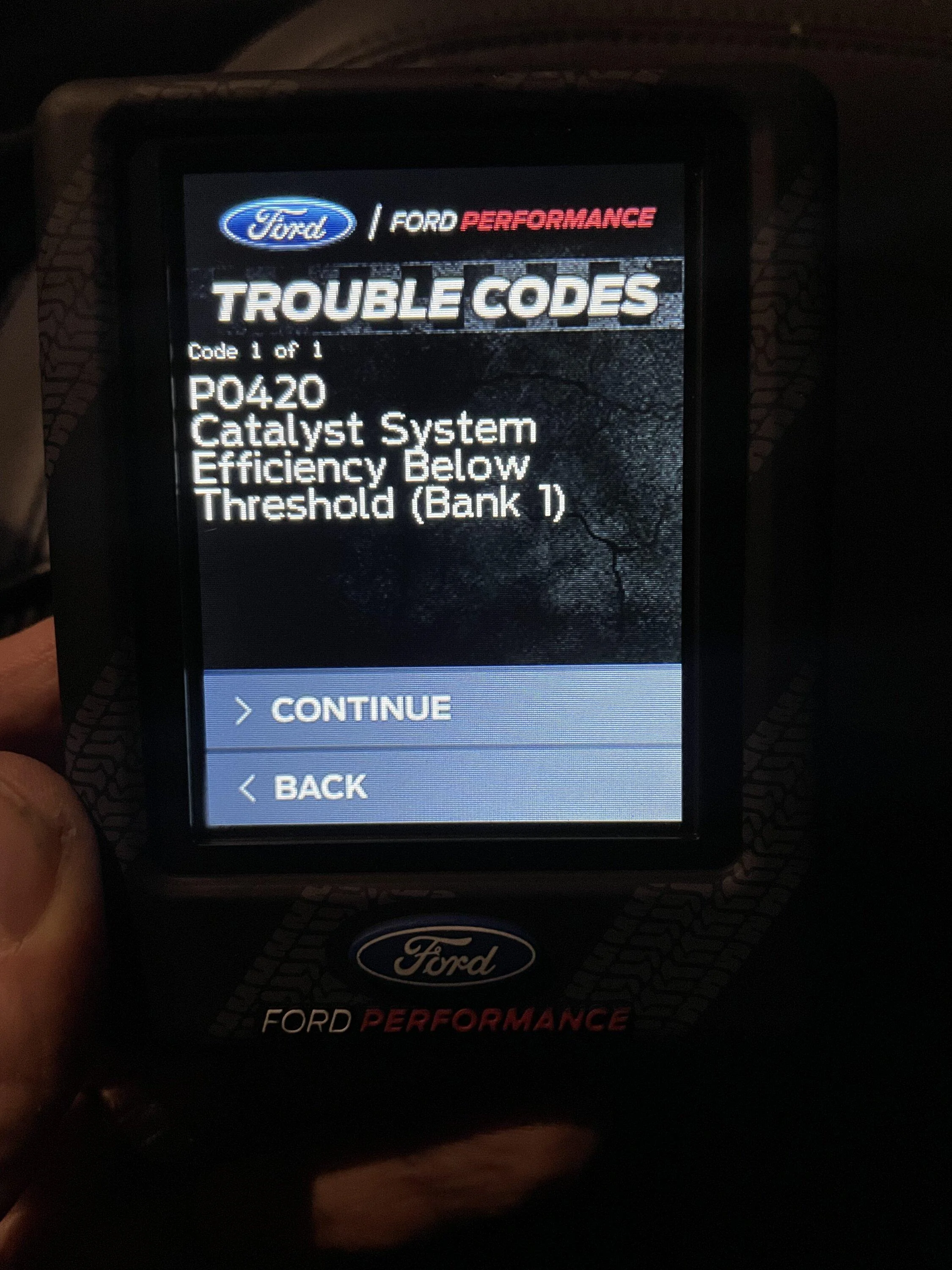

Welp, you nailed it @Ducati1098
P0420
Ford Bronco DTC P0420 - Check Engine Light for Catalytic Converter IMG_5367
I’m trying to attach some sound clips - but, I can’t seem to figure that out. It’s definitely gurgly coming out of the exhaust. I didn’t notice it from inside the cabin that night.
I have half a tank and dropped in half of large bottle of Techron. I’m gonna fill up and dump the rest in tomorrow.
But, this definitely doesn’t sound good.
P0420
Cats are 8/80 federal. Leave the code in memory and go get a free one from the dealership! P0420 can't be fixed any other way (that i will discuss publicly)
Yeah, I’m calling them in the morning. My coolant was very low the last time I had it in for service. They couldn’t pinpoint why…I sure hope these aren’t related.
