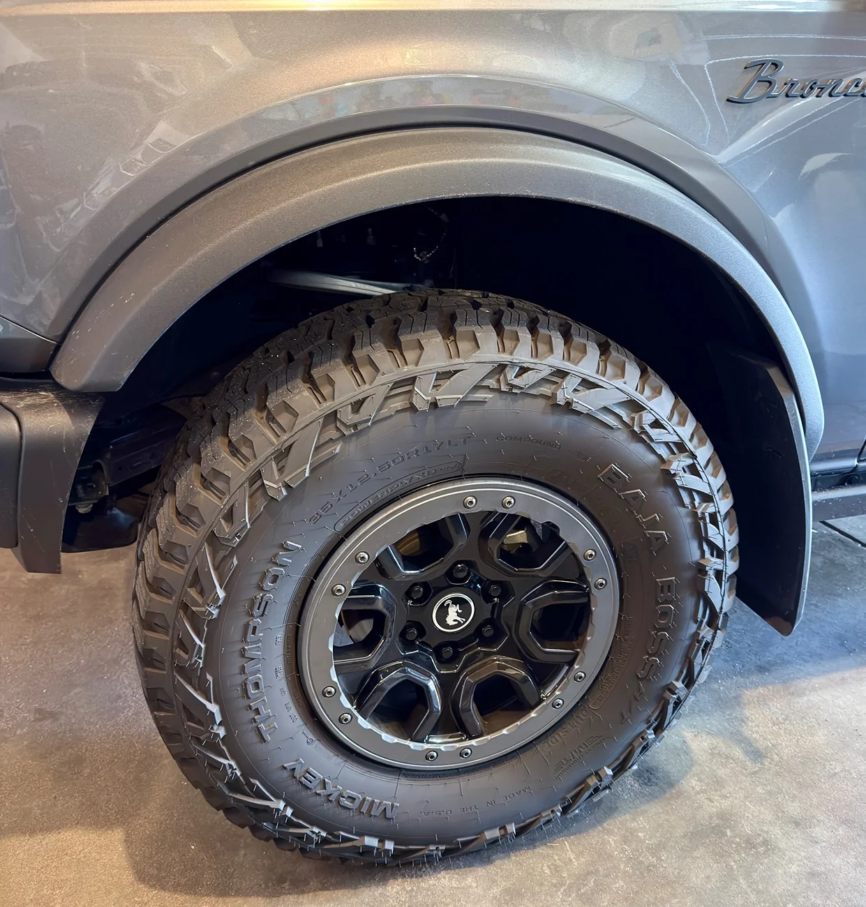

Just put D rated 35x12.5/17 Mickey Thompson Baja Boss AT's on my 2025 Sasquatch- love them! Tread width is about 1.25" wider than the stock Territory RT's, and they ride great at 32 psi- very quiet on road. Average MPG went from about 19 to 17 with the Procal 91 2.7L tune. Have yet to wheel with them, but they've got great reviews!
