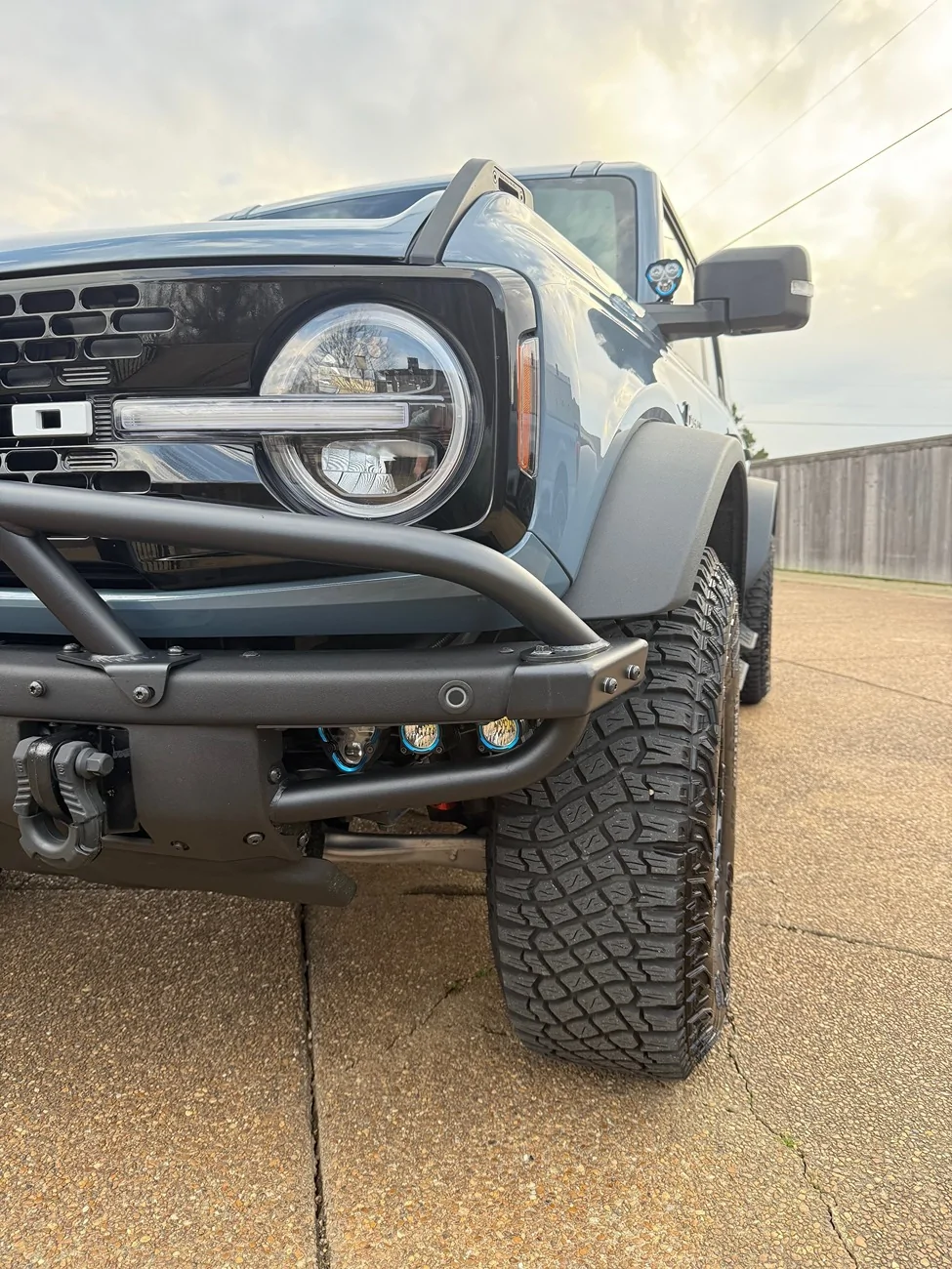

Just put D rated 35x12.5/17 Mickey Thompson Baja Boss AT's on my 2025 Sasquatch- love them! Tread width is about 1.25" wider than the stock Territory RT's, and they ride great at 32 psi- very quiet on road. Average MPG went from about 19 to 17 with the Procal 91 2.7L tune. Have yet to wheel with them, but they've got great reviews!
Do you have any issues with rubbing with them being a little wider? According to manufacturer information they should be very close. GY - 12.4" (315mm) / MT - 12.8, but that is always off some....
I have the MT Baja Boss ATs on my F350 and really like them. Went plus 1 size and dropped 1.5 mpgs on it.
I keep leaning to the MT Baja Boss ATs, will probably go this way. (90%)
I was looking at putting them on the Ford Performance - Method 703 Wheels to try to offset the additional tire weight. The new wheels would weigh about 26-27 lbs compared to the stock wheel being 35lbs. This should help with the added tire weight and mpgs. I know it will go down, always does with heavier tires. The offset on the new wheels is +35 compared to +30 on stock wheels. So it will be a little closer in (.2"). I am OK with this as long as it does not rub. I do not want the wheels to stick out farther.
