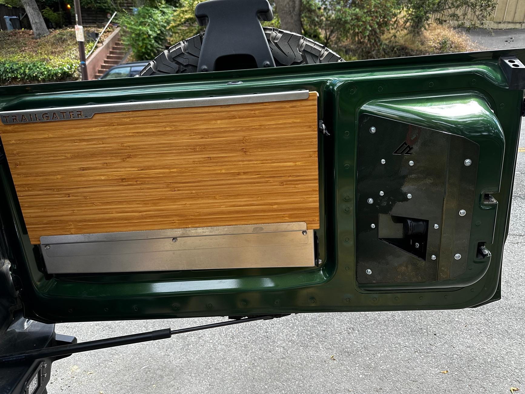

I also went with the AAL tailgate setup. I wanted something that didn’t take up any room. And I wouldn’t forget! Heh. Also had it powder coated to (mostly) match Eruption Green. Used it on Tuesday to air up. Worked as quickly as my cheapo Amazon compressor. Without the hassle of moving it around and connecting to the battery. (1st world problems, yes I realize. It was a vanity project I’ll admit. ) plus I can’t leave anything visible in the rig as I live in a city where cars are routinely broken into. And I don’t have a garage.

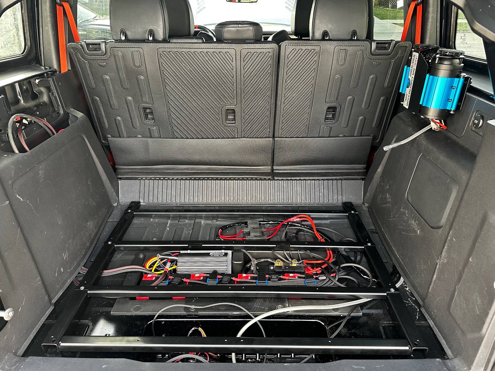

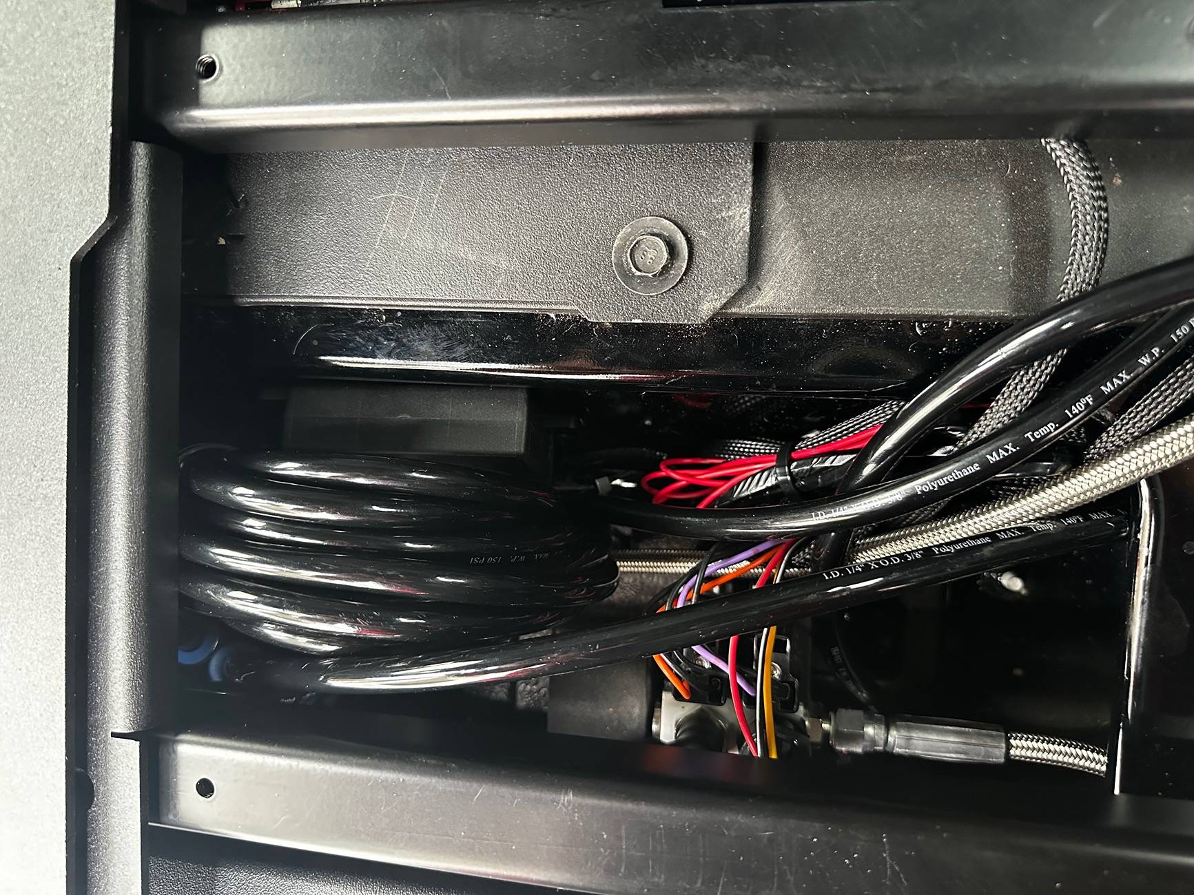

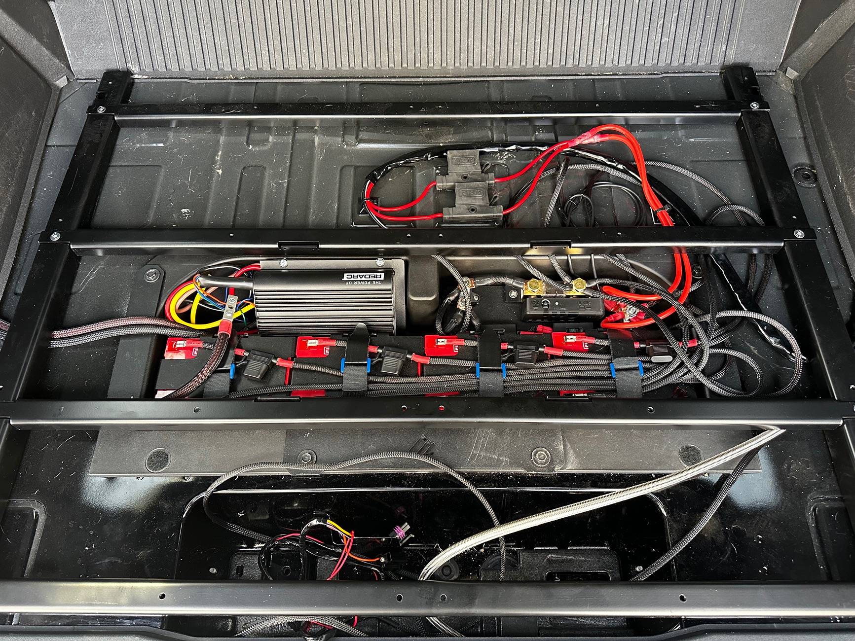

I did the ARB dual compressor with the AAL mount. Wired to a dual battery system under the floor and ran 4 air lines through a manifold behind the panels to each wheel well.

I really like your air setup and building my own. I've got my dual ARB mounted under the back where your battery setup is.
In the front position you mounted your air chucks, have you had any issues with rubbing? Fully turned over it looks like the front could get that close but since the bracket is there maybe it'll never get that close.
In the rear position, do you find it hard at all to make the connection or disconnect with being aimed down like that? From tapping on the fender liner it feels like you could also mount it at a 90 degree angle as well as straight down.
Thanks a bunch for the feedback and awesome setup you have!
There’s no issue with rubbing in the front as I’ve mounted it where the crash bar would be. The crash bar isn’t included on the Raptor or any Sasquatch bronco. The rear I mounted downwards as I didn’t want it visible and I wanted it in a spot that I could be absolutely sure it wouldn’t be rubbed by the tire. I haven’t had any issues hooking up to it. It’s very easy. I just finished doing Rim Rocker and am in Moab and it all held up beautifully. Being able to sit and relax in the car and have the ARB pressure control kit alert me when it’s done is awesome. I can take some more pics showing the routing underneath the car and through the frame once I’m back from this trip.
