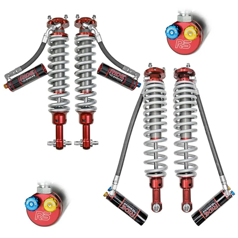

What you described is exactly what we designed our shocks for. Smooth and comfortable on the street yet capable and controlled off-road. We have 2 front & rear coilover options depending on how built up your Bronco is and come standard with high and low speed compression adjusters. Take a look here and reach out if you have any specific questions, happy to help.
Ford Bronco The Ultimate "Travel" Guide - Bronco Suspension Data Compilation ride-shocks-package-ford-bronco

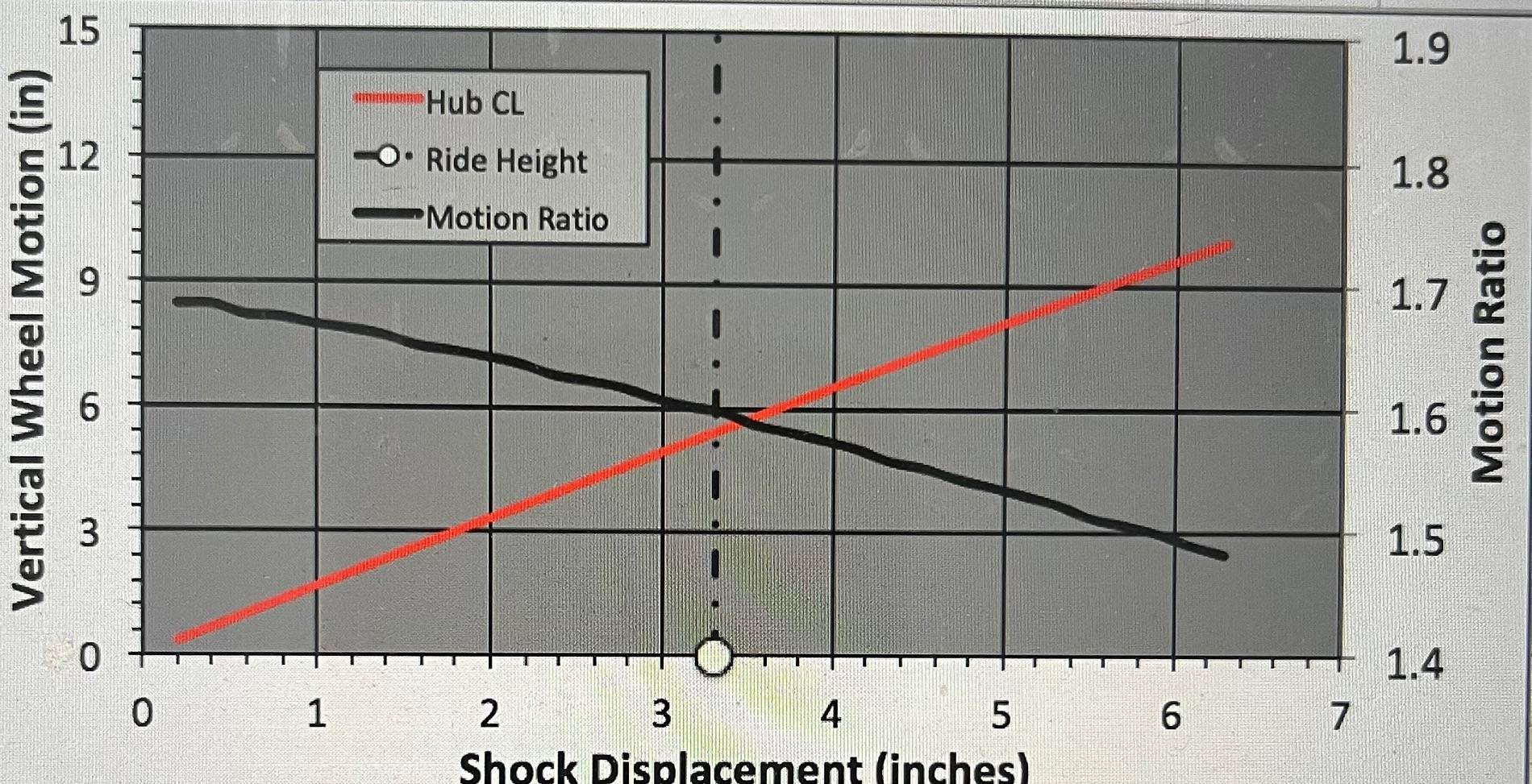

There is no reported “wheel travel” by Bilstein, but we know the average wheel travel ratio for the front to be 1.62 based on the collective data. (6.18”
for those interested. Here is the exact motion ratio for the SAS bilsteins. Notice it is non-linear and drops of quickly during jounce. Biggest bang for your buck at full extension, nearly 1.7. A shock with different lengths than SAS will have a slightly different motion ratio. Most of the aftermarket shocks that maximize full extension near 24.3” will have greater motion ratios in rebound. Purely due to 3D kinematics.

Thank you for the ratio explanation and calling out the threshold of wheel travel being the straight up and down path.
I’ve always just thought of articulation as being the same as wheel travel, now the chart makes more sense. Thanks again.
