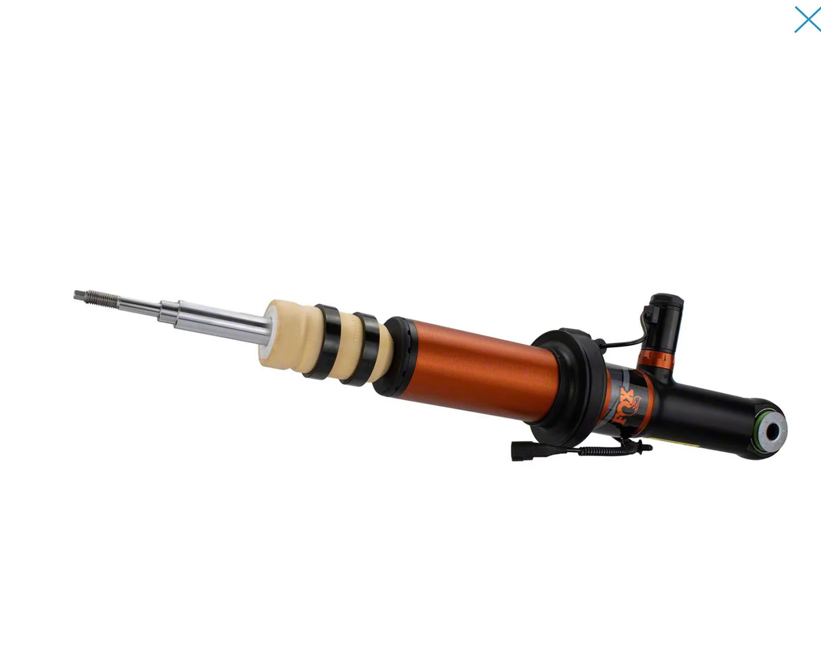

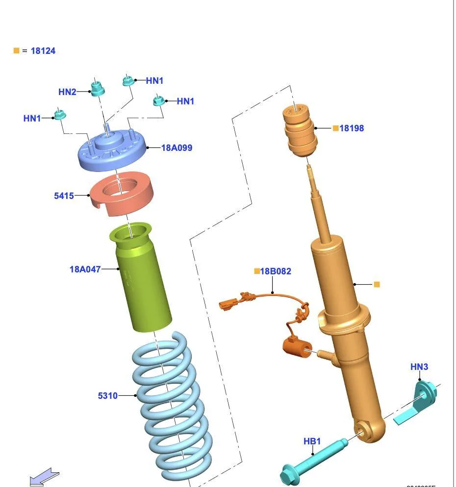

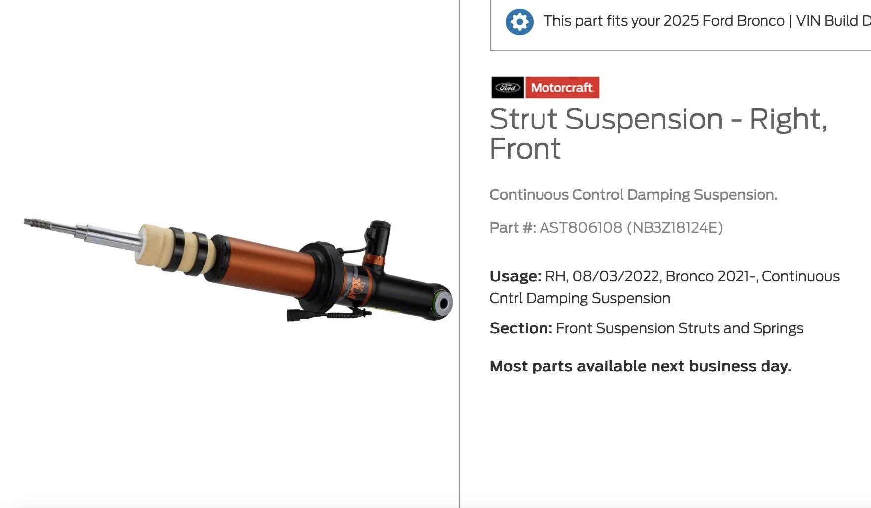

Reposting here as well. Found these in the ford parts catalog. Possible Interesting suspension update coming for a version of the bronco. Live dampening Fox suspension.
Ford Bronco The Ultimate "Travel" Guide - Bronco Suspension Data Compilation Screenshot 2025-03-08 at 9.58.07 AM
Ford Bronco The Ultimate "Travel" Guide - Bronco Suspension Data Compilation Screenshot 2025-03-08 at 9.57.37 AM
Ford Bronco The Ultimate "Travel" Guide - Bronco Suspension Data Compilation Screenshot 2025-03-08 at 9.57.57 AM

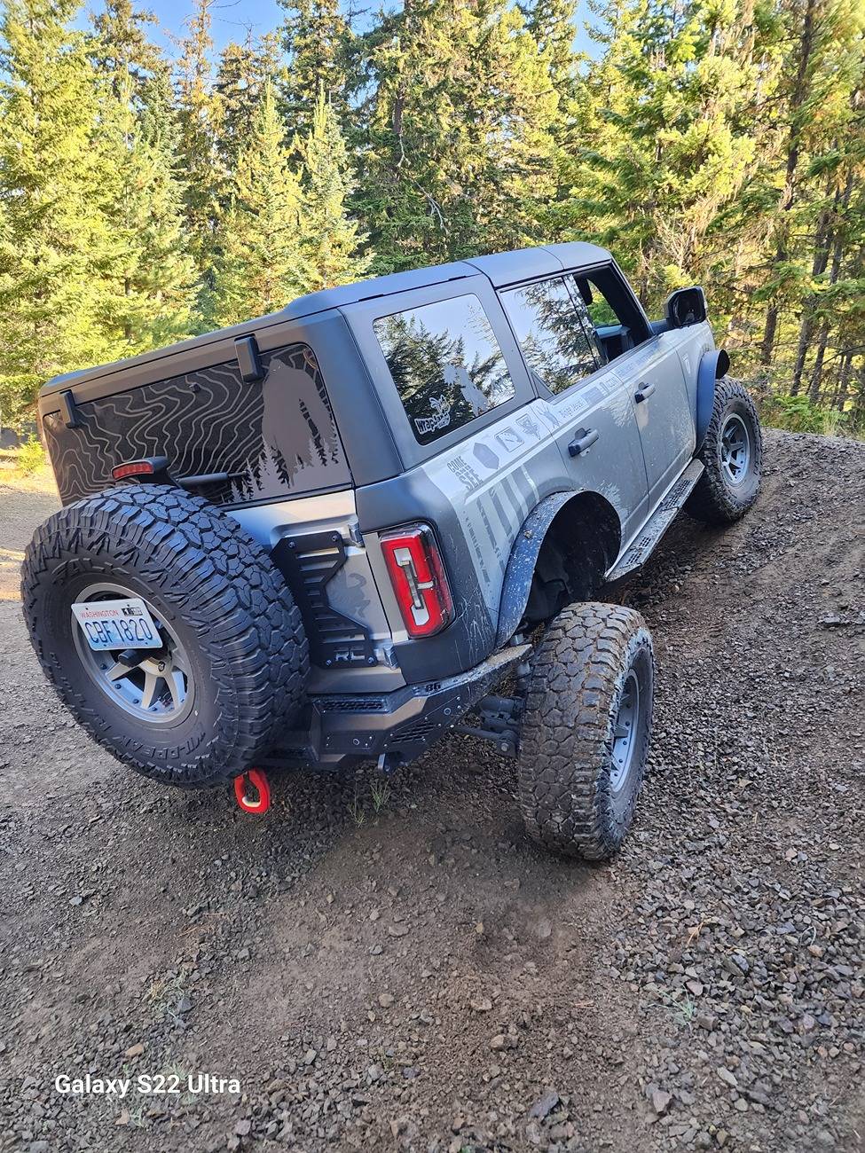

Different angles, same spot. Didn't move Bronco. I found a ramp in nature. Icon.
Do you have a front sway bar here?
Always interesting seeing super flexy rear axles while the front is not close to max compression.

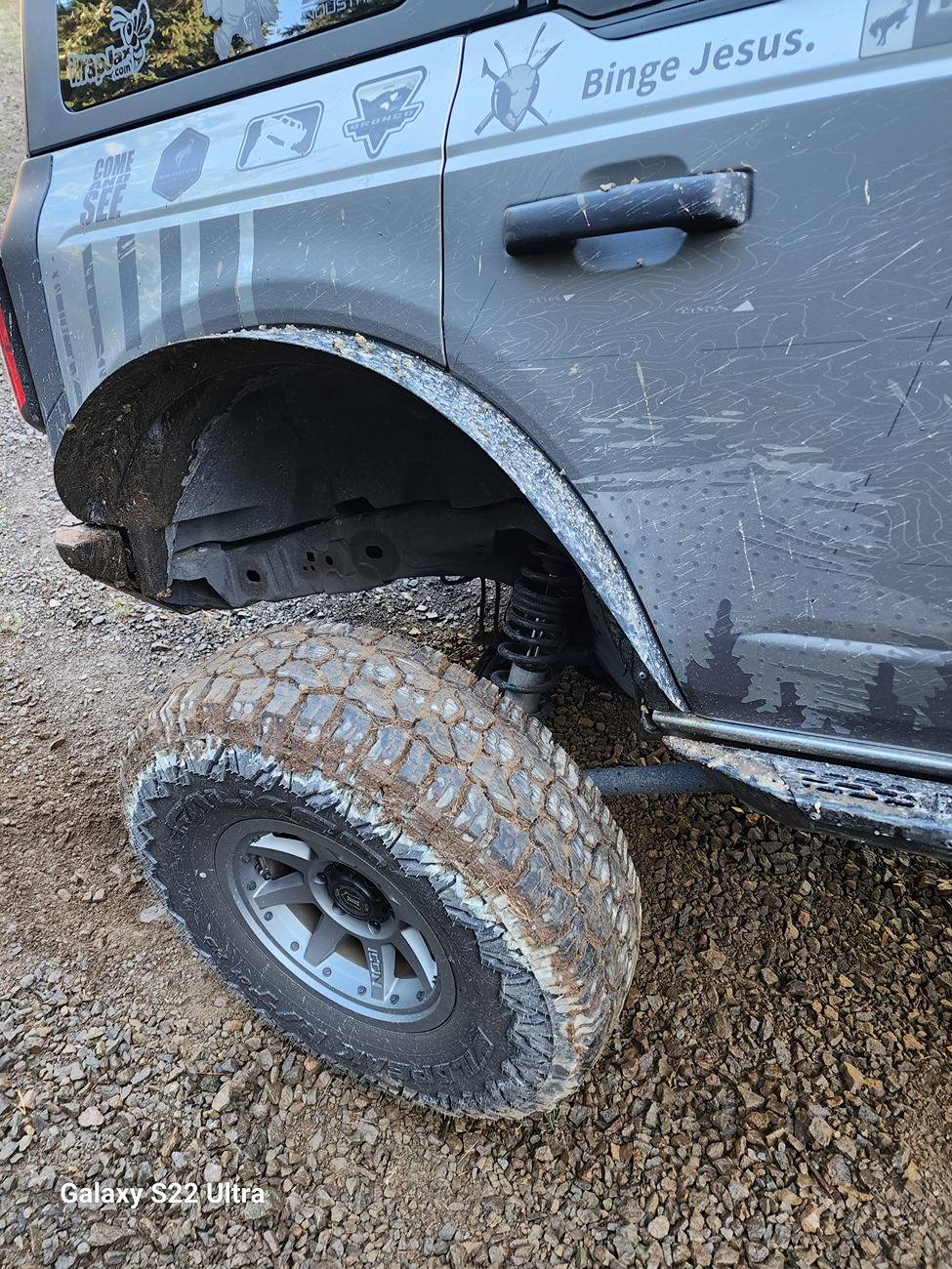

iamcris
Cristian
Dec 30, 2021
227
333
Lakewood, WA
21 Bronco Badlands
Front yes, disconnected, no.
Rear also yes, factory.
Here's another picture of me having fun but in a more compressed scenario. Rear tire is touching....close but touching.
