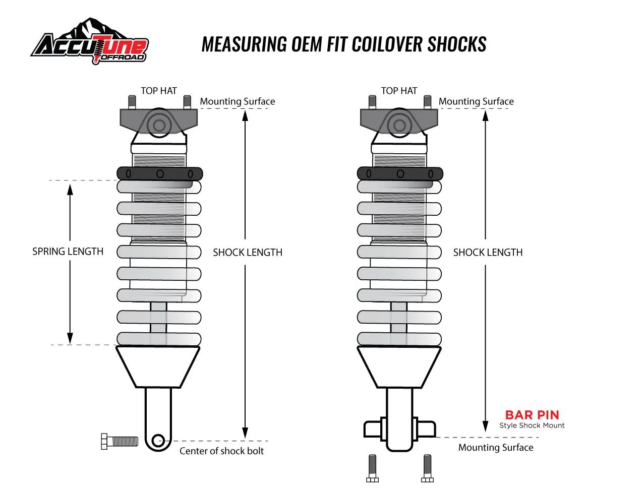

@AccuTune Offroad measured mount surface to the top surface of the mount. I would have done mounting surface to mounting surface, but the net result is the same travel information. The numbers I have here should be mount to mount, or eye to eye. We report the same travel, but overall some of his lengths are longer. Travel in my view is the key metric.

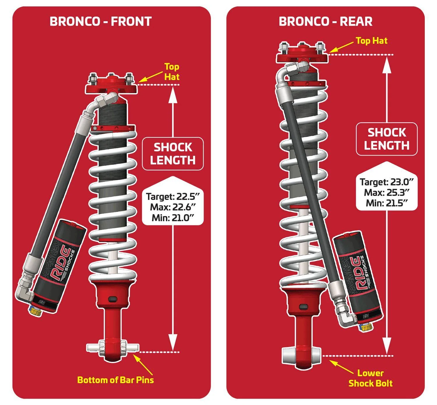

Happy to dive in deeper on Ride Shocks when needed, there is much more to these shocks than total travel.
The Ride shock numbers come directly from you in a thread, and I believe the ICON numbers do too, or at least in a thread you added information to.
Totally, again my goal is travel, you could easily look at this data and say what could provide, lift, ride comfort and high speed performance and come to the conclusion that the Ride, Fox, and King suspension is the best choice. If you want long travel, I think ICON and Falcon float to the top for that application.
We do measure from mounting surface to mounting surface. This has been an industry standard for quite some time, so nothing unique to us. Here is a diagram to be more specific for bar pin mount and top hat mounts:

*These measurements, are going from the top of the top hat to center of lower bolt, or to mounting surface of bar pin.
Thanks for the correction, I miss understood this from an earlier post and thought you were measuring from the top most point of the top hat, not the mounting surface. I think that is the measurement represented in the table for most.
I can’t explain the ~0.85in difference on the Fox measurement between what they have online and the information in the old thread. The travel dimension is the same so It seems like a minor shift in measuring point. In my view a minor detail.

Unfortunately at some point Fox decided to change their measurements and how they are displayed on their site. I've lost track of which shocks are using this measuring method vs which are using eye to eye measurements (disregarding the top hat). This also proves that shock measurements are not consistent across the board. King and Fox also have different methods of measuring stem top shocks.
We've tried to be as clear as possible with Ride Shocks setup guide to ensure customers have the ideal setup:
Ford Bronco The Ultimate "Travel" Guide - Bronco Suspension Data Compilation bronco-front-rear-shock-length
Fox bump stop is about 1.50", one we use is 1.70" tall
Bump stop we use is 909 LB/IN, I don't know what Fox bump stop rate is.
