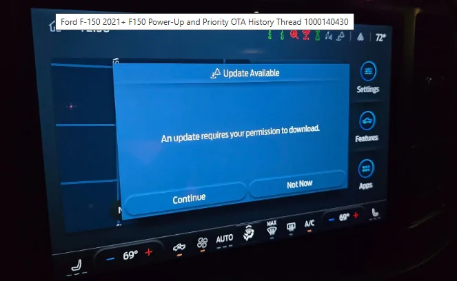

Having auto-updates on or off makes no difference in terms of how often you will get updates. If you have updates set to off and they send you one, you will get a notification asking for permission to install it like below. The only way to get updates without waiting for the OTA process is by doing them yourself with FDRS.
I keep auto-updates off to avoid having them wipe my tune. When I do get one, if it is for any module other than the PCM, I let it install. If it is a PCM update, I contact my tuner (Livernois) and get an updated tune from them before I let it install so I don't have to drive it without the tune. I know that can be seen as a little extra, but that's what I do.
Thx. I guess I should check the dash screen! I was only looking at the phone app, duh.

In the case of the touchscreen, you won't have to check it. It will pop up every time you start the vehicle. This will happen for 14 days or 30 days (depending on the type of update it is) until you either allow it to install or the OTA trigger expires on Ford's side.
