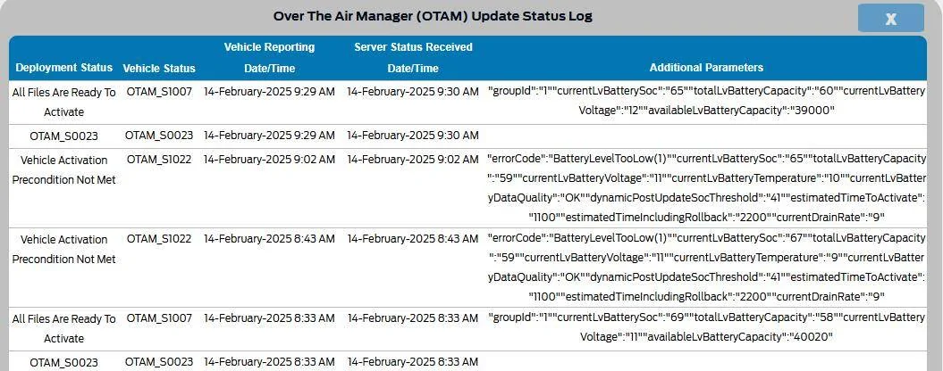

I have no idea what they meant by secondary battery lol
But it looks like the issue was indeed because of the battery state of charge:
@Severum17 To add to what @Ducati1098 said: The issue is the state of the 12v battery. Last time the OTA trigger pinged your truck, the SoC was at 63% which is below threshold, capacity at 60 of 70 which is fine, and voltage at 11v which is also below the threshold. Your truck only has 1,800 miles in the 6 months you've owned it, so the battery being under the required specs is of no surprise. This particular update will require the vehicle to be locked and go into inhibit mode while it installs....it is not one of the ones that installs while the truck is on.
Ford Bronco Software updates 1739549901662-kl
Personally, I am not a fan of the 1am updates schedule. All that does it let the vehicle sit for hours while the LVB loses juice waiting for the update schedule to kick in. I would recommend hooking up your 12v battery to a charger (if you have one) until the battery is fully charged. Then start the truck, check for updates and install it manually right then and there. It says 38 minutes inhibited, but it will really take maybe half that long to install.
If you don't have a battery charger, take it for a 20-30 minute drive and leave the a/c fan speed on at least 5 the entire time (this forces the battery charging system to charge the LVB regardless of the battery's state of charge) and then try to install it manually when you park after you've let the alternator charge the battery back up.
Drove it around and now its able to update. Too much computer garbage on these new cars. Thanks for the help and info.
Thats great info and pretty much what I figured to do. We are retired now and dont drive all that much anymore. Love this Bronco but not a fan of many of the computer functions it does. ASS is the worst. I shut it off. I got spoiled working for the GM dealer 45 years, and always had resources and techs for advice. On my own now. First new car in a very long time.

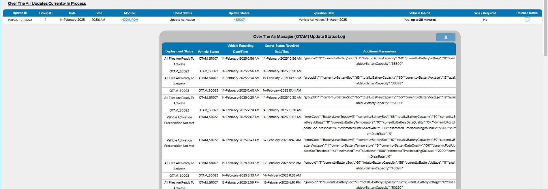

I've had my 2024 since September and have yet to see an update or any update history. I have a trickle charge for the RV that I'll grab this weekend but don't know if it has a setting for ACM. Here's my vin if someone that has access can pull the info I would appreciate it. I would like to know if I have any updates out there. Modem is on and wifi connected to my house.
1FMDE8BH9RLA91328
thanks
rugedraw
Javier
Jan 9, 2024
443
379
Miami, FL
2021 Ford F150 Platinum FX4 EB/2023 Bronco Sport Badlands/1991 Mustang 5.0 coupe
1FMDE8BH9RLA91328
thanks
Connectivity in your truck is fine. Your truck being a 2024 with a build date of 5 months ago was built with most of the software the previous model years needed via OTA. Your truck is only showing 4 pending module updates: ACM, APIM and the door modules.....that's it. You aren't getting updates because there isn't much to be updated on your truck. The OTA this thread is about is the one that updates the door modules. Were you to get this one, you would only have two modules left to be fully up to date.

Thanks for checking. Any way to force the updates?
rugedraw
Javier
Jan 9, 2024
443
379
Miami, FL
No way to force an OTA to be sent to your vehicle by us mere mortals. The only way to install updates is with FDRS which would take a financial investment in the tools needed to do so. In your case, it is not worth spending the money.
