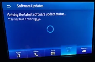

I took my '23 Base, which is driven sparingly, to the dealer for an appointment last Wednesday. The issues were that the auto stop/start was not functioning, and when going to software updates on the screen I get the following message which never resolves - it just stays that way until I back out of the screen. I left very explicit notes detailing both issues with the vehicle.
With regard to the auto stop/start, I figured it was probably just a case of a low battery charge, or failing battery.
When I went to pick up the Bronco this afternoon, I was told that the battery charge was low, it was recharged over the weekend, and all was well.... I pulled out of the service bay, stopped, and checked the software update screen and sure enough, it was doing the same thing as before, as depicted in the attached image. The service advisor told me to come home and try again hooked up to wi-fi, which I did, and still get the same thing. I have been scheduled for another service appointment next week. Ugh.
Has anyone had experience seeing this screen that will not resolve and if so, what was the ultimate fix?

May be worth pulling the battery cable for a few minutes to let everything clear and reboot, see if that changes anything.
This is 100% the fix for the screen getting hung up on the "checking for updates" screen. Disconnect the negative battery cable for 20 minutes, reconnect it and check again and it will eventually say "up to date" or reflect the info of the last OTA the vehicle received.
With FORScan, you can try rebooting the GWM and TCU, but even pulling the fuses for these modules directly has shown to not resolve the issue. A 20 minute battery pull is the more sure-fire way to fix it.

Appreciate the comments and moral support.
So here's an update.
I called Ford customer support today and asked to speak to someone regarding my hunch that the software is not updating due to the screen getting hung up in settings/software updates.
I was connected with a very nice young lady in technical support. I explained the issue, and also told her that auto stop/start was not working, and that the vehicle had just left the shop for these issues yesterday afternoon.
She was able to look at my vehicle's information online and relay to me that my last OTA software update was in December. Since that time, a new update has attempted to load twice unsuccessfully. She was also able to tell me that the state of charge of my battery at the time of our conversation was 75% (it was 100% yesterday when I left the dealership - it had just been removed from the trickle charger)....
Most importantly, she informed me that the software will not update if the state of battery charge is less than 90%.
So, five days in the shop, scheduled to return next week, same issues with no resolution or information provided by dealership, and some digging on my part with the help of Ford customer support.
The very first time that the auto stop/start failed to operate, my immediate reaction was "the battery is dying". While the issue could indeed lie elsewhere, my bet is still on the battery.

Only updates that require the vehicle to be parked can fail due to battery issues. Send me the VIN and I can check. The truck getting stuck on that screen is an indicator the GWM is hung up in a funky state and that can cause issues if another OTA gets sent to you in terms of it being able to install. I still recommend you pull the negative battery cable as suggested.

Got your message. OTA dashboard is below. TCU update 10.1.1 is in your queue right now for the third time. Both times it failed previously, it failed because your truck did not ping the server back to accept the OTA trigger, and so far, it is not pinging the server back for this try either since it was sent to you 3 days ago.
This could very well be due to your GWM being hung up in a funky state, and the fact that when you check for updates, it cannot get past that screen you posted indicates that a battery pull is indeed needed to reset everything. While I cannot guarantee that the battery pull will 100% work to get this update to go through, I can tell you this behavior is not normal and it won't hurt to try.
The TCU is one of several modules which gets updated while the vehicle is turned on and running, so this is not a battery issue. When an OTA fails due to low SoC, this screen below will clearly tell you that is the reason.
