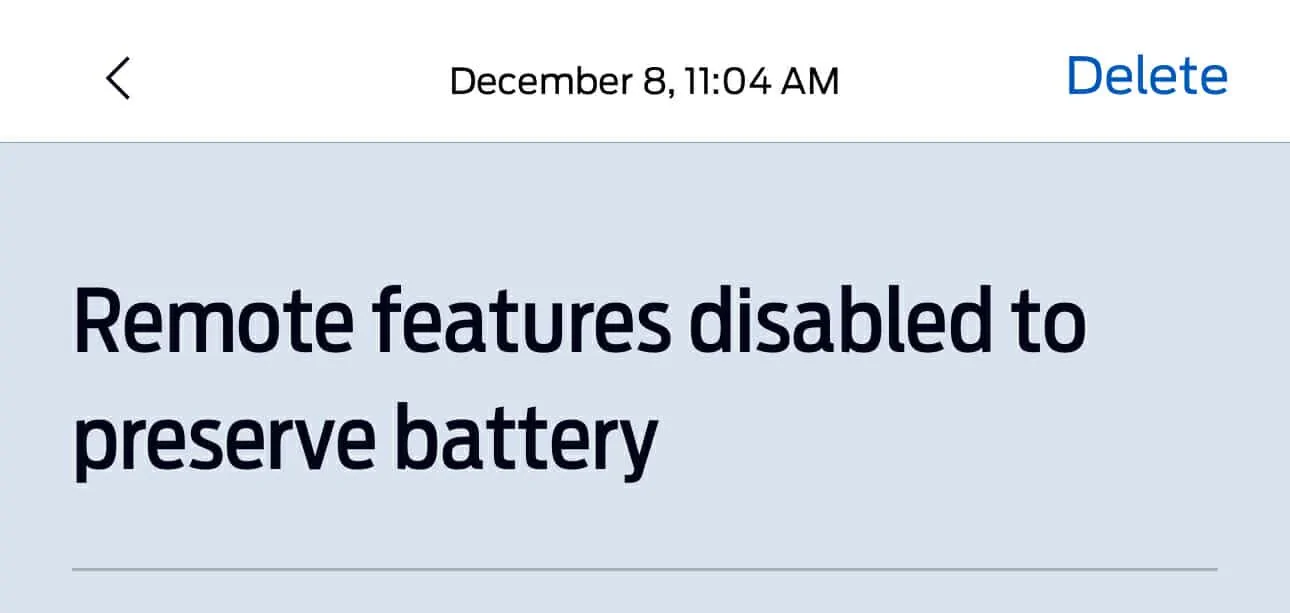

Just did a short drive (20 min each way) to the grocery store, parked - and the app sends me this.

Last couple of days - no issues or warnings on battery. What about you guys? Still having problems?

I had the dealer check my battery and it was bad. They replaced it and after $360, everything should be back to normal. I called the Ford customer support line and they said that the Bronco saved message is normal, but I’ve never seen it before this latest update, so who knows what that that update was for

I put my bronco on a charger for a couple of nights. Then driving it daily I have not had any issues any more. I will run a test and let the bronco sit for 3 days, just to see if I can replicate the issue. Mine is more complicated because I do have the genesis dual battery package....but I can force the system into a single battery operation mode with some quick disconnects I installed on both batteries. So no idea now. I will keep you guys informed of my test results. I will likely start tonight with not driving the bronco until friday. I should get the remote start disable text in 1 or 2 days after not driving...that seems to be normal from my experience in the past. That message cues me into the fact the car has gone into battery save mode.
