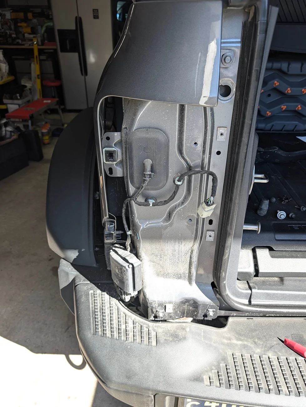

Thanks, that is way more info that I had any idea about. I would agree with you as this happens this time of year. I will try exactly that. Again great info and thanks!
for reference ( the small box you see)
Ford Bronco Sigh - I Know This Dance PXL_20241005_191435600

When I got home tonight I grabbed my fairly low power electric leaf blower and just blew it up and around anywhere I could inside and near the wheel well and bumper. The garage is above freezing tonight but I think I will put my little oil space heater out there to help it dry… 🤷

Some really good advice! My stripped-down Big Bend doesn't have those sensors, but there are so many "bits and bobs" that are subject to the same problem. In addition to flushing and keeping clean, I plan on using DeOxit to clean the pins on the harness connectors and re-seat.

between that and the picture somebody posted, it makes a good bit more sense now, i wasn't 100% sure on it, i just now that when my tail lights are dirty, that system goes absolutely beserk.

Do you know what piece the dealer replaced and the wiring harness to it. Just trying to brainstorm. Is this the plug behind the rear wheel and bumper that gets absolutely sprayed from the road? Do you drive on salted roads?
I will need to dig out the paperwork for repairs. But I drive on nothing but salty and/or briney roads up here in the winter. The weather has been bitterly clod and then warm again and then bitterly cold and warm etc. recently so the roads are just covered in it.

I would have recommended water to flush the connections and sensor. Not sure what the leaf blower would have accomplished.
If you have the time and are trouble-shooting, then go ahead and disassemble the trim/body panels.

If you have self-serve car wash (type with the wand), then I would go that route. You can see the picture that shows the BLIS sensor for reference that @jsoa posted. Flush that area by angling the wand to direct the spray. When you get home from the bath, go ahead and dry the area with your leaf blower if it concerns you about excess water lingering.
Edit: I hate to state the obvious, but the reference picture shows the driver's side. You do know there is a sensor in the same location on the passenger side? You'll want to flush both sides.

I went to a self washer after work tonight. On the drive over the warnings were doing the on and off bongs every other second. From working to fault to working to fault etc. I sprayed the heck out of wherever I could fit the nozzle. And the error just stayed solid on afterwards. Ah well at least the drives this week won’t being a bonging session of annoying.

Keep us updated with what you find out at the dealer. If the dealer can't get you scheduled soon and you have the time, it would be worthwhile to go ahead and remove the trim/body panels to see what is happening back there. At the very least, it will give you an opportunity to clean back there and reseat the connections.
