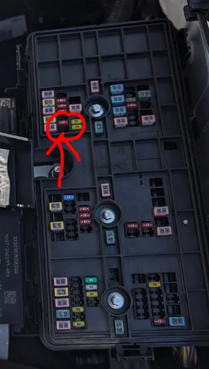

start simple and check this fuse
Ford Bronco Sigh - I Know This Dance s-l1200~2
