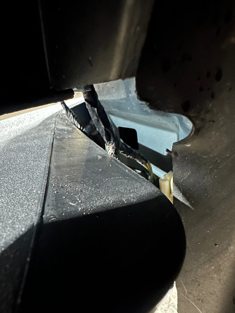

I went to a self washer after work tonight. On the drive over the warnings were doing the on and off bongs every other second. From working to fault to working to fault etc. I sprayed the heck out of wherever I could fit the nozzle. And the error just stayed solid on afterwards. Ah well at least the drives this week won’t being a bonging session of annoying.
Well that was good as now you have maybe a better idea of where the fault lies. Spraying water directly in that area maybe showed a cause and effect.

hmmm, not sure i can blame that on my usual suspect (rodents)!
No. It looks like it came out of its holder and rubbed through on the bumper.
was that harness on that side previously replaced under warranty?

Well it’s time for my near annual repair. This is my 5th winter and 3rd time with this same failure. But no warranty to cover it now. (Passenger side)
The wire harness often chafes in the area between the bottom of the body below the tail light and the top of the bumper. We have seen that several times at work. The harness just needs to be repaired and protected with some harness sleeve.

OP if they won't do,anything should be an easy fix. So this is root cause correct?
