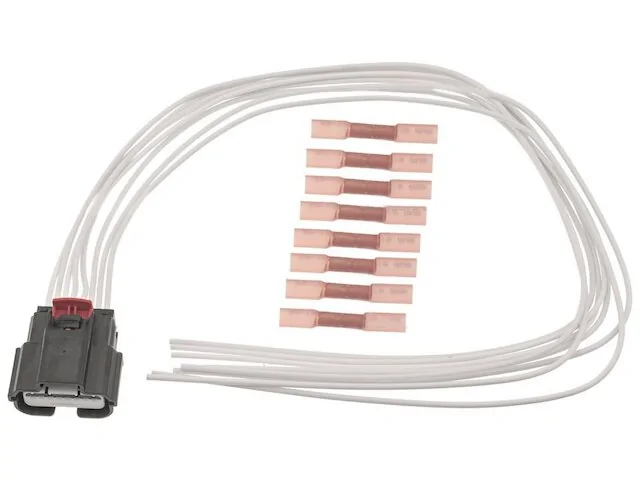

So when spring hits in 6 months I will need to: 1) pull the rear bumper cover and possibly wheel liner off 2) unplug and cut the old harness 3) solder the new wires like with like 4) weather “proof” and armor the repaired harness 5) place back in holder and strengthen how it is attached 6) put everything back together 7) possibly have to protect the driver side too.
Aftermarket harness just for illustration purposes.
Ford Bronco Sigh - I Know This Dance IMG_7947

Now that it is not below zero every day I may finally replace the wire harness. However I lay wait to here what the dealer would charge since I am waiting for them to get parts for the 2-3 open recalls for the car.

When I was having 2 or 3 recalls done I had them fix the wires are the dealership. $250 for the fix.

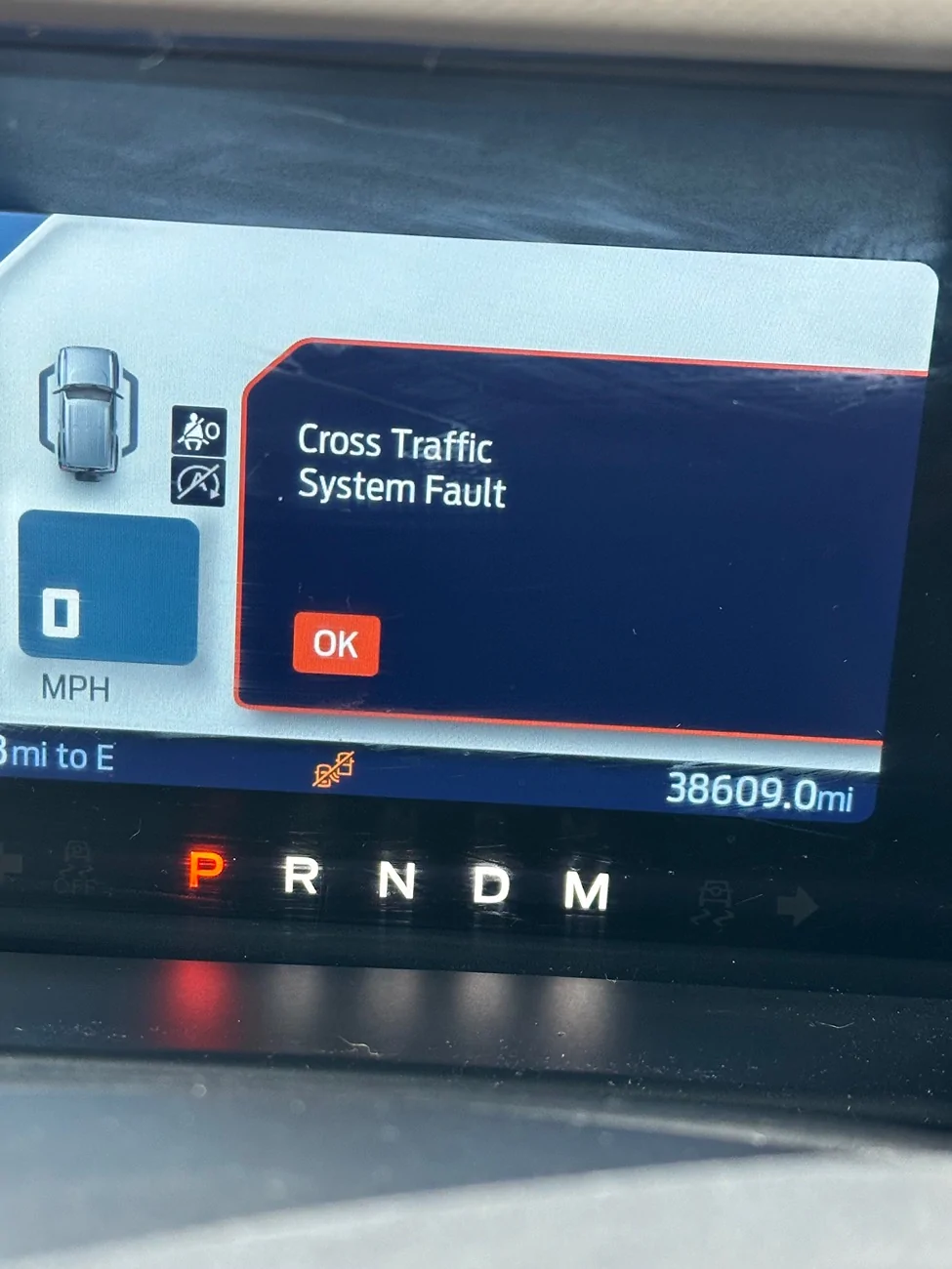

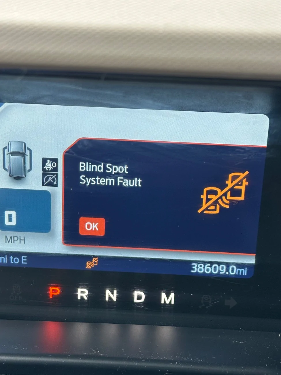

Well it’s time for my near annual repair. This is my 5th winter and 3rd time with this same failure. But no warranty to cover it now. (Passenger side)
If they’ve done the repair even one time during warranty, and it didn’t take care of the problem, the dealership is on the hook to fix this until it’s right.
