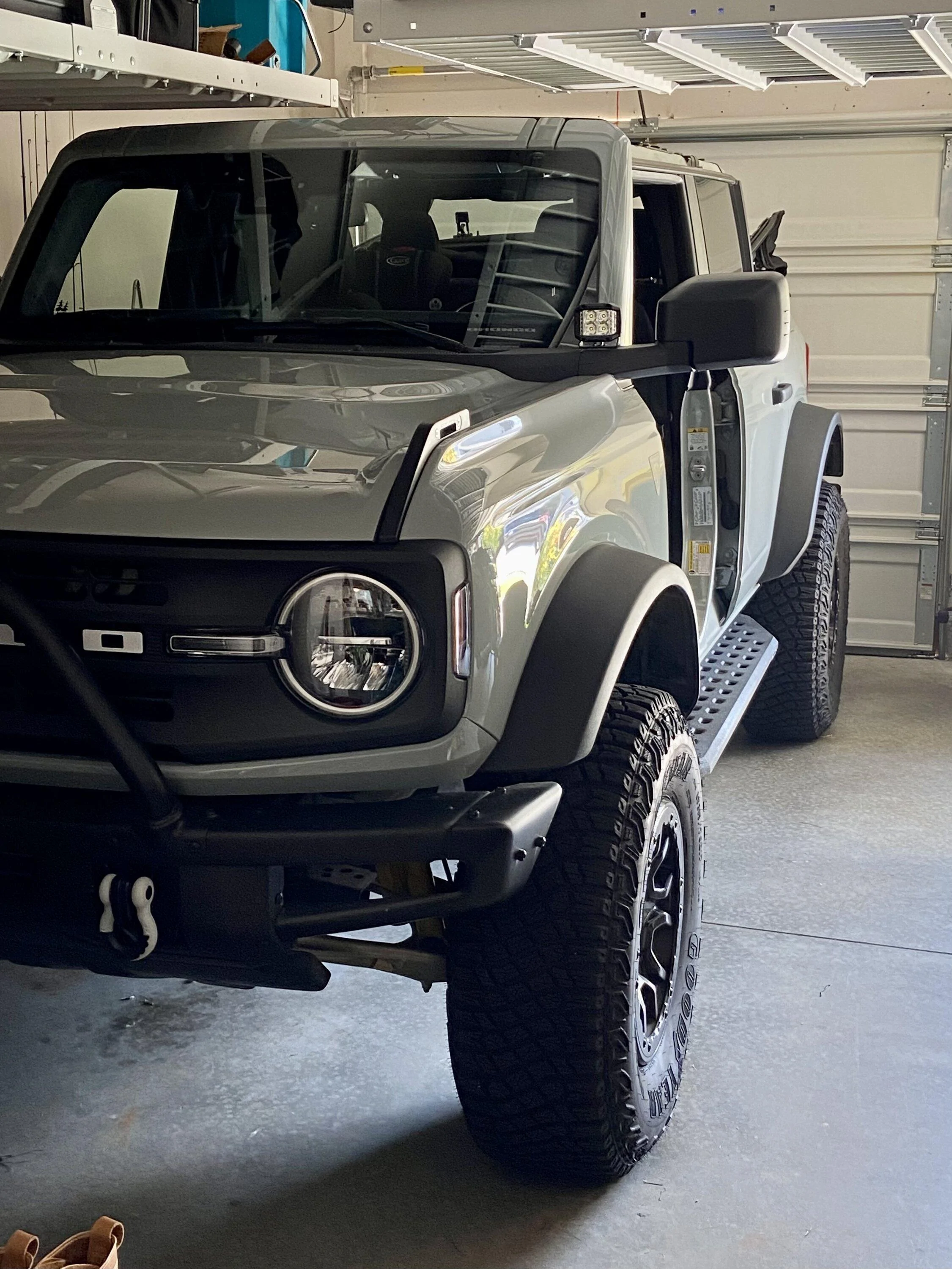

Another after pic
Ford Bronco Sasquatch before and after 35mm wheel spacers 4179E6A5-E1D7-4913-9AD0-D8489D6C719F
