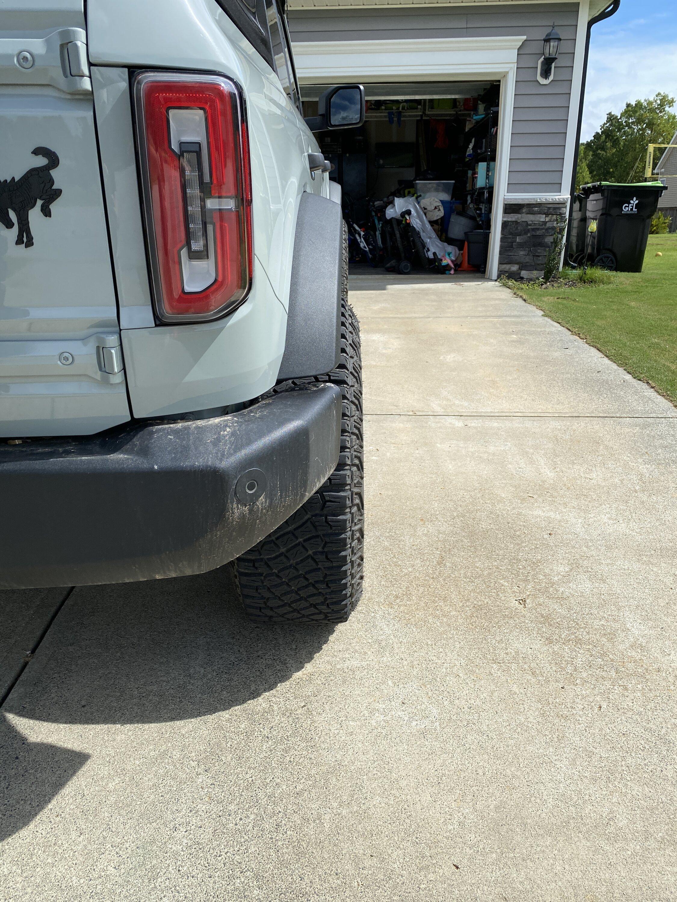

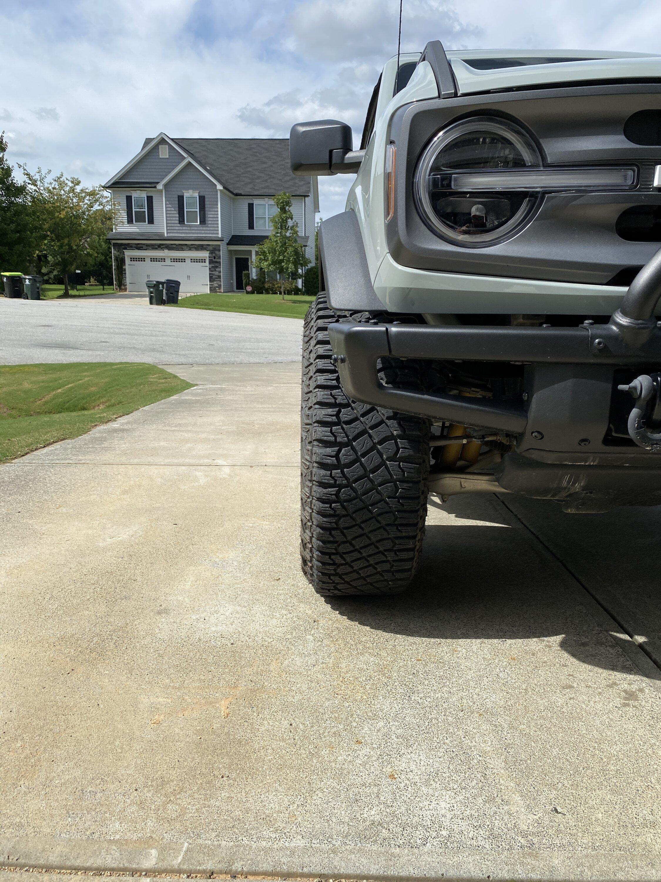

I used 1.4" borne/mishimoto. Very similar results w/stock sas tires, when I switched to 37s I also used the beadlock rings, which, it is worth noting, moves the outboard sidewall outward by an inch or so, giving it just a little more "poke"
I think it looks good, and functionally on trails the sidewall is the widest part of the vehicle (but not excessively so)

Looks nice if you re into tire and flare being close. No right or wrong but I ll stick with factory as these things with SAS fling rocks, mud and everything all over even with the wide flares.
As mentioned offset is harder on wheel bearings; especially if you wheel extreme.

+30mm Factory Sasquatch Wheel
35mm Spacer (-35mm)
-5mm Overall Offset
