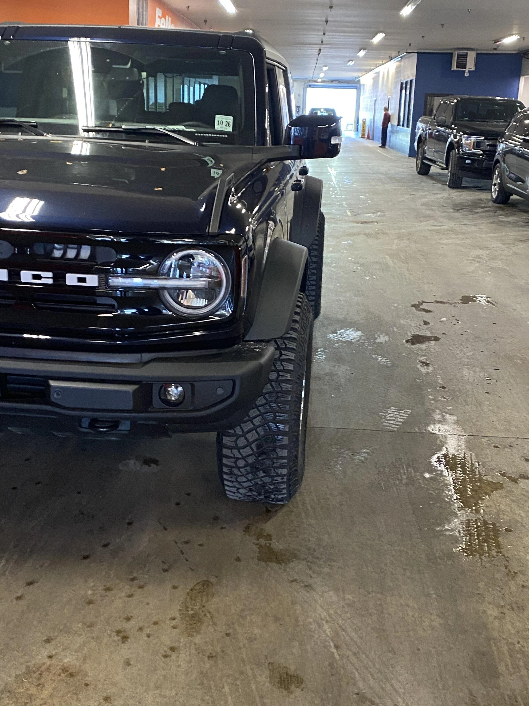

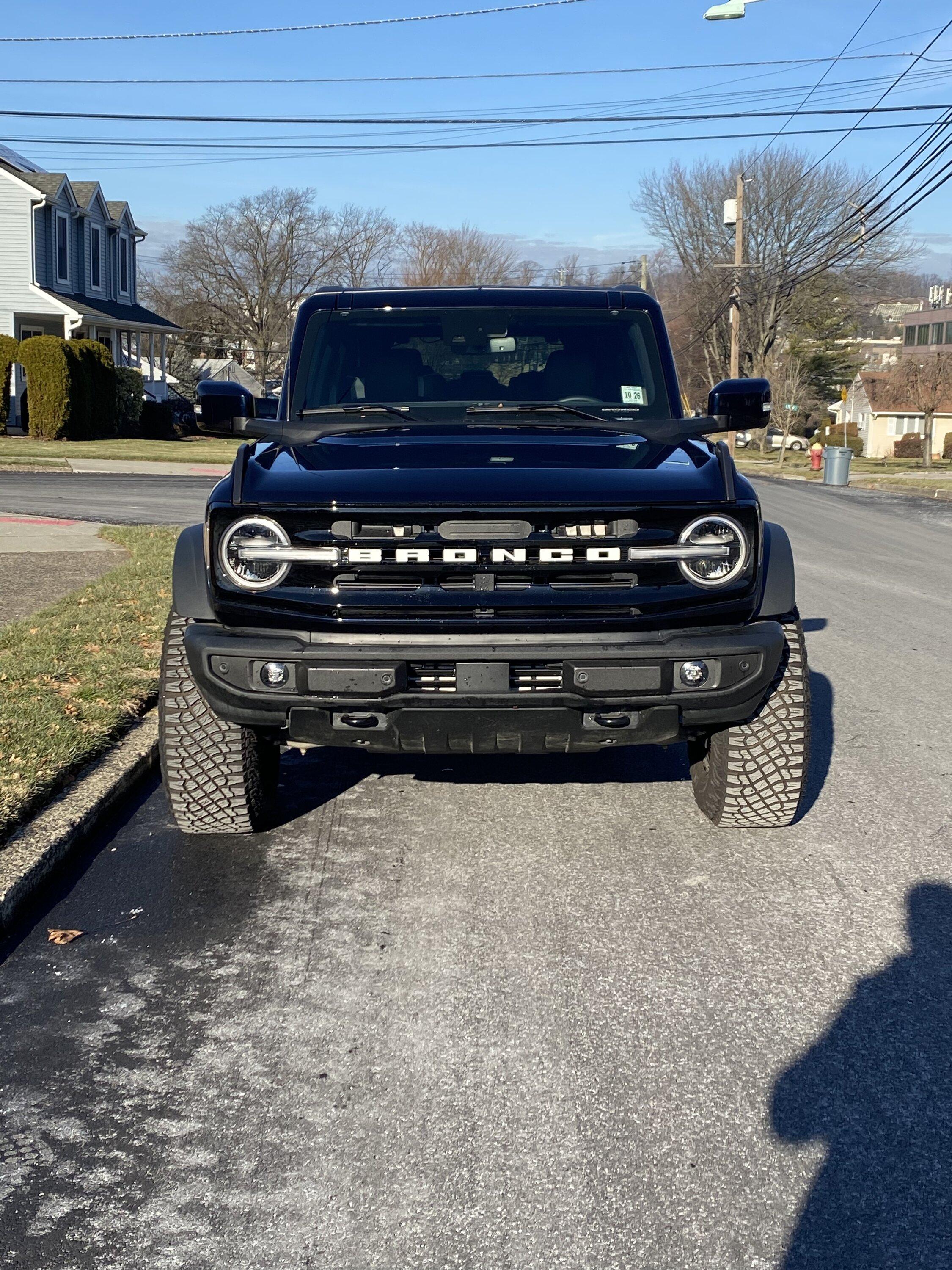

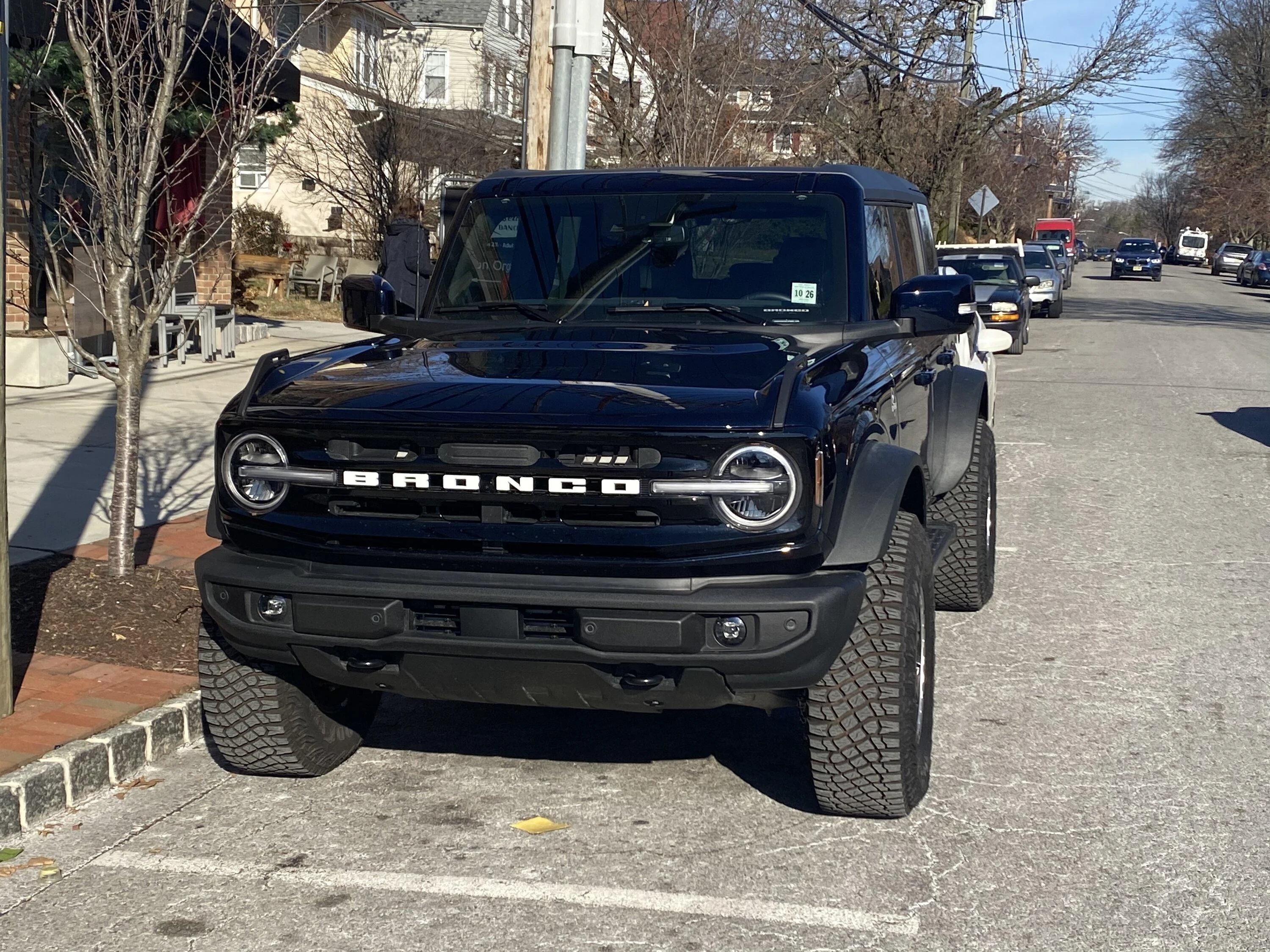

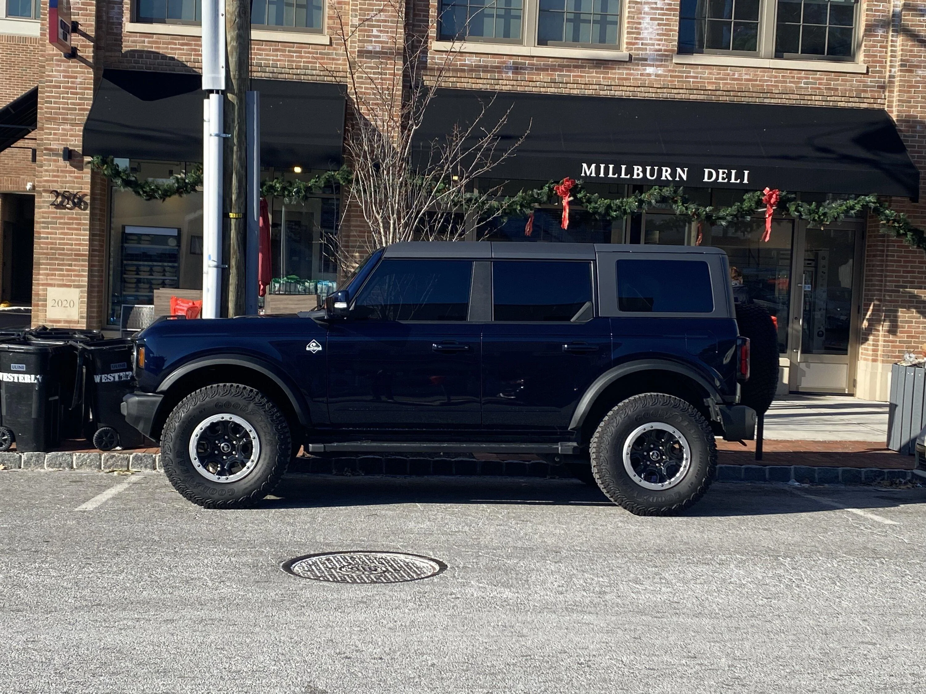

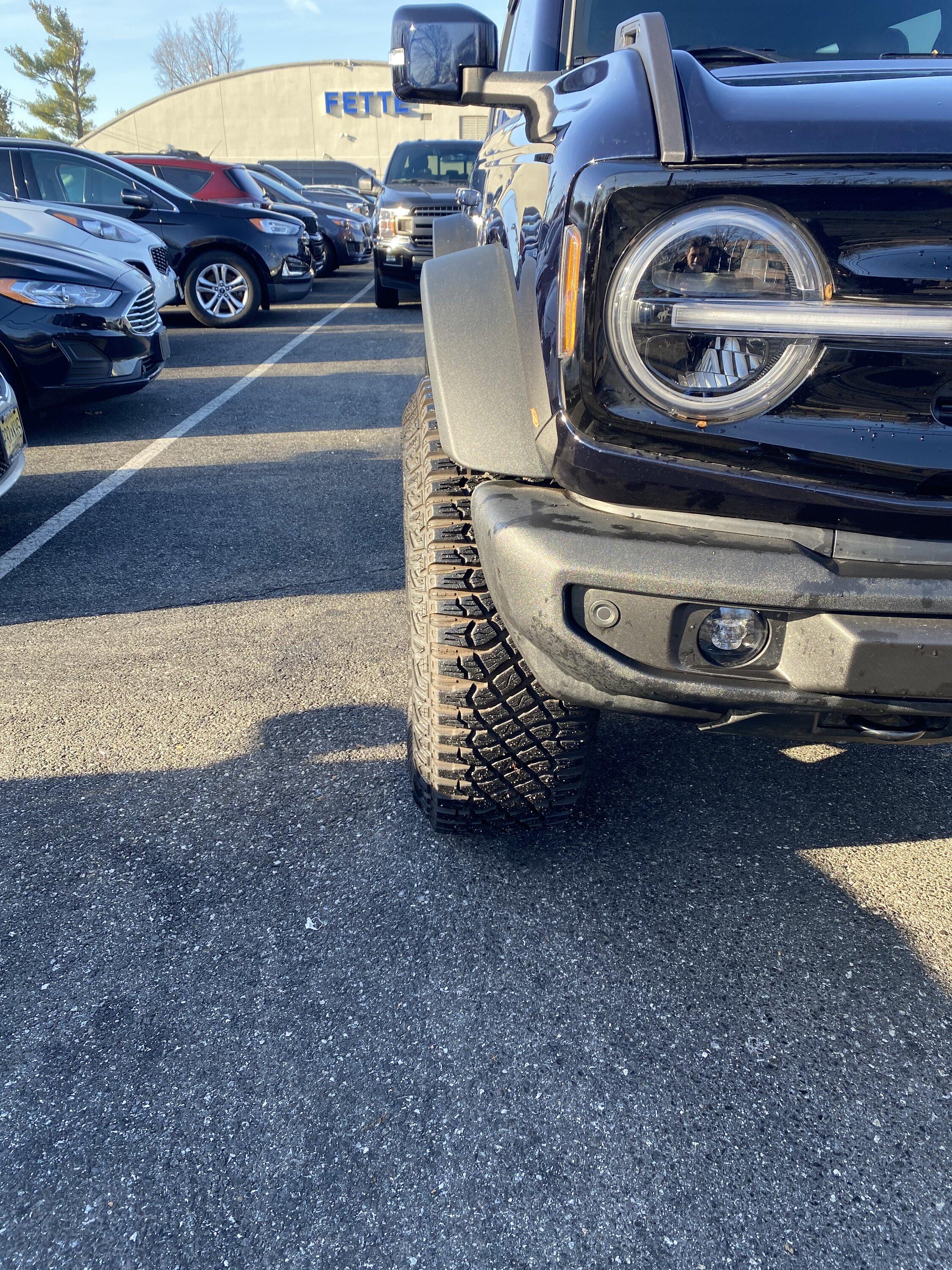

First mod for a pretty tasteful build. The stance is amazing at almost 3” overall wider width. These are 1.4” borne spacers very high quality hubcentric billet aluminum. The 1.5” Borlas are a long wait and I was back and forth on 1.25” vs 1.5” so just snagged the 1.4” Bornes
I’m also clinging onto the standard front bumper since I’m trying to keep the build classy with the OBX. At least until I find a tasteful aftermarket bumper. The beefiness of the stock bumper was begging to have some wheel poke since it hides so much tire.
equivalent offset would be -5 since stock sas is +30
