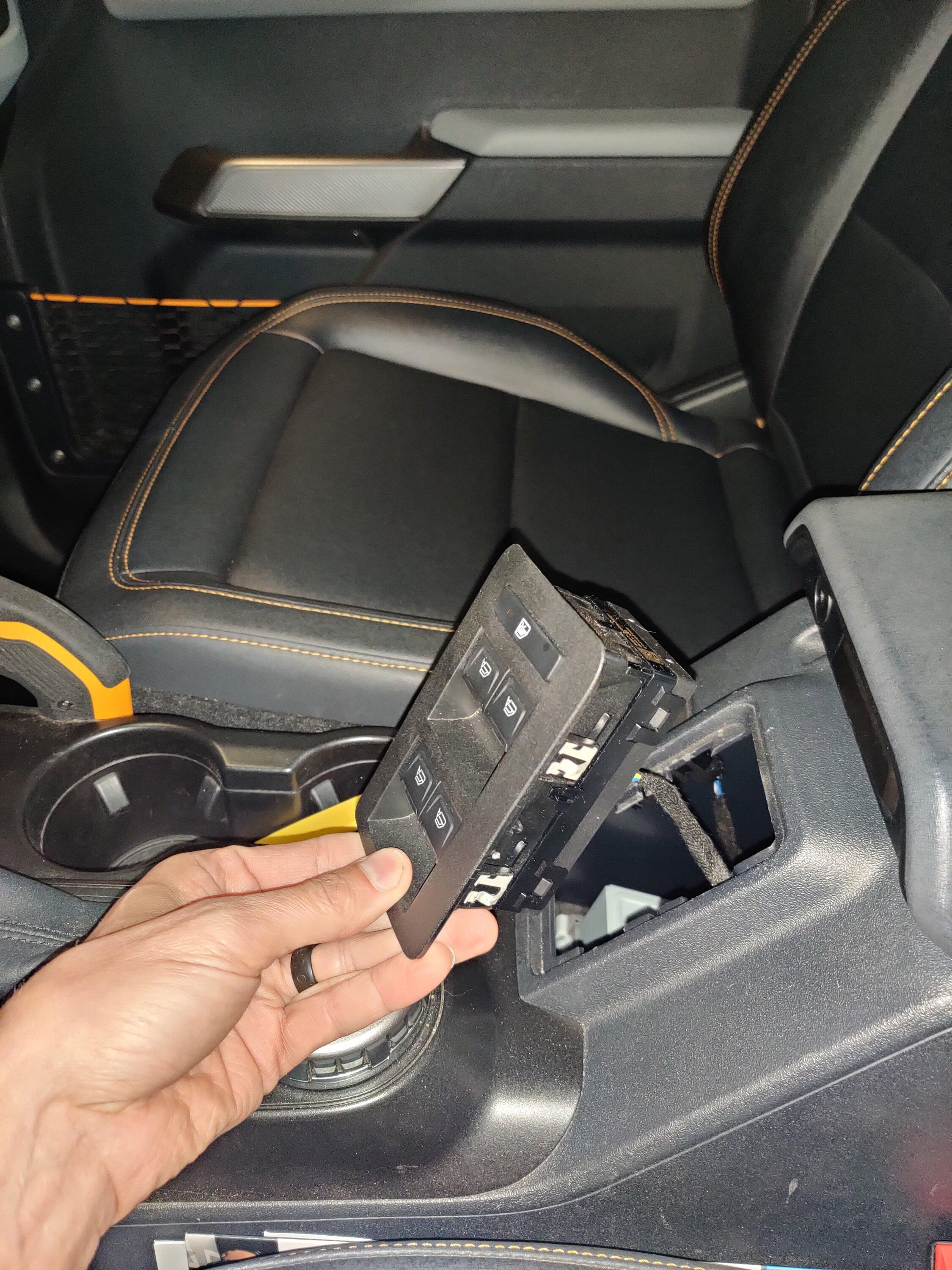

I got the control panel part in the mail but I can’t figure out how to take off the stupid plastic area that attaches around it to replace it with the new control panel. Any tips? I tried pushing those little black tabs in but can’t get it to budge.

Anyone? HELP. Quokka’s don’t have long finger nails.

Yep, easy removal and has just one plug harness in the back. I'll just have local dealership parts order it I can have it brand new in no time.
How did you get the plastic area surrounding the window control panel off?
I could remove it later this afternoon to see. It was awhile back so not sure. But the entire panel comes out real easy with trim tools. There may have been clips holding the plastic shroud around it.
