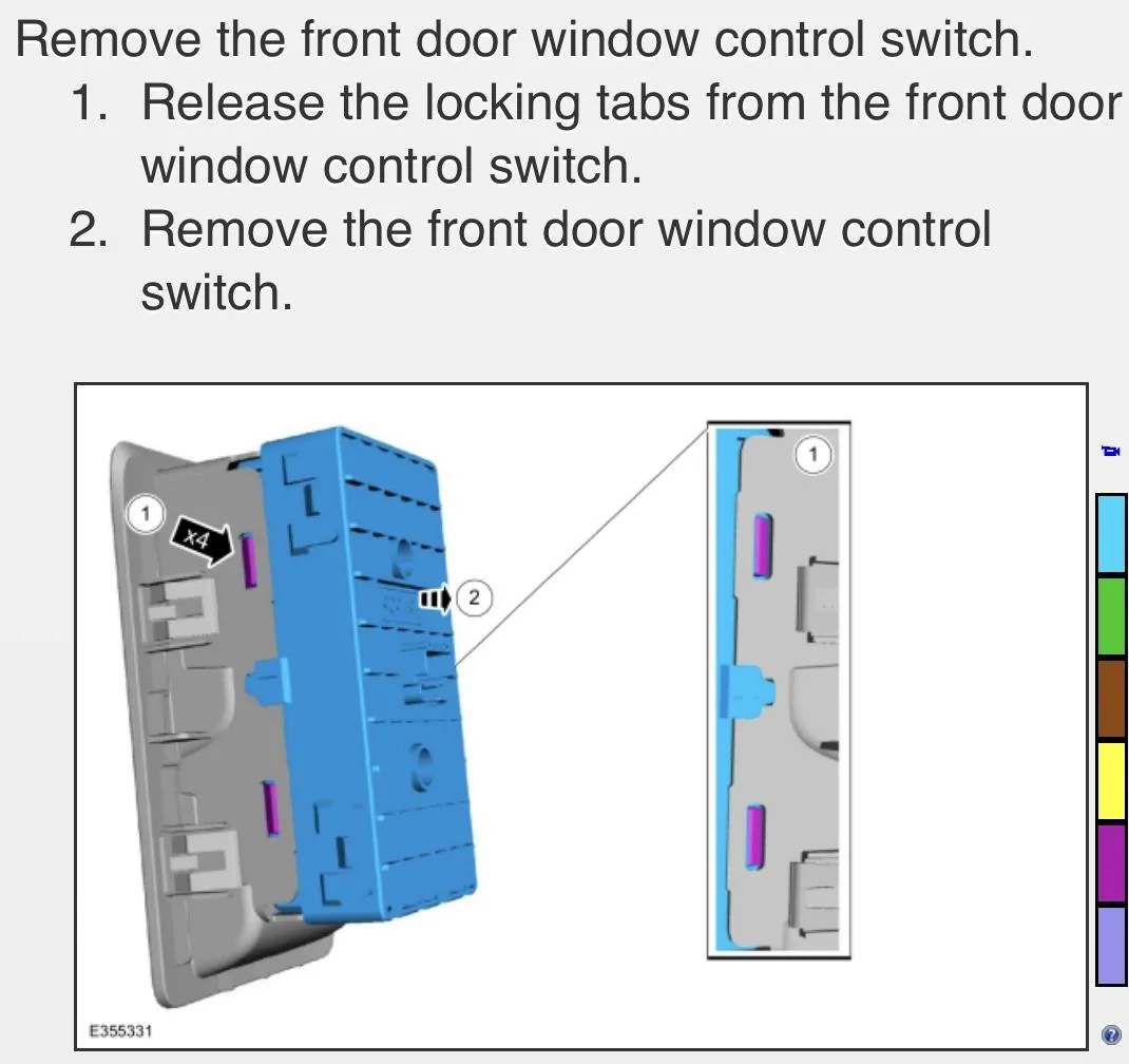

How did you get the plastic area surrounding the window control panel off?
Just need a thin pocket screw driver or something similar to release the clips while pulling the switch out.

Still couldn’t get it off with any hand tool. Finally just said f*ck it and used my Dremel tool to cut into each locking tab to loosen it. That finally did the trick. Talk about a pain in my Quokka’s ass though. Why does Ford have to make everything so difficult?

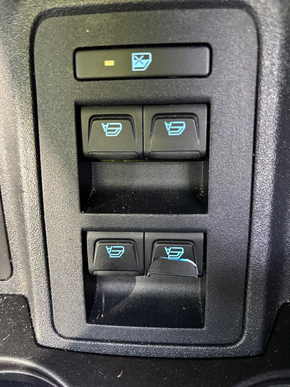

Add mine to the list, ‘22 with 25K miles. Thanks for this post

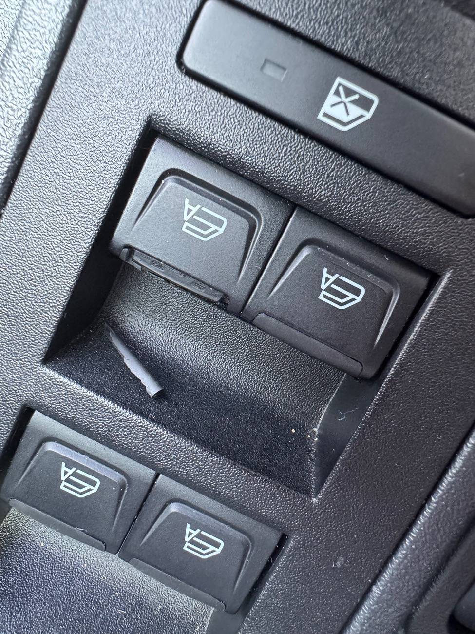

Mine straight up broke. I felt something hit me - which was the rubber trim - looked down and it was cracked. Upon closer inspection the driver rear has a hairline crack too. Glad it’s $25 and 5 minutes. I expected much worse. I used some Gorilla Glue thinking I would be in $100+ and a console removal and have other priorities at the moment.
