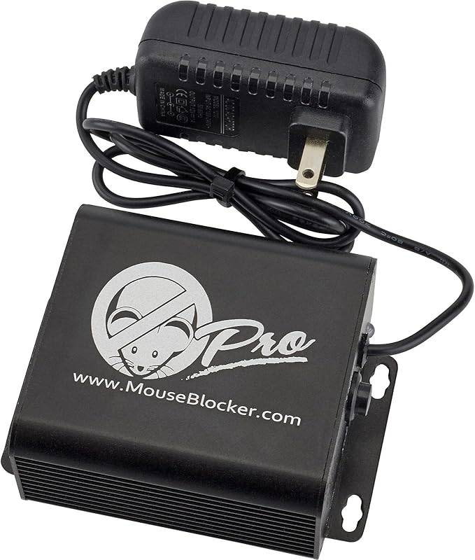

I have seen 12-volt versions of similar devices that you could install under the hood. Try searching RV forums, that is where I saw it.

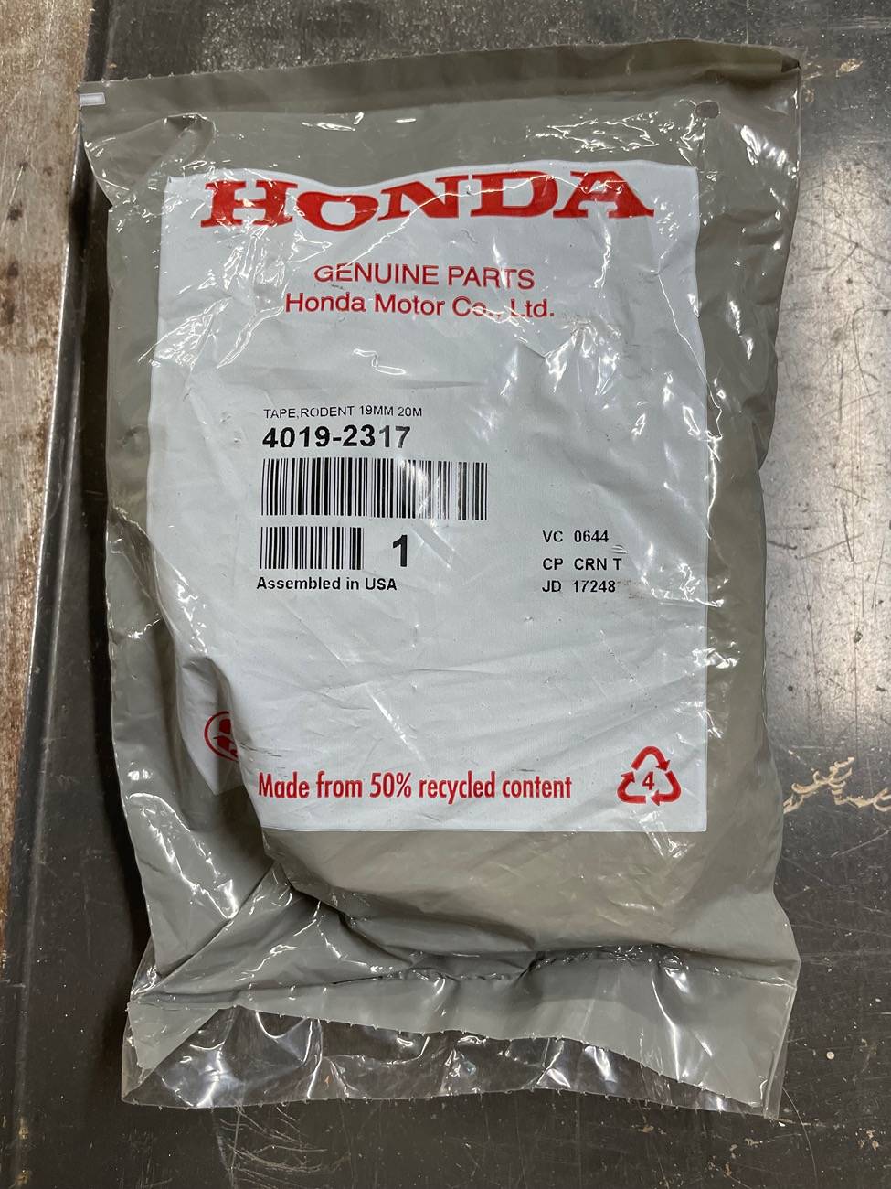

I’m retired from Honda parts department. We sold a lot of this tape made by Honda just for this issue. Cars were towed in quite frequently for rodents chewing up wires. We even sold it to other car manufacturers for this problem. Here’s a pic with the part number 4019-2317. You have to handle it with gloves on. Some kind of hot pepper impregnated rodent tape.

Ps: if my memory is correct it’s pricey

I watch a lot of car shows, and they all recommend Mouse Blocker. They seem to have good reviews. I would check them out.
They also all receive advertising revenue from Mouse Blocker; it's not a coincidence.
