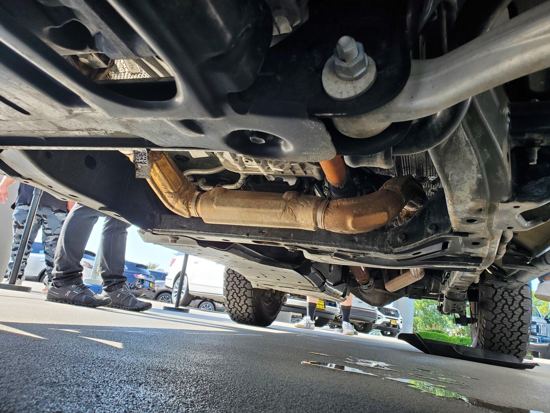

Does anyone else think that THIS transfer case skid plate by @ASFIR 4x4 could also double up as decent cat theft deterrent?
With rare metals being disrupted with the Russia/Ukraine war, I want to be proactive in having protection on my cat from day 1 of owning a Bronco.
What’s the latest options available? Deter with partial Asfir plate, or anything else out in the aftermarket?

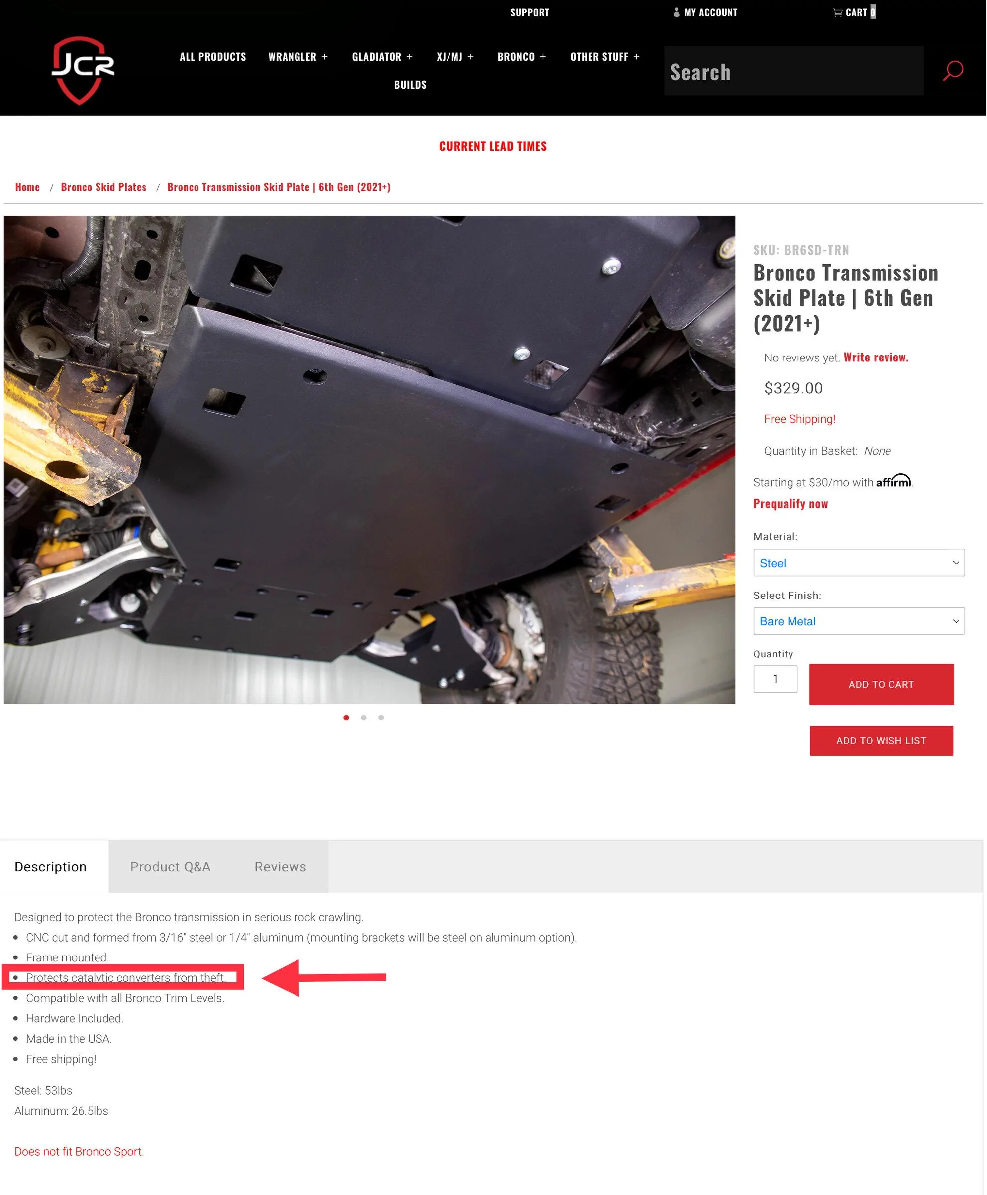

@JcrOffroad’s transmission skid plate does…
https://www.jcroffroad.com/product/BR6SD-TRN.html

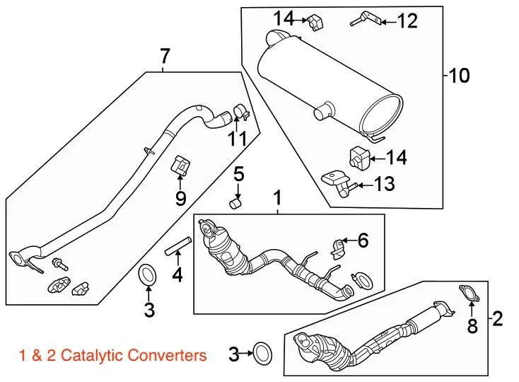

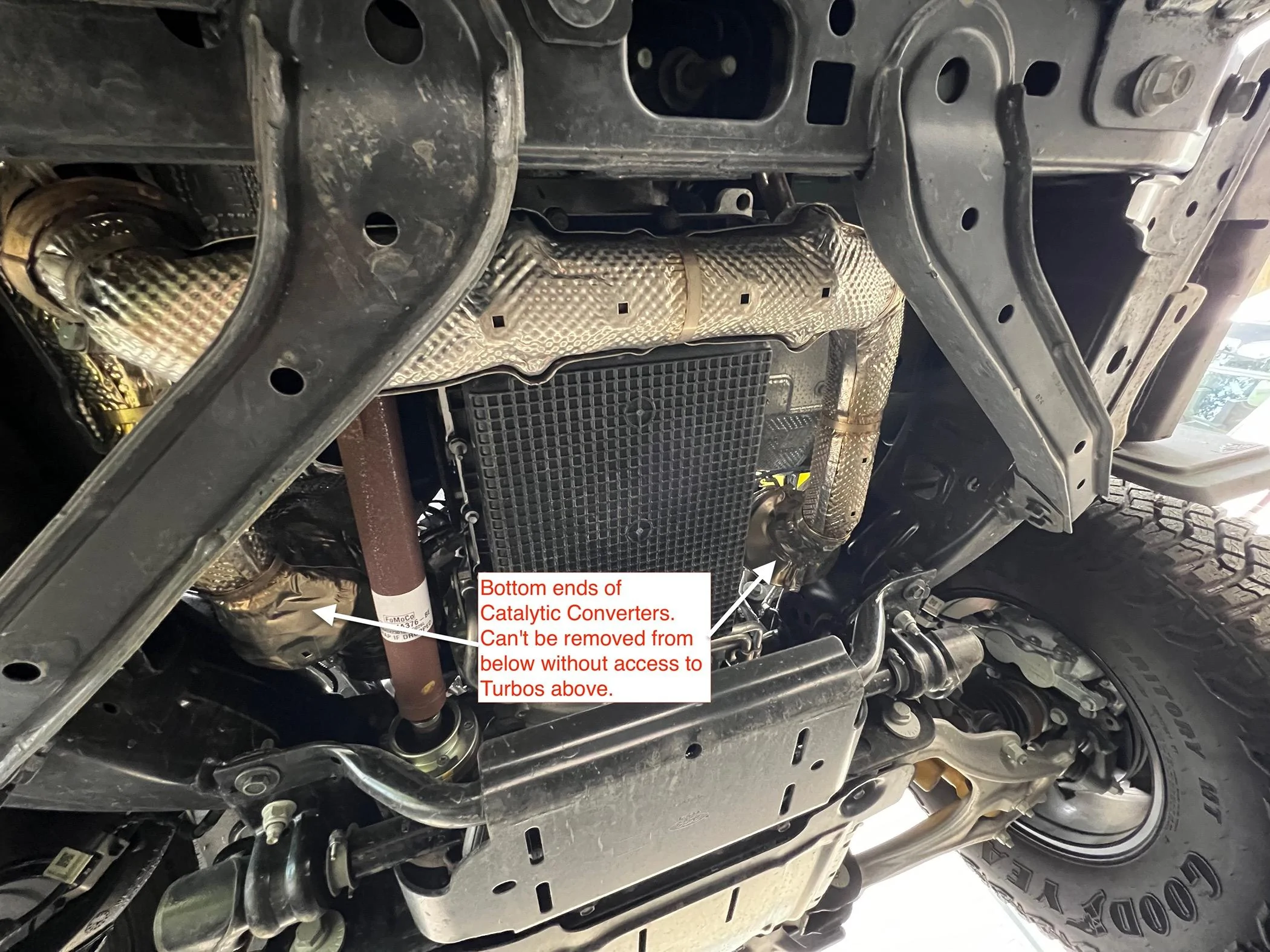

Ford designed the Bronco 6G with the catalytic converters bolted directly to the turbos in the engine compartment, so they are not accessible from underneath the vehicle. It's one less thing Bronco 6G owners have to worry about. This is the 2.7 V6, but the 2.3 Inline 4 also has it's catalytic converter snug against the turbo.
Ford Bronco Catalytic Converter Theft Prevention BroncoV6EcoExhaustAnnotated
Ford Bronco Catalytic Converter Theft Prevention BroncoCats - 1
