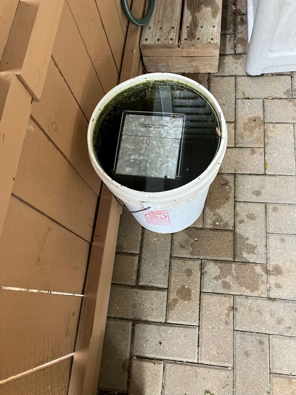

I’m a better trapper than I am a hunter. But I’m even a worse swimming instructor.
Ford Bronco Rodent prevention damage IMG_4403
Nice!!! That reminds me of a YouTube I saw a few years ago but the guy set-up a roller over the top with 2 ramps going up to each side of the roller. He smeared peanut butter around the centre of the roller. Mice and rats would walk up onto the roller and get dumped in drowning overnight. He got something crazy like 12 or more in one night. It's more satisfying to slip the barrel out the window like Lee Harvey Oswald and let them have it from the grassy knoll!!!!! Lol!
