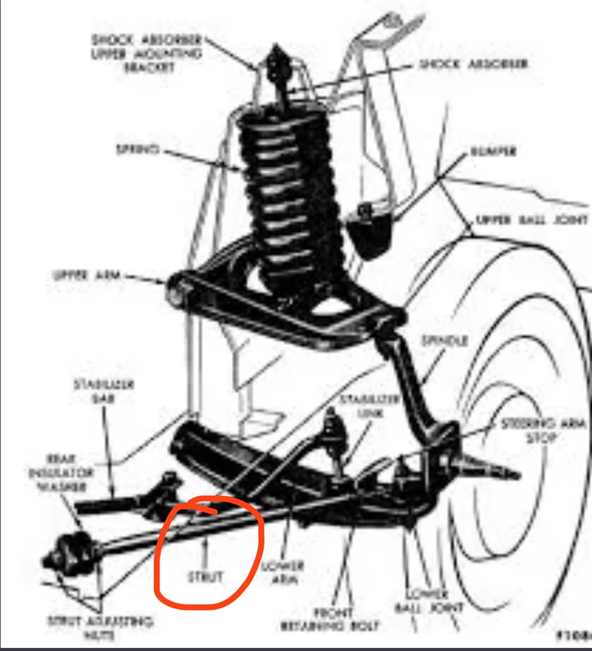

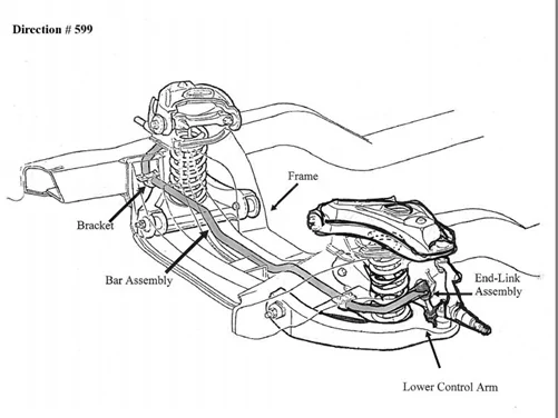

Sorry I logged off last night and didn't see your reply. Sometimes pictures do better than words.........
Ford Bronco Ride Shocks 1768953920871-ds
As you can see the strut also acts as the UCA, there is only the LCA. It is integral to the suspension. Take it away and everything falls apart.
Ford Bronco Ride Shocks 1768954023748-b4
As you can see here there is a UCA and an LCA. The coilover only controls the suspension. It is not an integral part. Take the coilover away and everything just sags down, it is still all connected together.
Ford Bronco Ride Shocks 1768954670036-ia
Now this would be your average UCA, LCA suspension. This example is a 69 Camaro. As you can see this has a separate coil spring and shock absorber. Easily replaced with a coilover.
