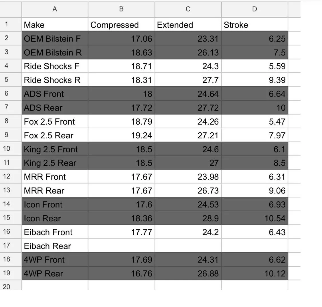

Stay away from worrying about wheel travel numbers. As long as the LCA is oem then shock travel becomes the most basic metric. All shocks mounted on oem LCA produce identical wheel travel for the same shock displacement. Also wheel travel requires knowledge of LCA motion ratio (motion amplification from LCA geometry). A good estimate is 1.6 for oem LCA but it is actually non-linear and not that simple.
The two most basic numbers to consider are shock extended and compressed lengths. The difference between these numbers is the shock travel. There is a maximum extended length that works best for the oem LCA, 24.3”. For greater lengths the LCA angles get too large (CV angles become large).
The compressed length will dictate the amount of tire/fender interference that occurs. Many of the more expensive coilovers are designed with compressed lengths to keep 37s out of the fenders at full stuff. Just depends how conservative you want to be.
Some numbers. I am not sure they all use the same reference points but an example.
Ford Bronco Ride Shocks IMG_6584

Stay away from worrying about wheel travel numbers. As long as the LCA is oem then shock travel becomes the most basic metric. All shocks mounted on oem LCA produce identical wheel travel. Also wheel travel requires knowledge of LCA motion ratio (motion amplification from LCA geometry). A good estimate is 1.6 for oem LCA but it is actually non-linear and not that simple.
Oh wow very nice thank you for sharing. Do you have these numbers for the Ride Shocks?
