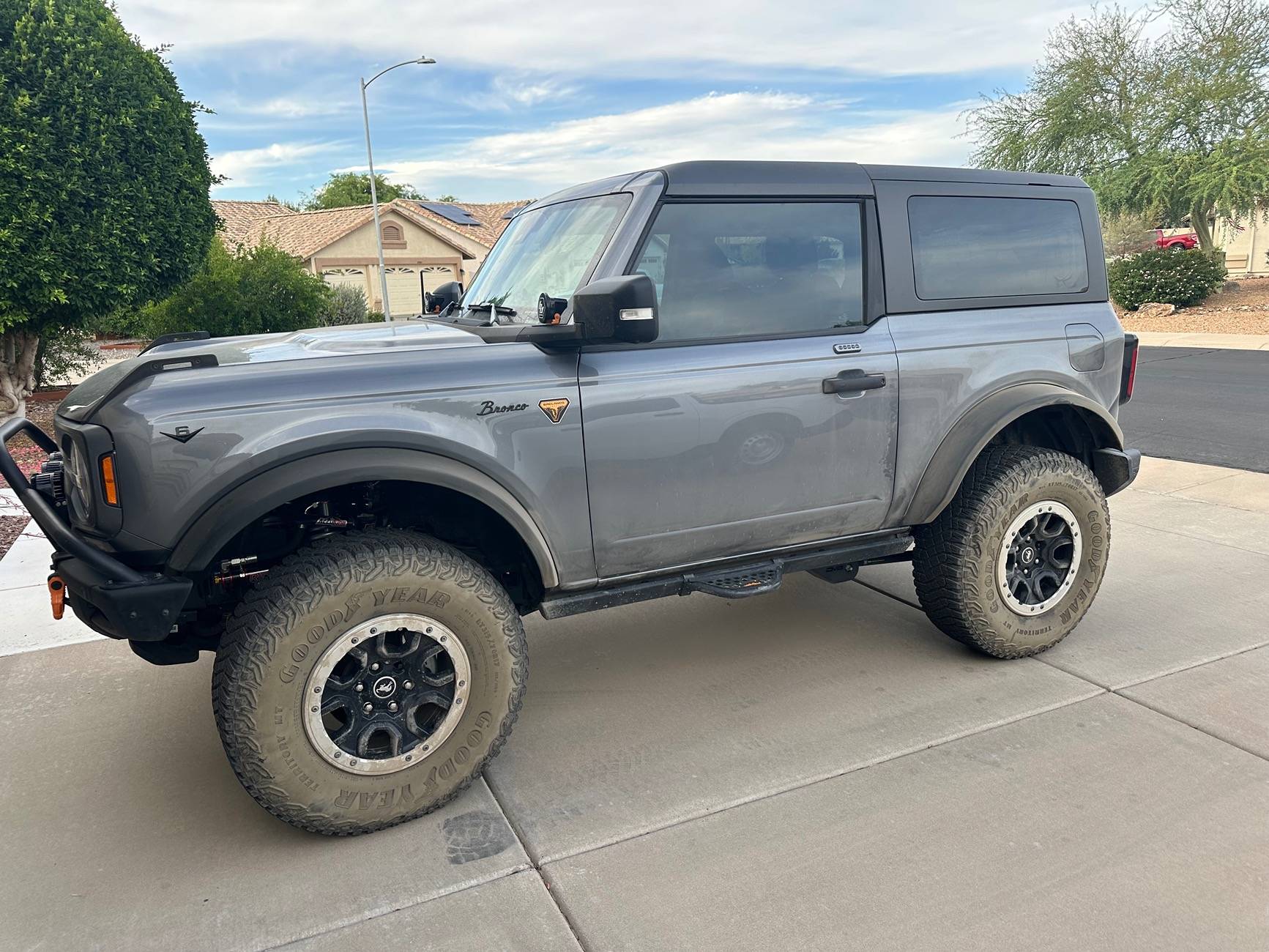

Just had my Ride Shock, coil over, level 3 kit installed on 2D 2023 Badlands Sasquatch at a shop. Level 3 included a bunch of ICON arms in rear. Went with lightest weight range coils. Front was raised 2.5” and rear 1” so now I’m level at 41” ground to center of fender flair. Still on factory 35” until I mod enough to get to 37s.
At softest shock setting, ride is more controlled than factory, not super plush but civilized both on and off road - more of a tight sport feel like a BMW sports car vs Cadillac comfort. I felt connected to road/ground through steering and ride sensations but not in an annoying way. I was able to hit Arizona trails much quicker than on old shocks and felt more in control. Shocks took some hits while traveling quickly and kept me tracking straight. Curious how this will do crawling in Moab which is on calendar by October.
This ride is different than what I expected … I was thinking ride would be more of a marshmallow cushy but maybe that is not what is possible with still being able to control vehicle offroad, especially at 30+ mph on washed out desert trails.
This is my first shock swap and only thing I can compare to is a 2021 Ranger Tremor I owned with factory Fox Shocks. Different vehicle and different ride … as I remember it was more cushy but I wasn’t off-roading with it either.

Pics of your 2 door Sas or it didn’t happen. 😊
By the way would you be able to upload your alignment chart. Wanna compare with my Sasquatch 2 door. I’ve got Bilstein 6112. Kinda wish washy if I like them. I noticed they feel like I am one marbles and the steering input feels very different and light. I have to keep both hands on steering wheel even when going slow. I think I need more weight on the front end by lowering it one clip and the alignment needs rechecked cus looks like my tires have a bit of positive camber too much. You can pm me the chart if that’s cool.
