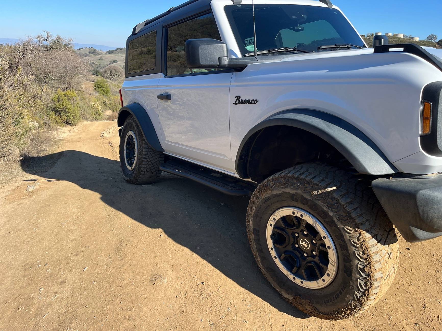

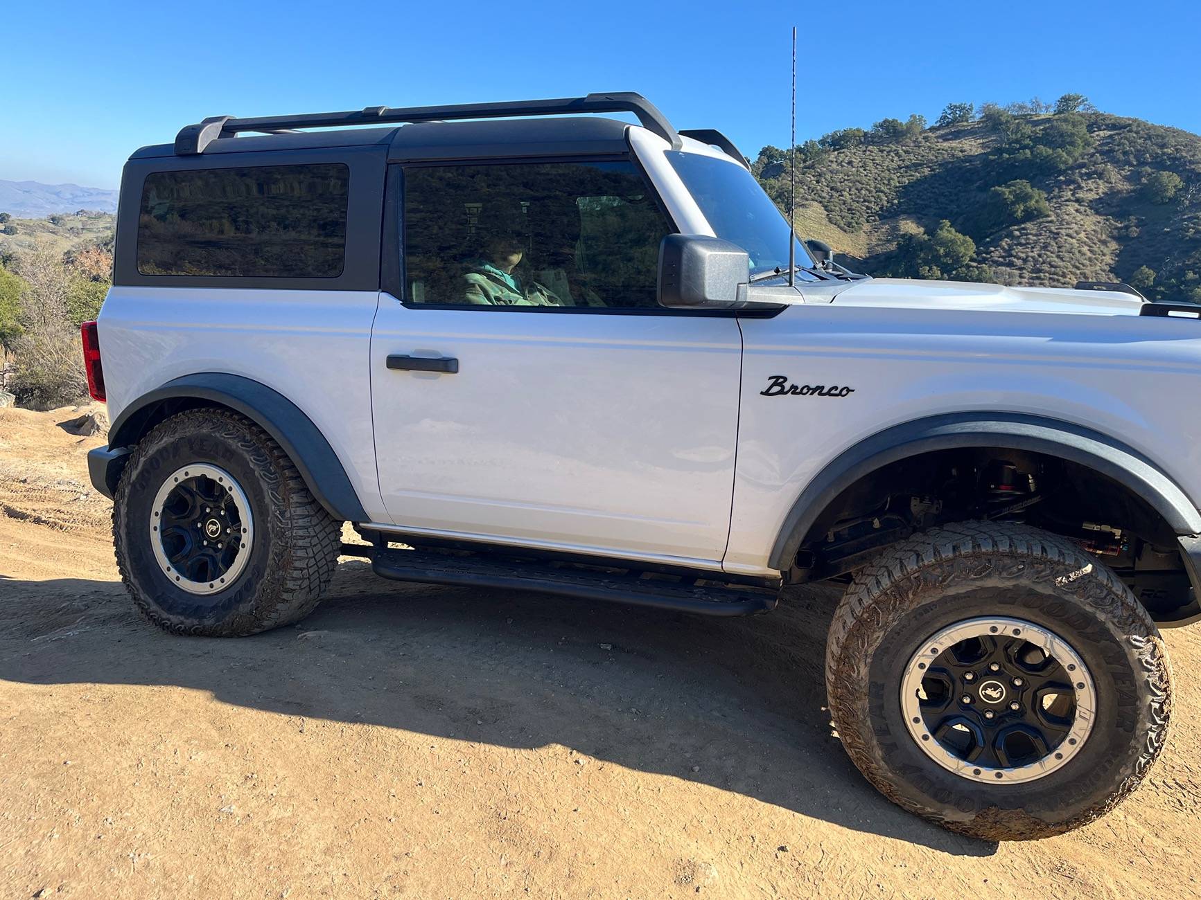

My experience after a week of street driving and a trip to the local OHV park. I switched from Eibach coilovers which were pretty plush with a bit of body roll. The Ride’s are firmer without being harsh. Cornering is much better, the truck feels planted without the body roll. They soak up small bumps really well, I purposely am hitting potholes that I avoided before. There is a railroad crossing nearby with about a 4’ rise and fall, I have been hitting it faster each time I go by. Maxed out at just shy of 50 mph due to space limitations. The suspension soaked it up, I used to slow down there with the factory and Eibachs.

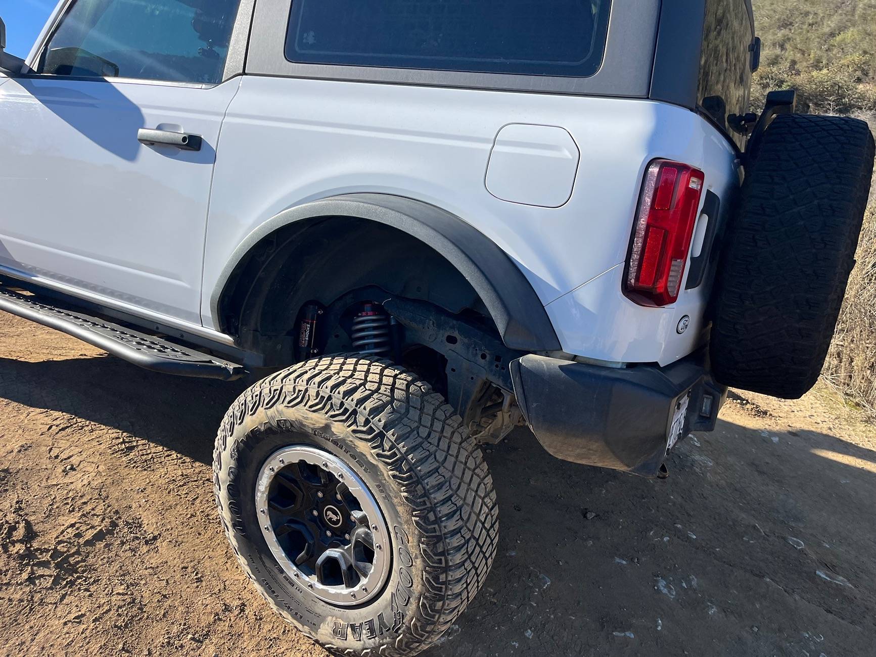

At OHV park for a test run and last time on 35s. The shocks worked perfectly. Rear travel definitely increased dramatically. I am considering the Walker links to allow more articulation in the front. I wouldn’t have felt comfortable doing this with the Eibachs but the control on the road with the Rides has me feeling confident to try them.
I went with Ride over Kings, Fox or some of the others as they were developed for 37” tires.

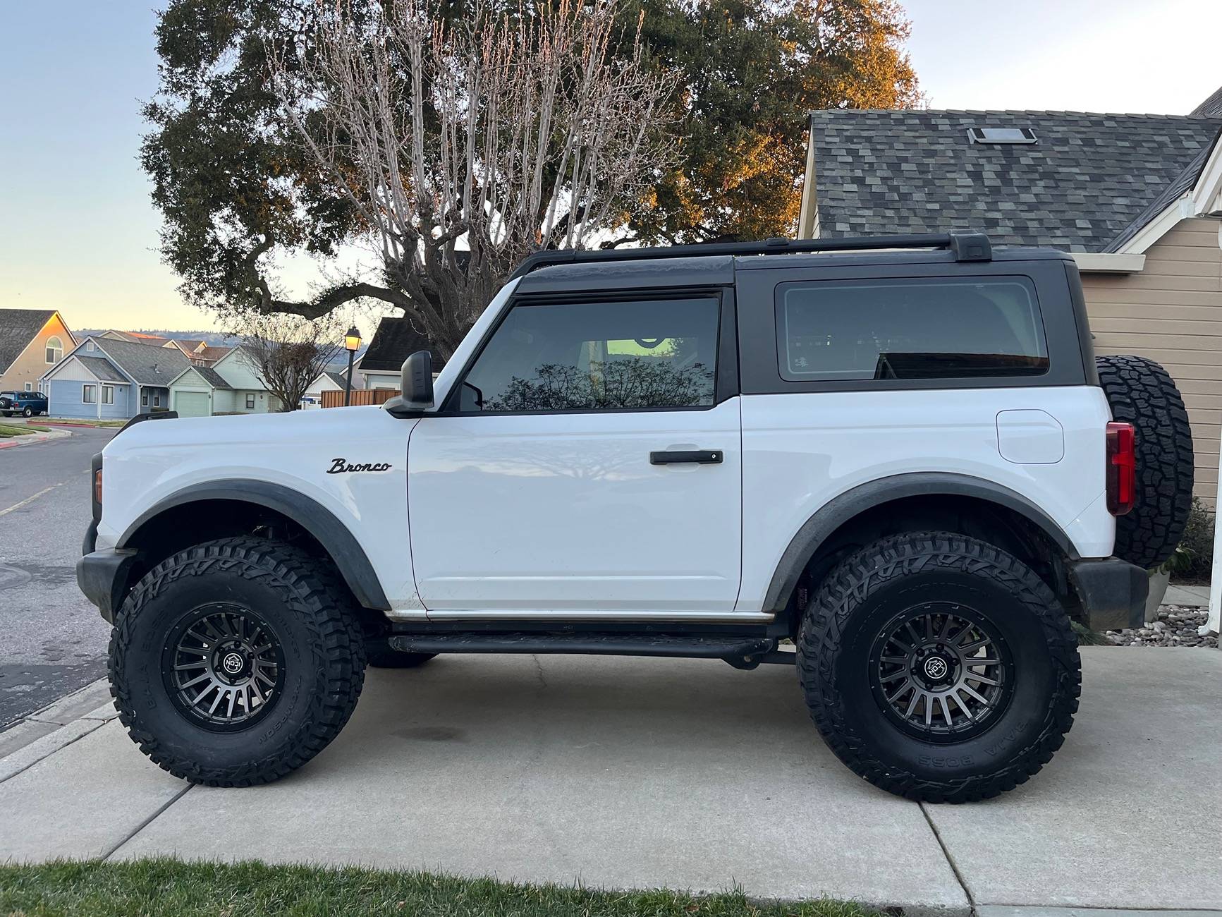

@milbums are those the Recon Pro wheels?
