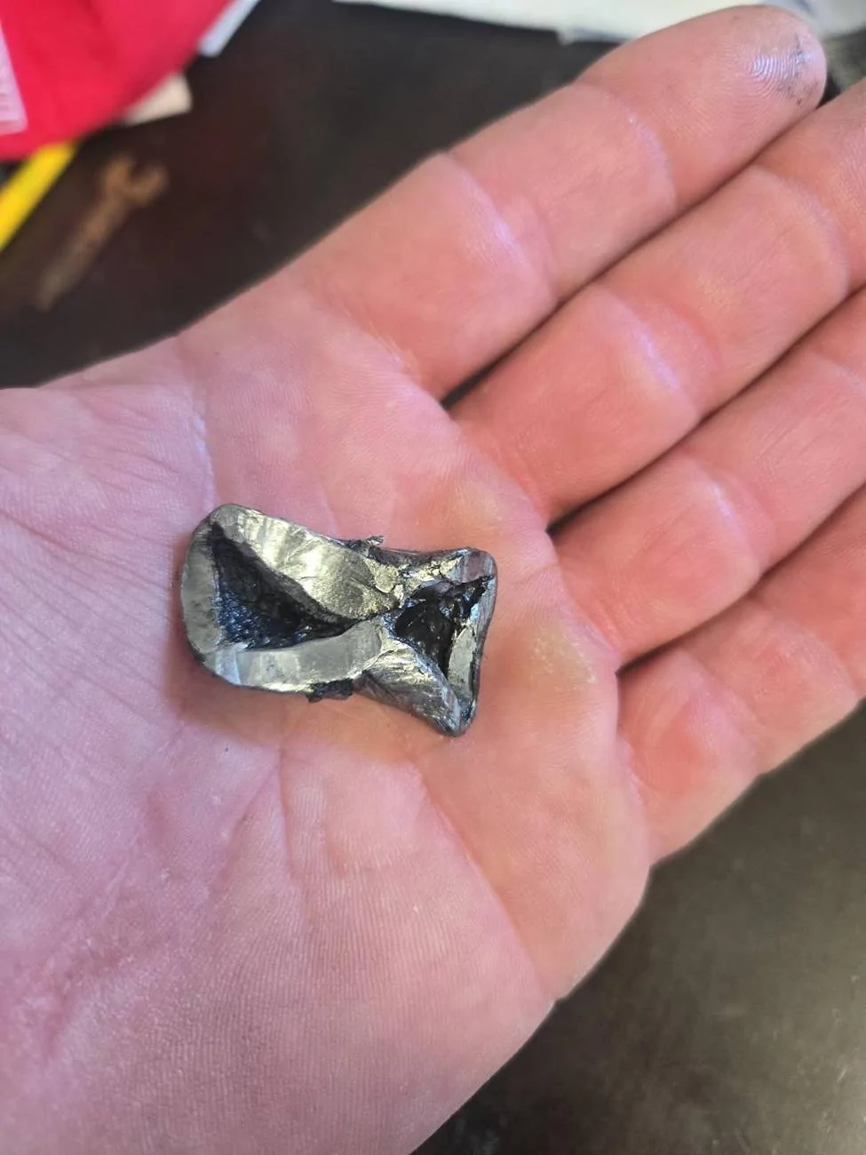

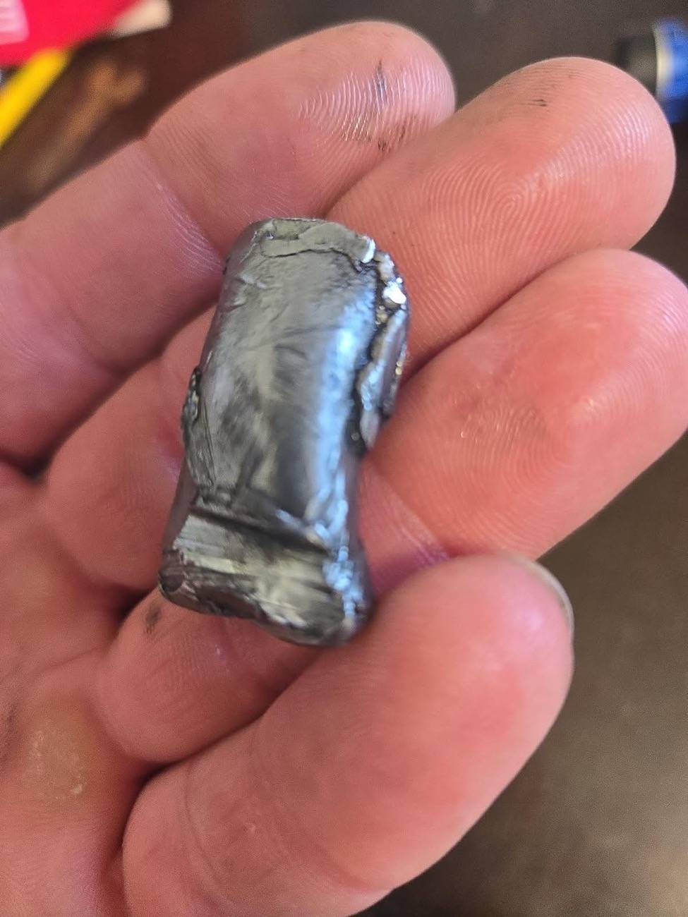

I was a knucklehead today and forgot to lock the rear diff. Got in a bind close to the edge and hammered it enough to knock teeth off the front ring and pinion (190 with no locker). When I figured my brain fart and locked the rear diff it walked right out of the bad spot I had gotten it into. Both embarrassing and expensive. Limped it to a buddies shop and we had the diff out and tore apart in about an hour to see the damage.
Don’t be too hard on me. Hopefully someone can learn from my mistake.

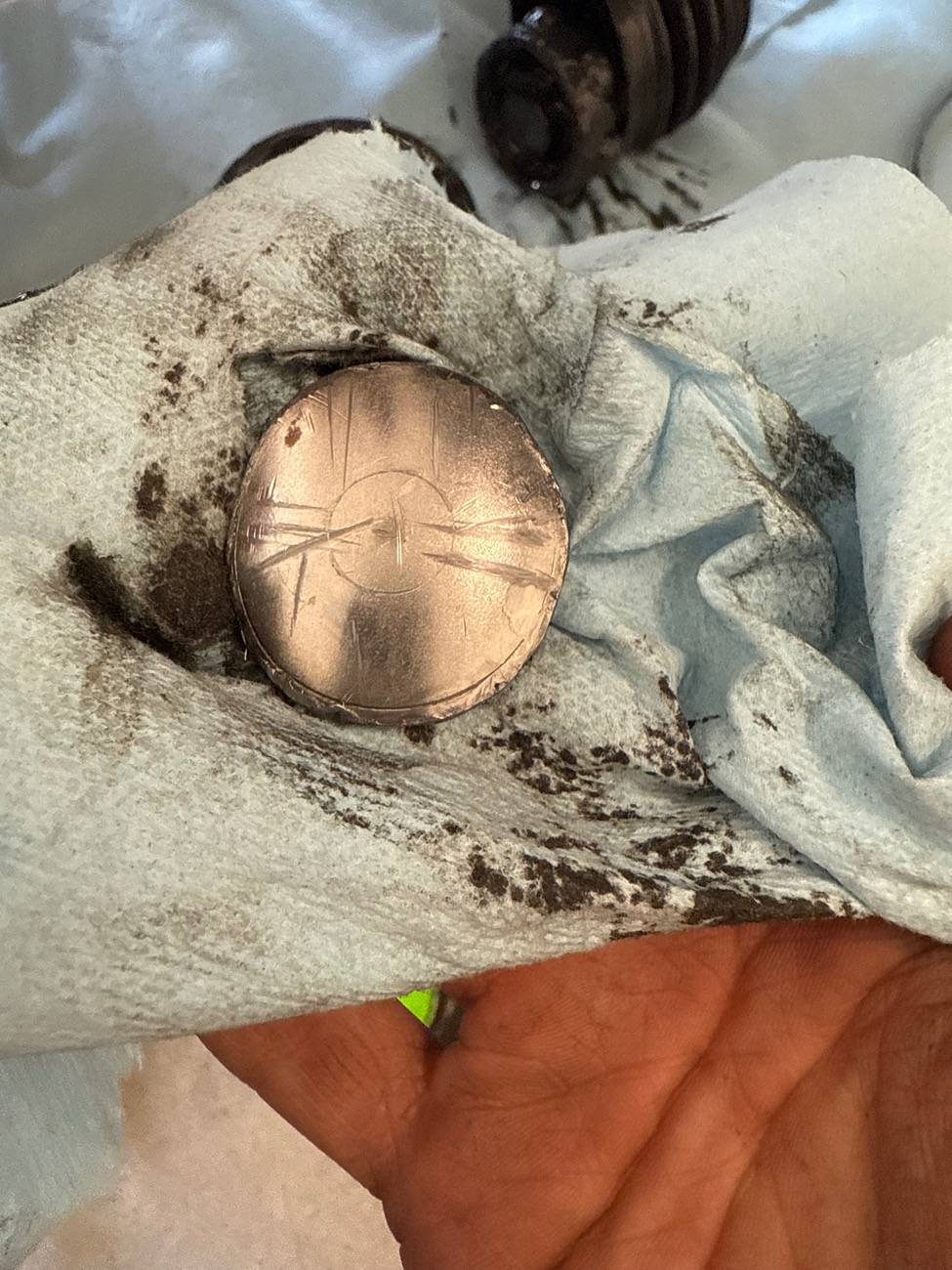

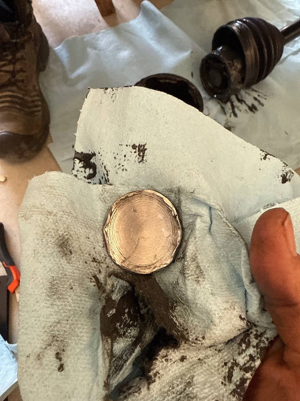

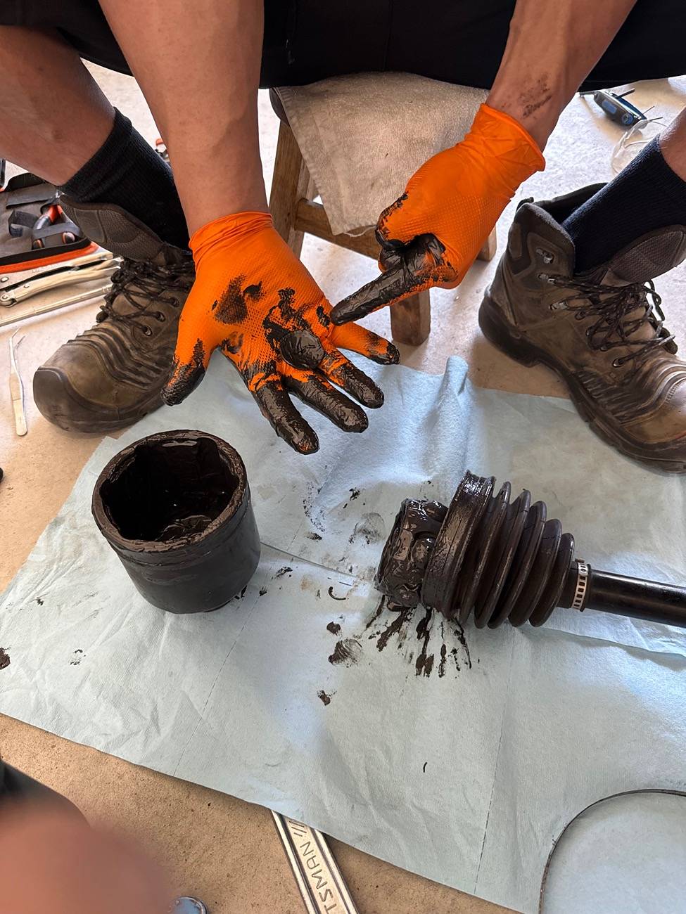

And with that said, if you upgraydde to the UFDU and randomly your ride starts making a tinking sound that can’t be diagnosed, pull the passenger CV and have a gander inside the inner bell. If you can see inside to the cage, you might eventually have a bad time due to this mofo.
