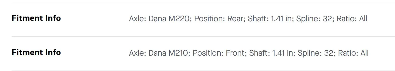

In the Jeep world, some models use the m210/m220 combo as well, and in many of those, the same air locker works for either - they both use the same carrier assembly (or at least similar enough it doesn't require any difference on ARB's part).
But, Ford doesn't use the exact same m210/m220 - bearings are different sizes, the ELD is just a bit different, etc. There is an ARB air locker for the m220, but I don't know if it will also work in the Ford m210. Looking at Spicer's parts list, it shows that the m220 and m210 carrier assemblies are also two different part numbers.
It ~might~ work? I know the ELD part number is different, but the only difference is where the locking pin is welded into the ELD. So maybe the differences in carriers doesn't matter that much either - hard to say.
The ARB part number (RD245) has different requirements from different sources. Some say it's for m210 or m220, and lists any non-SAS Bronco as compatible. Others state M220 only, but give a lot more axle restrictions.
I'd be more inclined to believe the latter, but even the main ARB site for the product is not definitive and lists both m220 and m210 as compatible.
https://store.arbusa.com/air-locker-differential-dana-m220-32-spl-rr-rd245/
Ford Bronco ARB air locker options for bronco black diamond front diff 1738801663178-46
I bet it can probably be done, but I wouldn't be surprised if it took a shoe horn and someone with magic fingers, an angle grinder, and some luck to make it work just right.
