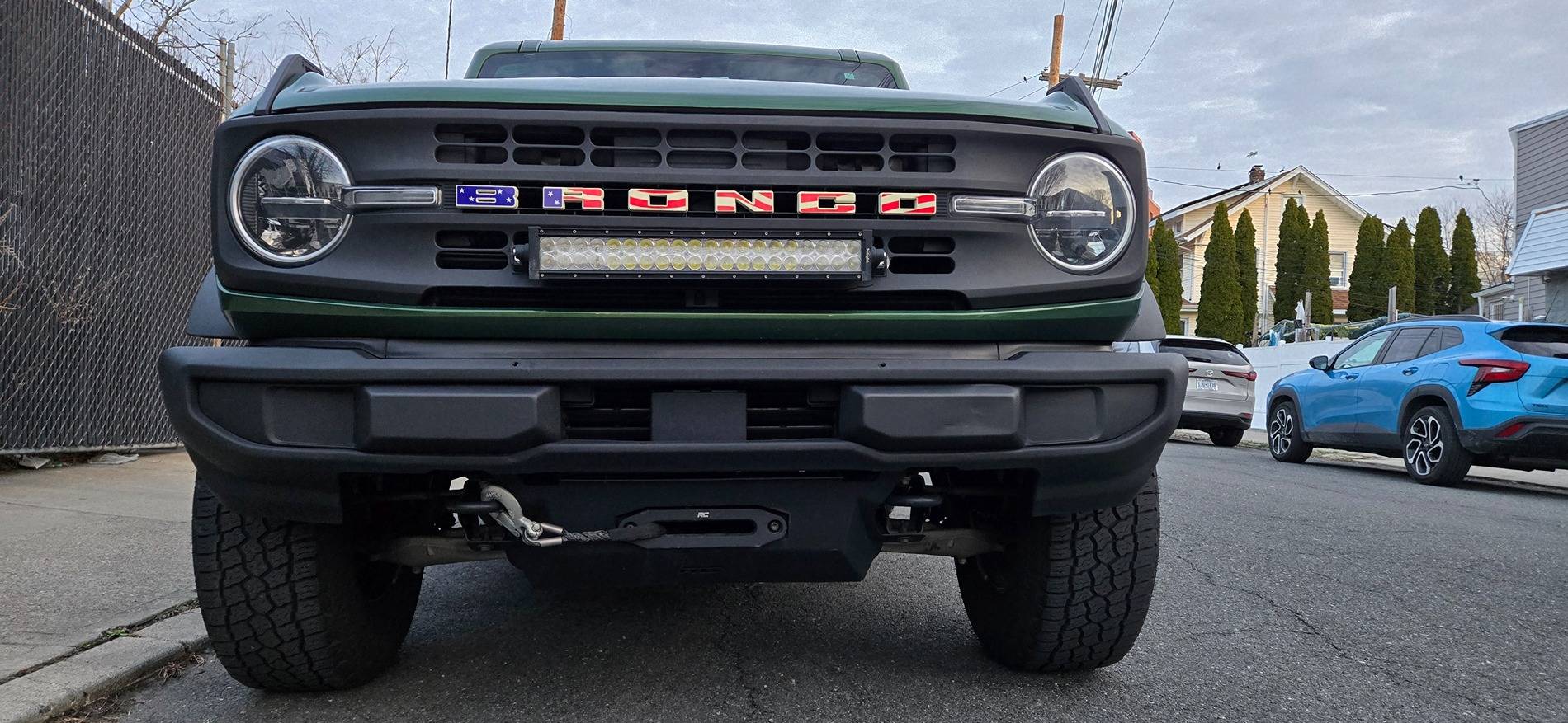

I have a base model and installed the rough country hidden winch. Not bad for what it's worth.

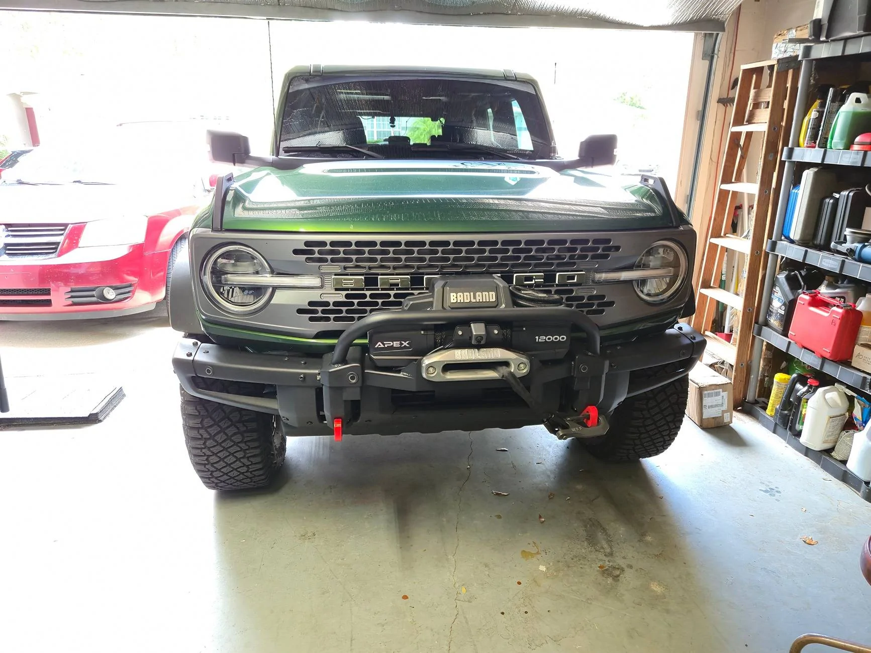

Just installed a badlands apex and buckleup offroad winch plate/Bull bar today. Also installed the maximus-3 frame reinforcement plates.

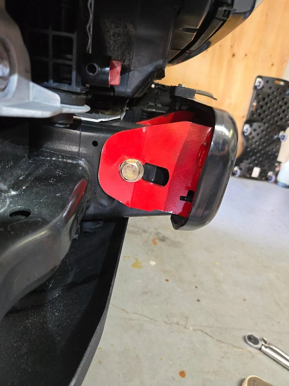

Did you have to drill these holes bigger to get the bolts to fit through or did you thread them into the frame? I have these but seems like the holes are too small for the bolts.
Maybe it's just the photo's angle, but those supports look upside down!
socal_bronco24
Lee
Mar 1, 2025
49
27
Ford Bronco
The brackets are asymmetrical and rise above the frame. I don’t think you can install them any other way given the outside has a notch for alignment and the inside doesn’t.

No worries, must be the angle of the photo...I'm about to install the ADD brackets, but I have a damaged frame horn, it's pushed back about 3/16" and winching it doesn't fix this and I doubt a sledge would work either!

Curious how you damaged the frame horn. Visually they look very thin, especially compared to these from Maximus-3.

First week of ownership...
Hit a stump in a snow bank.
Not very hard but pushed back the frame horn 1/8-3/16" on the frame and bent the mod bumper.
Hooked a come-a-long to the neighbor's tree and pulled the bumper straight. It's not perfect but hardly noticeable, but I fear I'm going to need to address this when I add the supports..

This looks really good. Could you post some more photos of the winch bumper setup? Side and top view?
