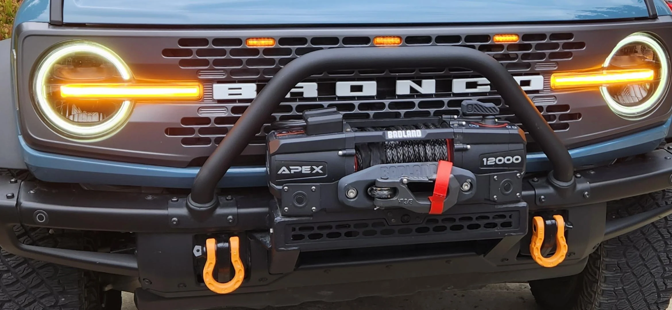

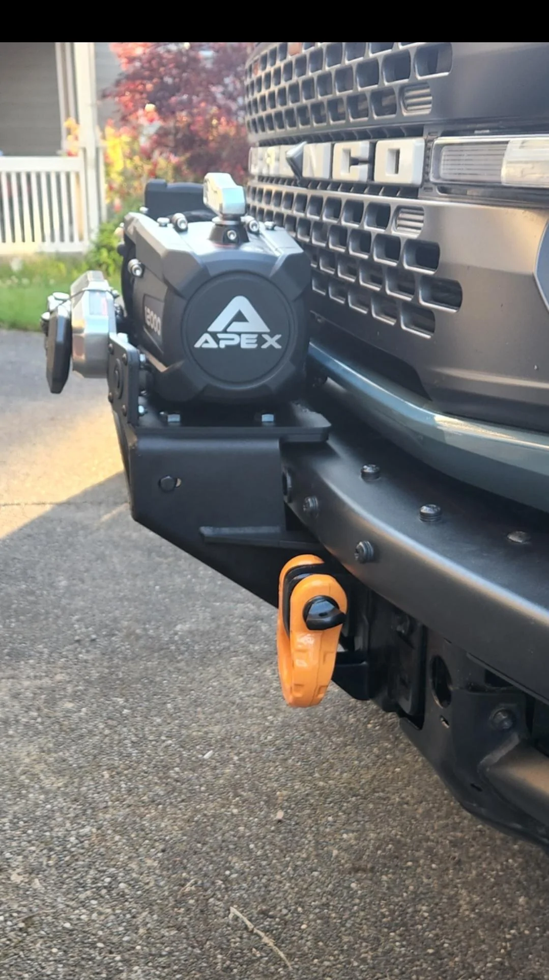

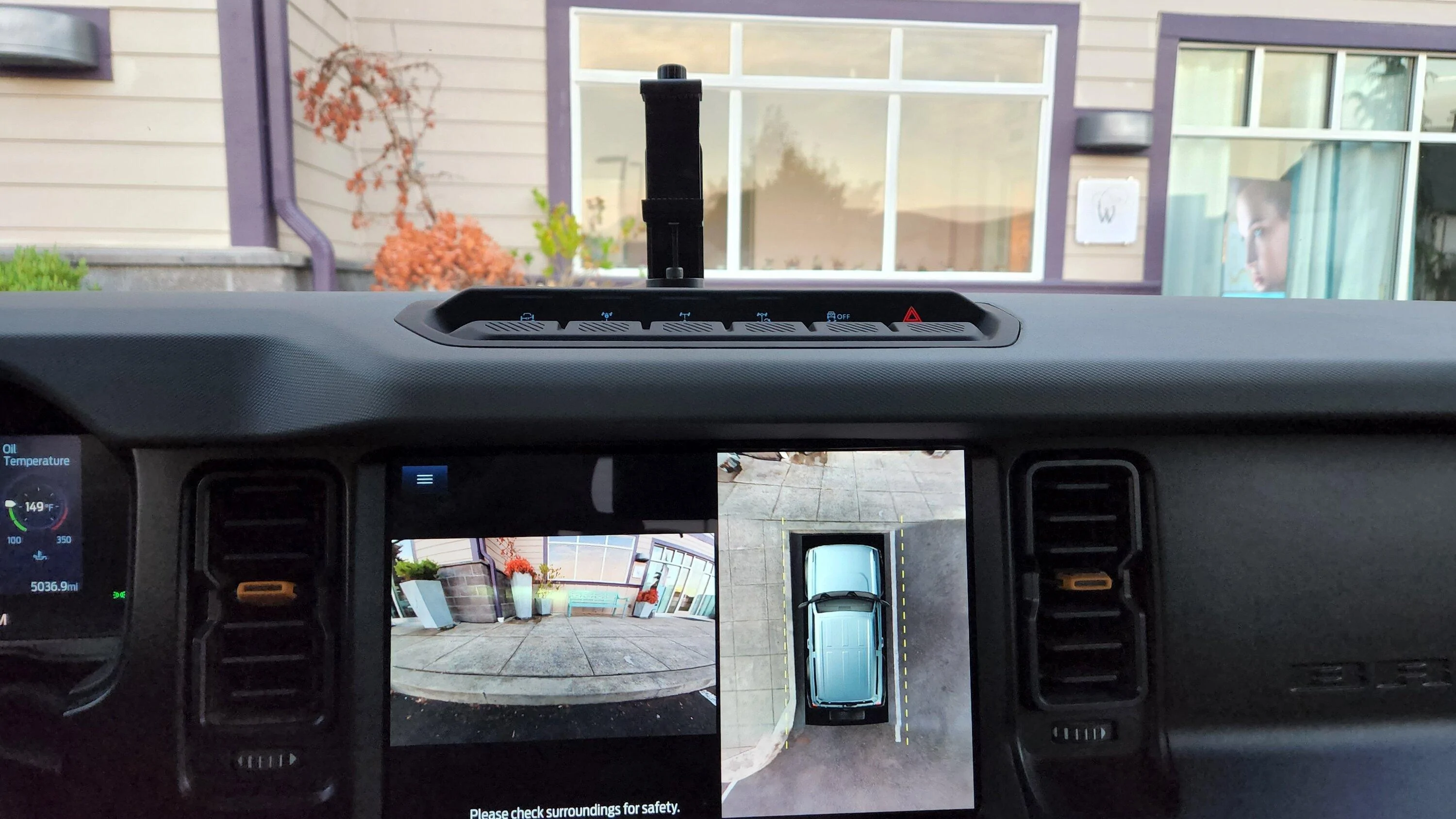

I fabbed up the bracket to relocate the camera (removing the "RC" with a dremel tool). Made a separate top plate to "sandwich' the mount with the rear bracket.
The video feed from the new location works great. Did some beer math geometry and figured adjusting the look angle to 30° corrected for the change in height.

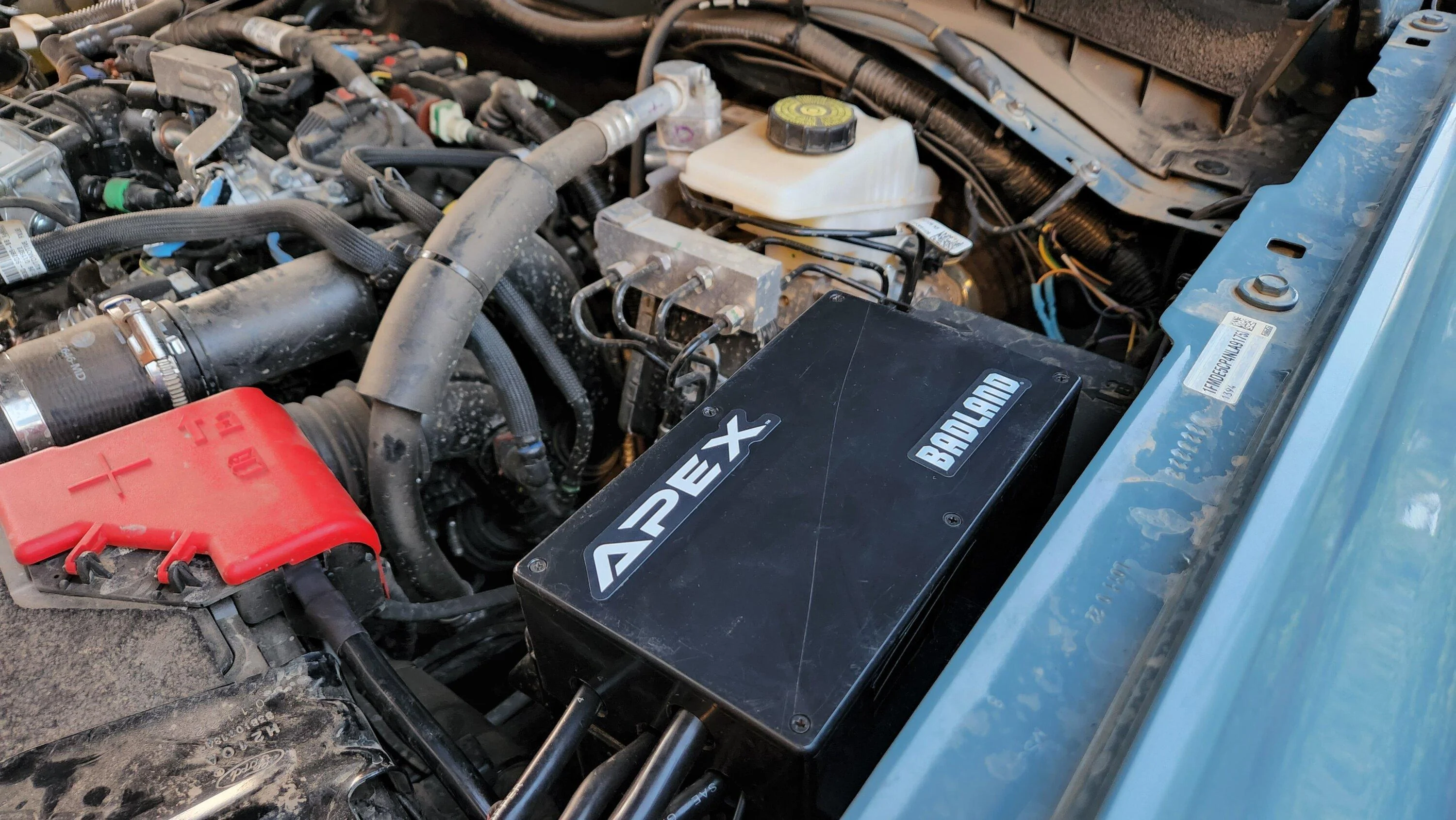

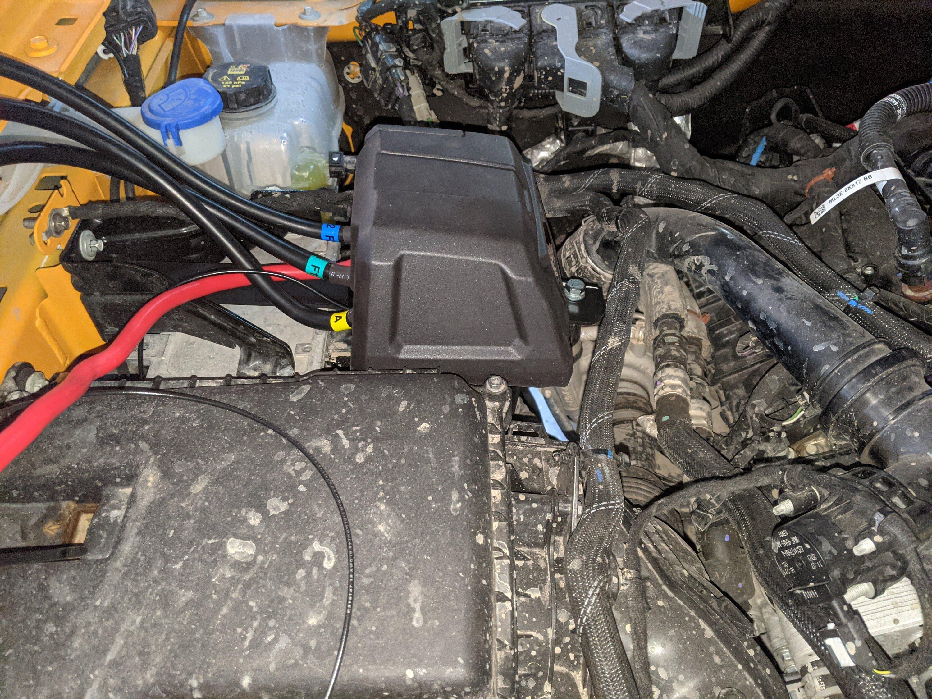

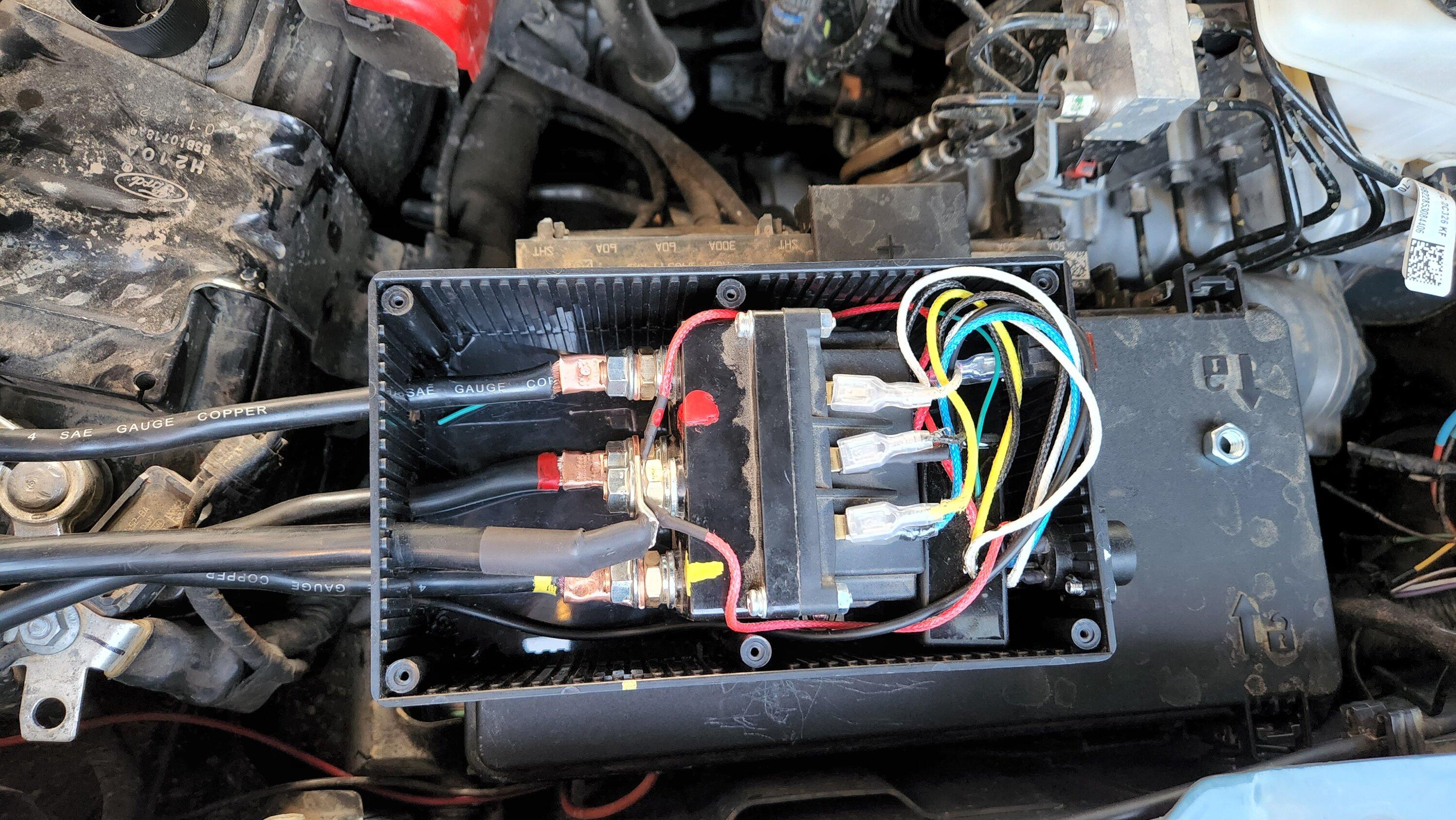

Also relocated the control box guts to a weatherproof project box under the hood.
Also fabbed up some brackets to snug in some 4" spots inside the OEM brush guard and coated the brightwork on the engagement lever and fairlead with a durable undercoating.
It was a little work to get it all sorted the way I wanted it, but I'm really happy with it.

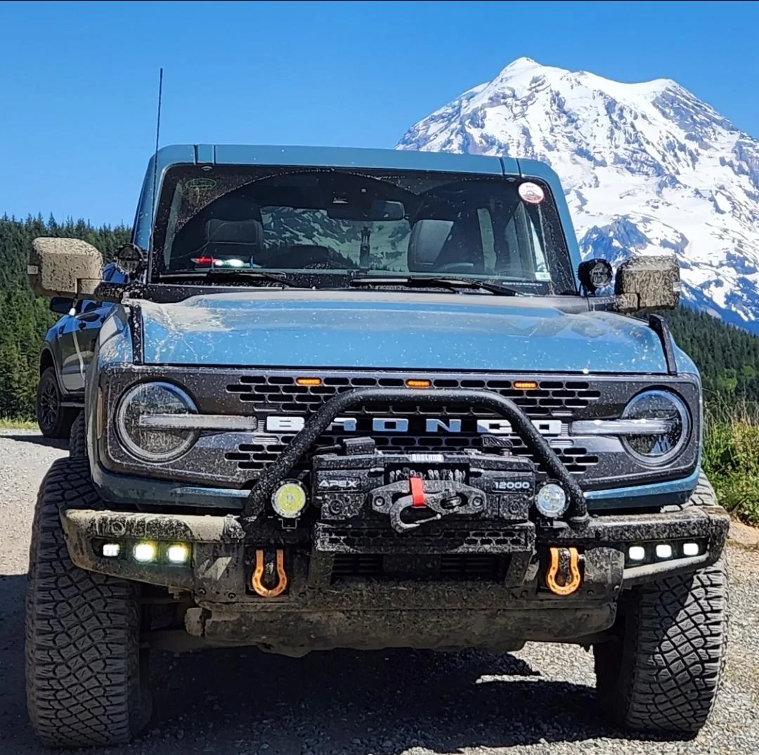

I recognized that mountain right away - beautiful shot! Where exactly was this taken from?
And nice winch setup. I think I may do the same thing. The hidden winch looks like a bear to install, and many others protrude way too far forward for my liking (and garage geometry). I like that this is nice and snug to the bumper and doesn’t interfere with hardware too much besides the camera.

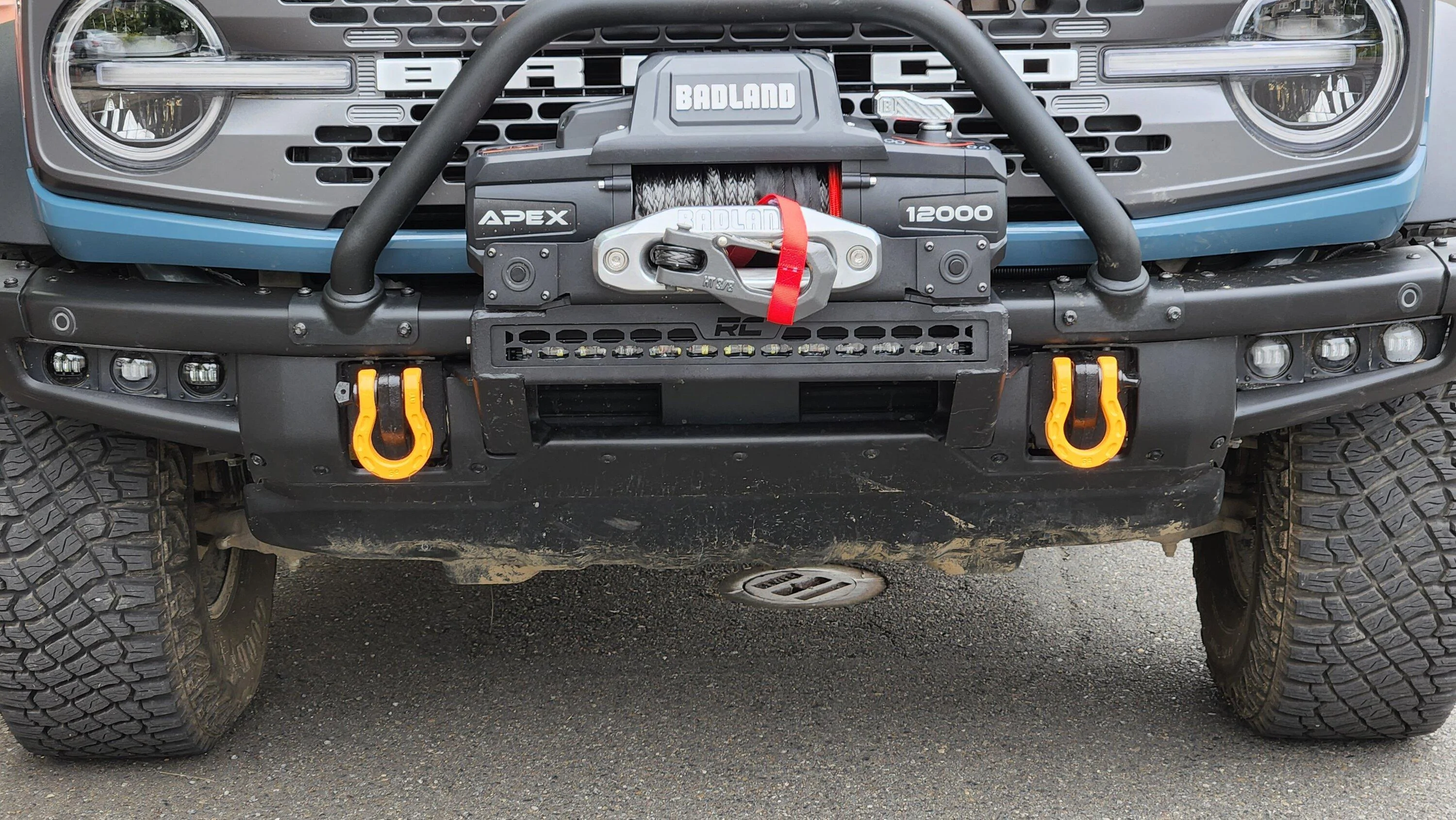

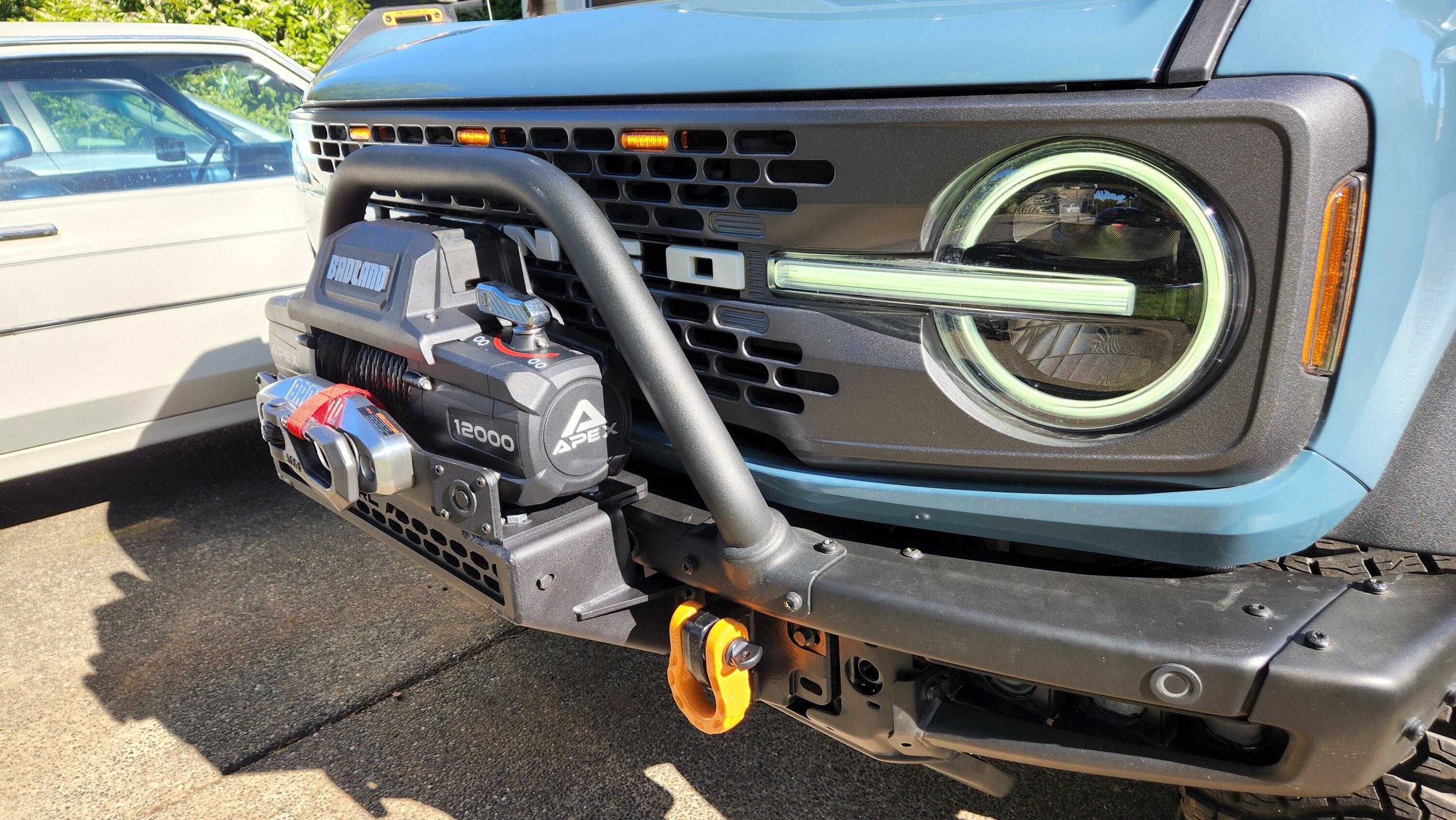

I've got the RC Winch mount as well and did the same box relocation as @66GT .
Ford Bronco Winch setup For Modular HD Bumper? Screen Shot 2023-12-15 at 12.32.28 PM
I was worried about losing approach angle but it's well tucked back. I haven't had to pull anything with it, but I'll probably add @Tricky Mike 's frame horn upgrades just in case.

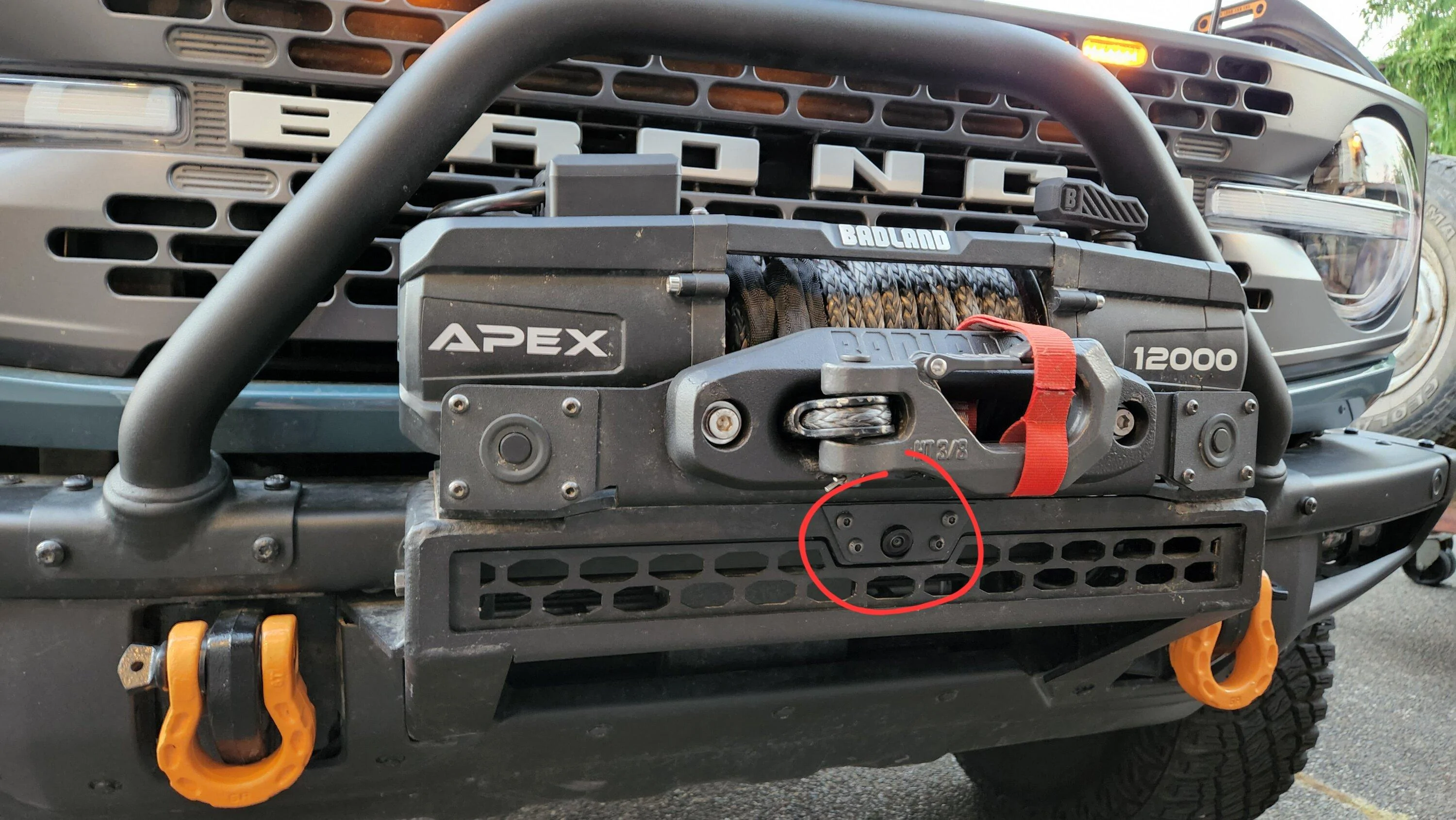

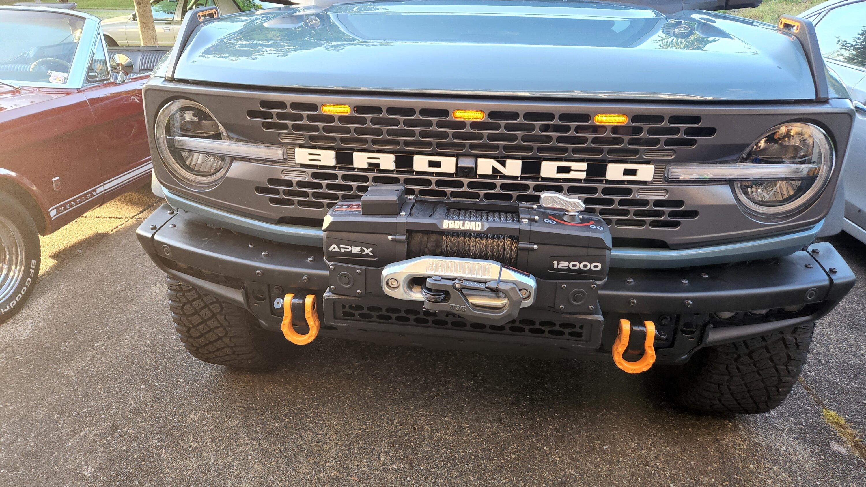

I run the RC high-mount with a Badland Apex 12k (with the control box relocated under the hood).
It mounts on top of the mod bumper... and is set back towards the grille to preserve the approach angle.
Fabbed up a bracket and faceplate to relocate the camera underneath the winch... works just fine with all the lux pkg stuff... including ACC and parking sensors.
Have no doubts about its strength... have used it to recover a Tacoma with 33s that was almost tire-deep in muck.
So far your install looks the best to me when using the factory mod bumper. I think this is the route I will be taking as I have the Badlands Apex as well.
I might just leave the camera be as seeing a little of the winch is not a big deal to me , but one question since I do like your camera solution as well . In the factory location up high in the grill you get a great view over the top of a crest as the camera is looking downward from higher up. In your position does the camera tend to point to the sky when cresting a hill or is it still looking "over " the hill ?

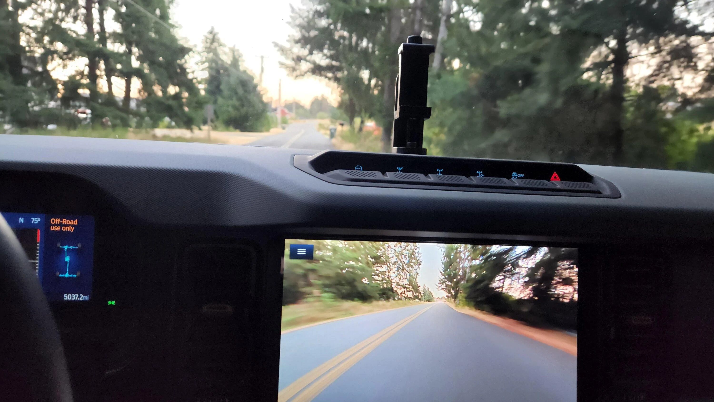

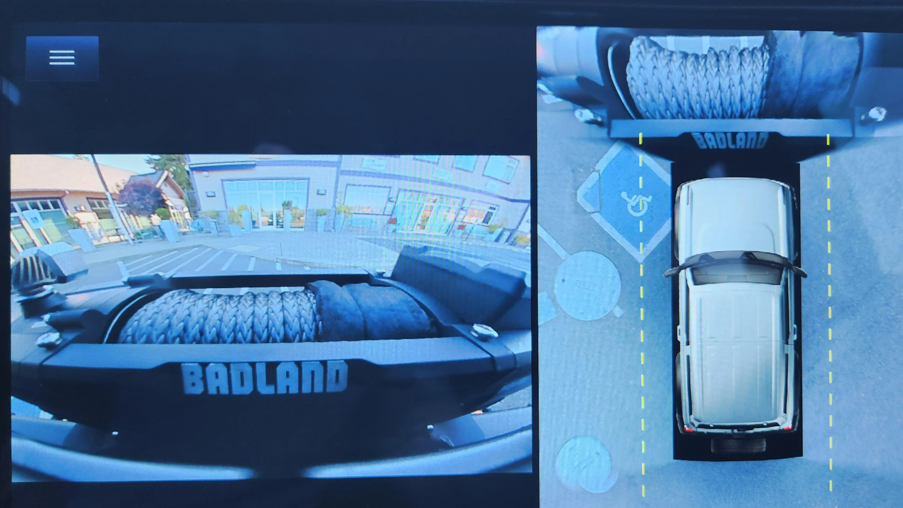

Thanks. I've had no issues with the alignment of the camera since I relocated it. I used a broomstick to figure out the "aim point" from the stock location, which I think came to about 5.5 feet in front of the bumper. When I measured it for installation in the new position, I aimed it at the same distance.
You can't tell a difference from the factory location in practical use. The only distortion I tend to experience is that in the overhead 360° view, the edges of the front camera don't quite line up crisply with the sides.
As it turns out, in this location, the horizon line is in the middle of the screen and bottom edge of the screen is looking at the ground right beneath the bumper, so when I ran this setup at Moab, I had zero issues with 'seeing sky' when cresting a ridge. On fact, it was actually a huge help rock crawling because I could see obstacles all the way to the point where my bumper was passing over them.
With the control box on top, you can see it just stared into the back of it.

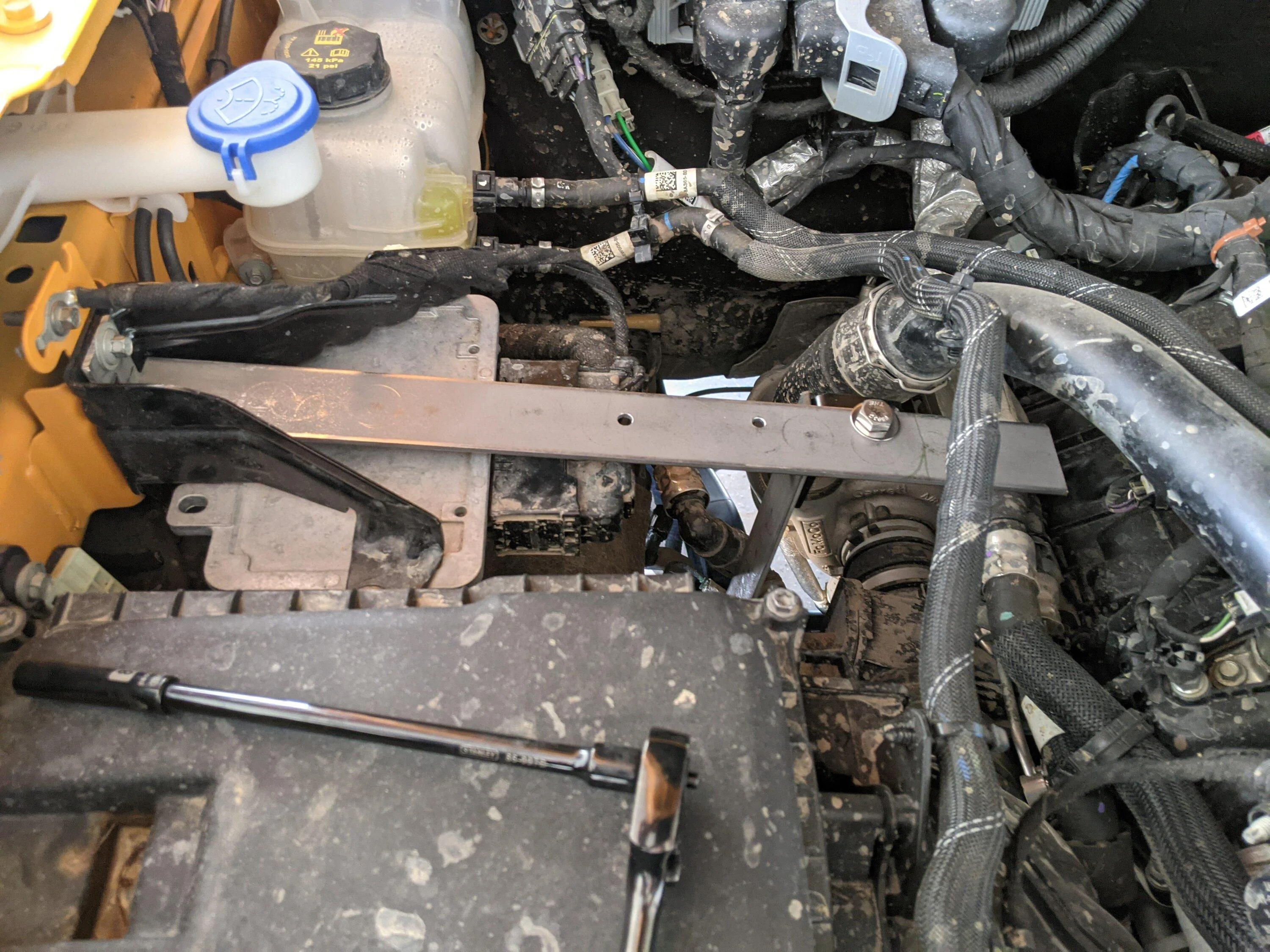

For the control box relocation, the one that comes with the winch is too big. It looks like you bought a separate box and transferred? Which box and how did you mount that box? It look like it’s on top of the fuse box.
And then the power cables would be too short, so I assume you found longer ones to replace them?

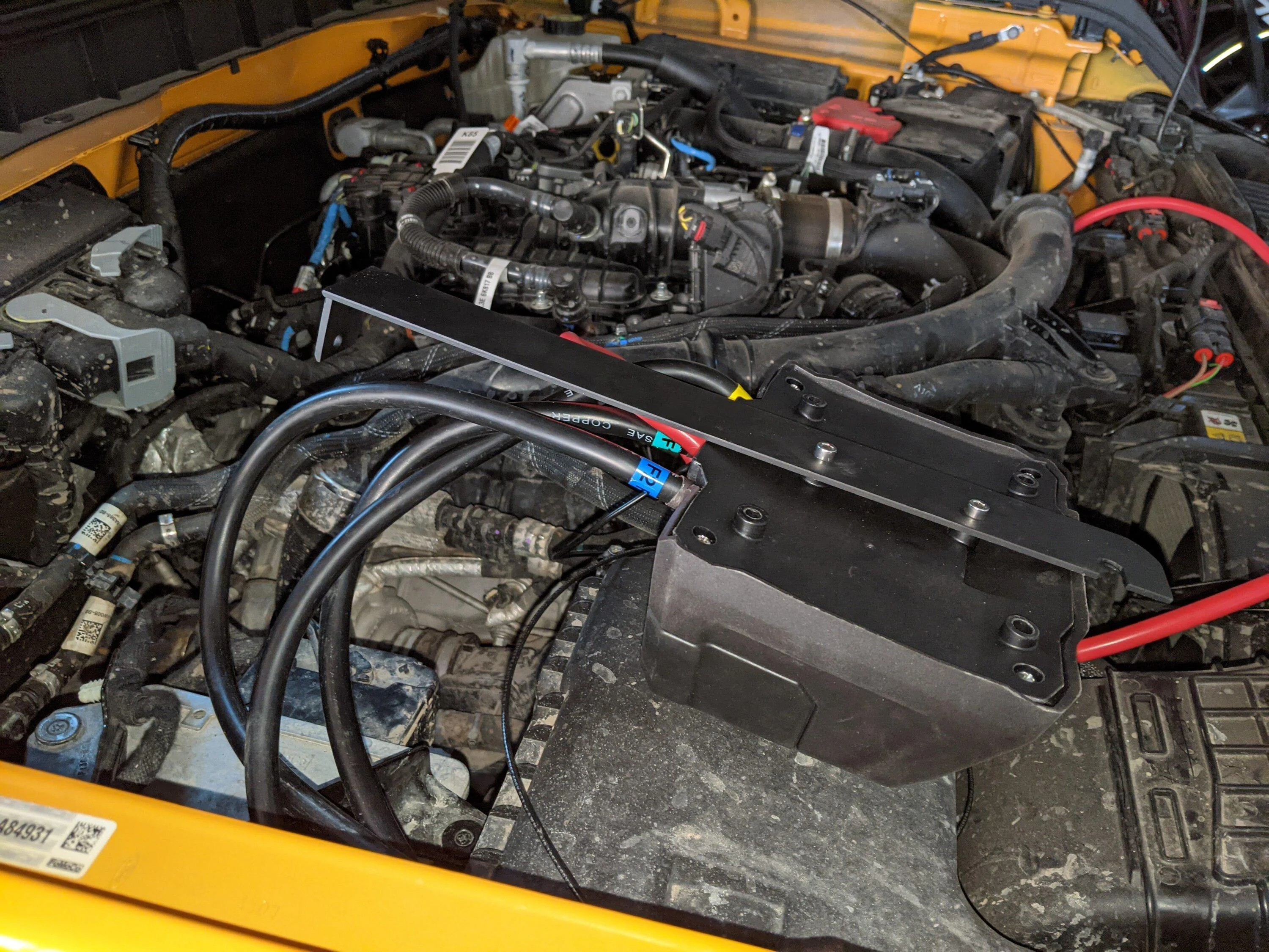

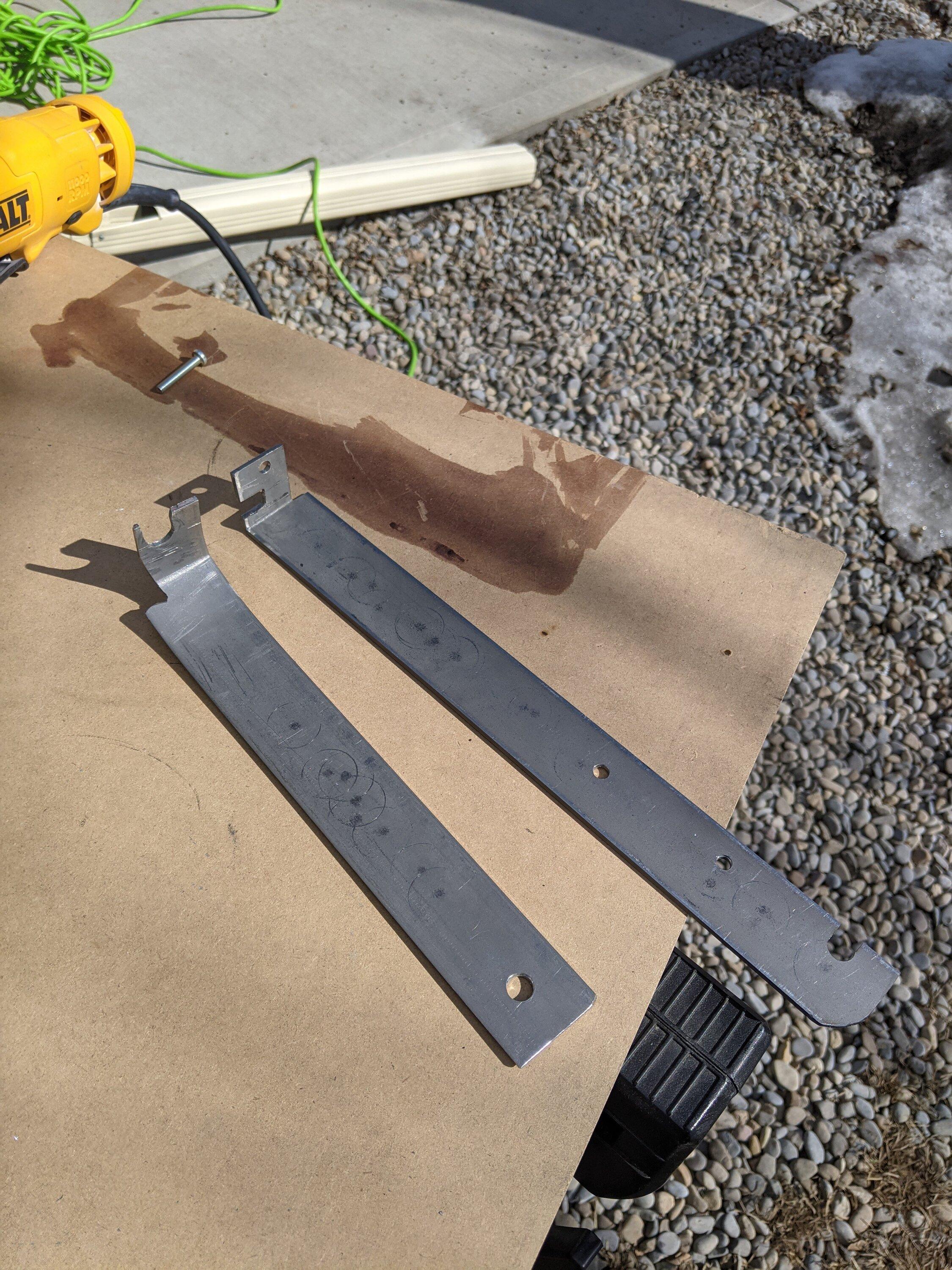

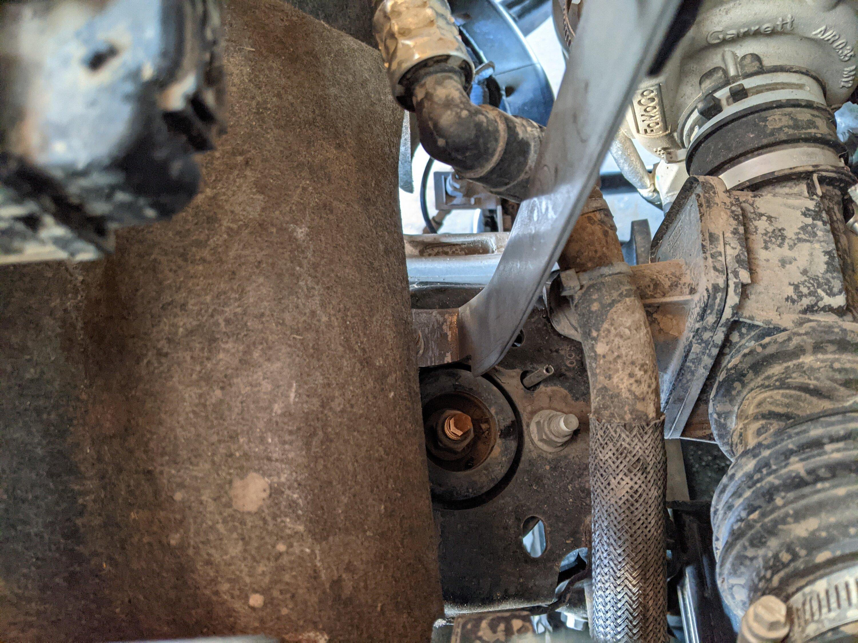

Extension cables can be found from Warn, or really anywhere that sells the proper cable gauge for your specific winch.
And for the relocation, it's easiest to make your own bracket. I took 2 thin flat pieces of steel, a little bend and drilled some mounting holes. Finished it off with some matte black spray paint.
And I'm brutal at mechanic stuff. It takes me probably 5x longer than any normal human, and I still managed to get this done. When I say "If I can do it, anyone can" I truly mean it.
yes... I just used a small project box and bought 3x 20' 4 gauge cables.
Apologies for the question but I want to be sure I understand. Is it safe to say the relocation isn’t necessary since you ultimately decided to relocate the camera below as the best solution?
Yes... but...
... that control box was sooo huge... and with it mounted on the winch... and along with the OEM brush guard, it blocked so much of the grille area that I'm glad I did it anyway. It was enough for me to worry I might have cooling issues.
This was before I relocated the camera.

Wow that angle looks great. How are you able to view your camera while driving with speed? My camera clicks off almost as soon as I start moving. Thanks!
I just used a broomstick to see where the spot on the ground where the camera was aimed... and then I figured out the new angle by aiming the camera at the same spot from the new mounting location on the winch plate. Pretty simple.
For for the driving vid, I went out to verify the camera angle for Baja mode, where the camera stays on at speed. I made sure to do it on a straight road where making turns on pavement wasn't going to mess with the 4x4. I would never recommend using it on a paved road in normal driving conditions.
Ahh makes sense. Good thinking on the relo and how to demonstrate the result. Thanks for sharing.
