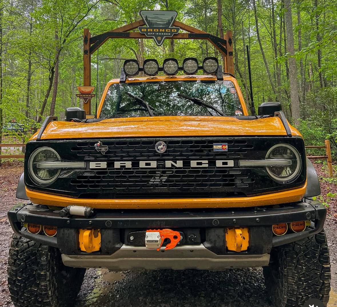

I’m looking at hidden winch options that bolt into the modular bumper. The only one I’ve seen is the Rough Country one but I thought there were others out there. This looks like a good option but I’m not super stoked to be cutting into the frame.
I’ve got a 2.3L 7MT for what it’s worth.
Does the Rough Country require cutting into the frame? This one doesn’t require any cutting. Only thing is you have to get a high mount inner cooler. Other than that it’s straight forward install.

Both the RC and Lobo require cutting off the frame extensions which are only used during the manufacturing stage. Both allow full size winches, but might require a control box/solenoid relocation depending on the winch. Also access to the free spool is limited and can require a specialized solution. There Hammerbuilt uses a special reduced width (shorter spool) winch. For me, with a 2.3L, I am probably going with the Lobo. I bought a Warn Zeon Platinum on sale and it is fully wireless.
