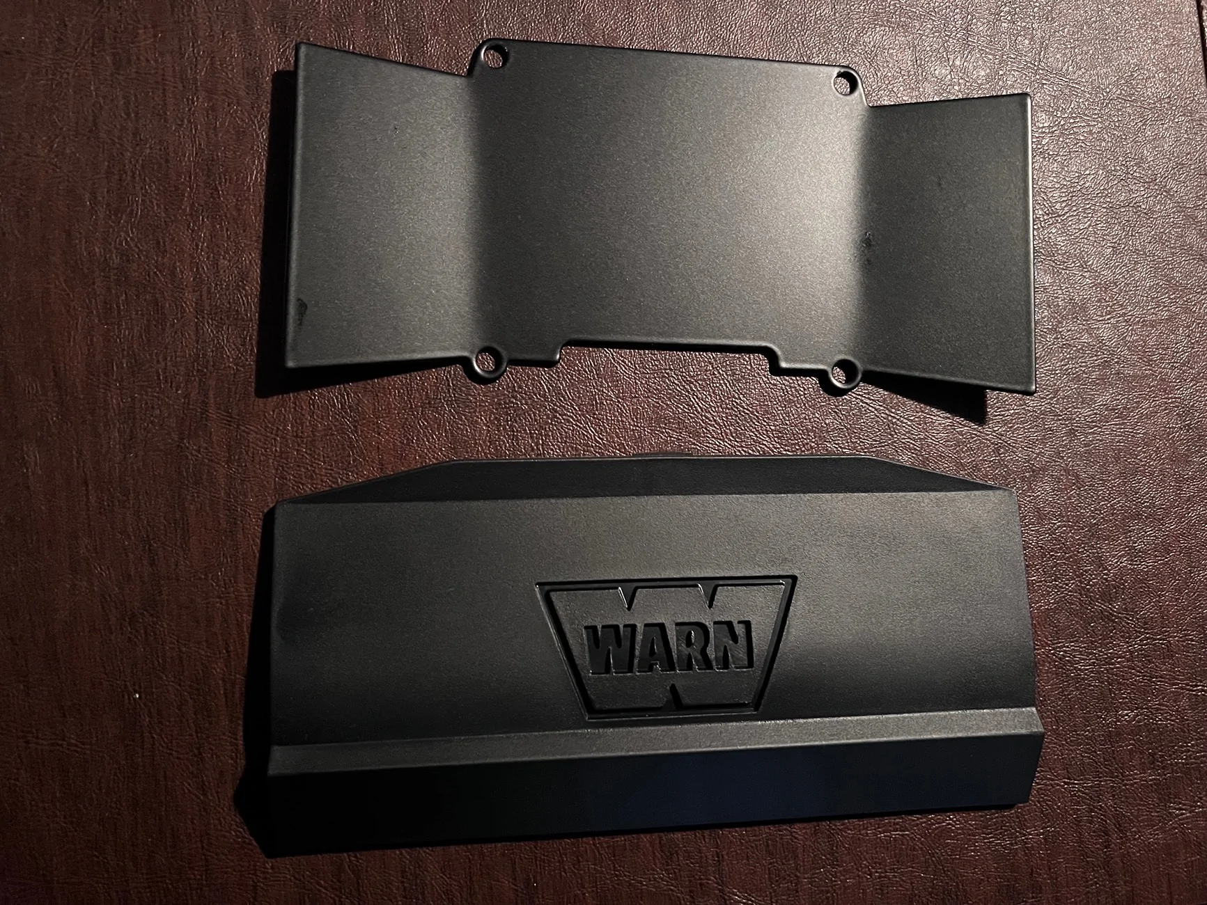

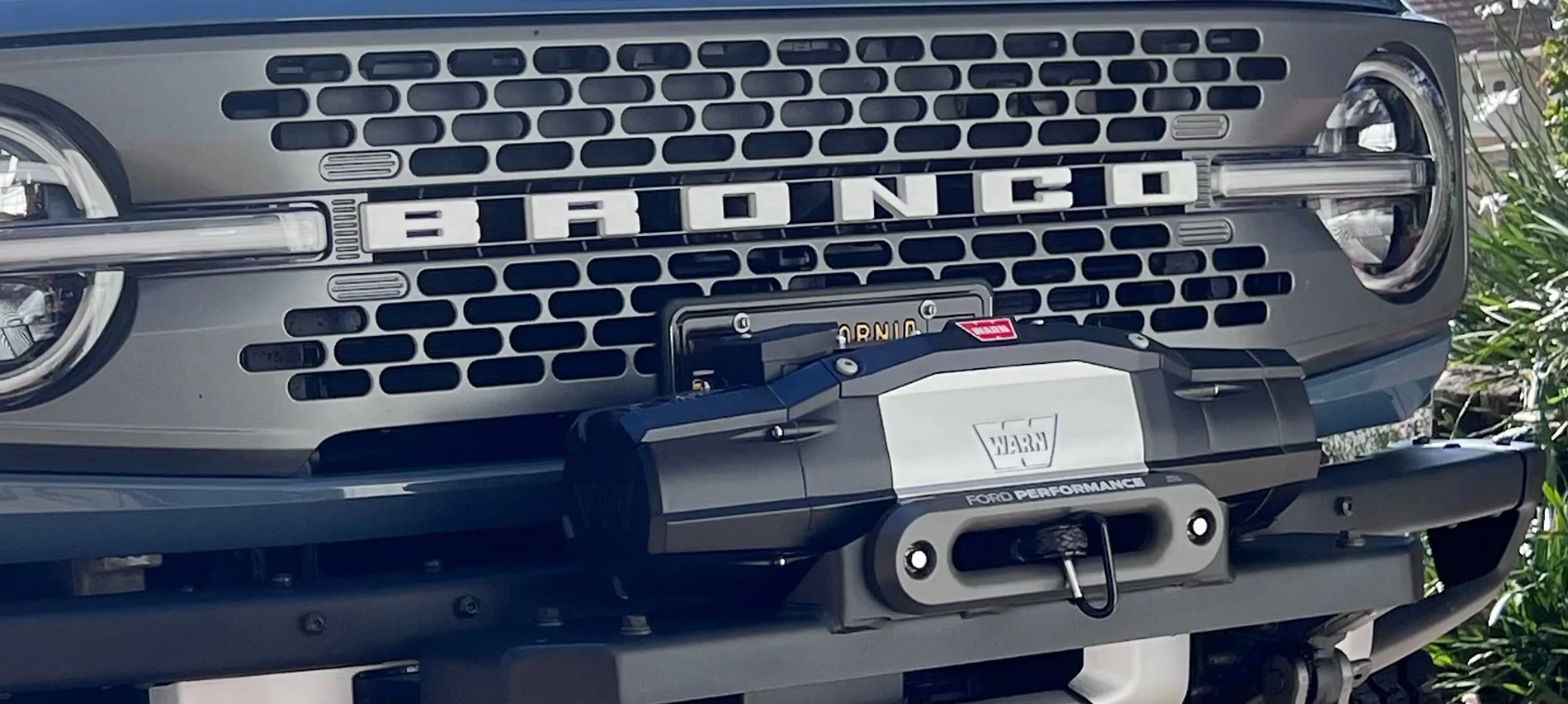

Like you I’m in Cali so sun can bake a winch synthetic line… Warn has nice filler piece for the front, sorry don’t still have the part number.
It’s held in by tabs on cover to pockets in the winch.
I’m just using a 500amp switch, but also moving the controller under the hood.
covers top is one to replace controller box, bottom is front cover for synthetic cable.

Where did the front and top cover come from? I relocated the controller on my VR Evo 10s winch and would like to better protect the rope from the elements.
... reason I did mine... but Sloth not sure I can help you my winch is the ZEON 10S... i was going to make them but after a search on relocation of control box a Jeep Site showed them both.
Warm sold the front cover in two version solid and vented but stopped selling them
Innovative AT Products make the top cover but only for All WARN ZEON™ and ZEON Platinum Series Winches
