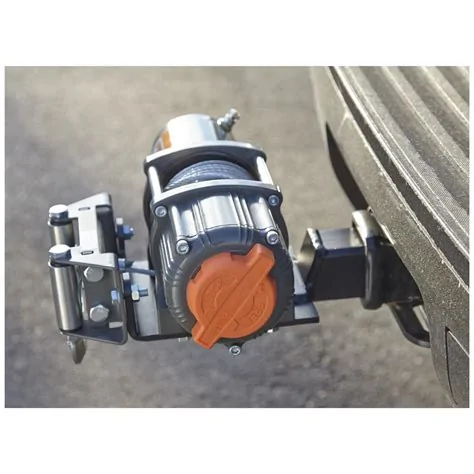

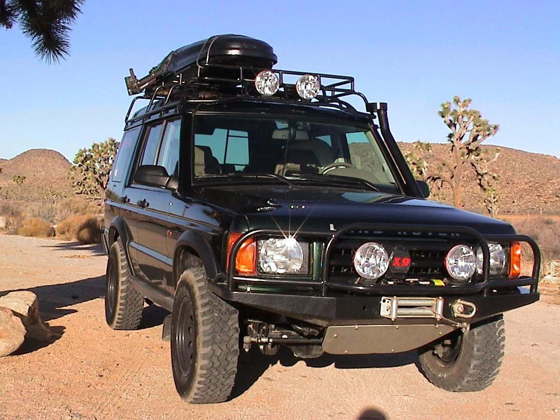

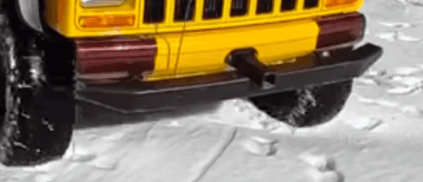

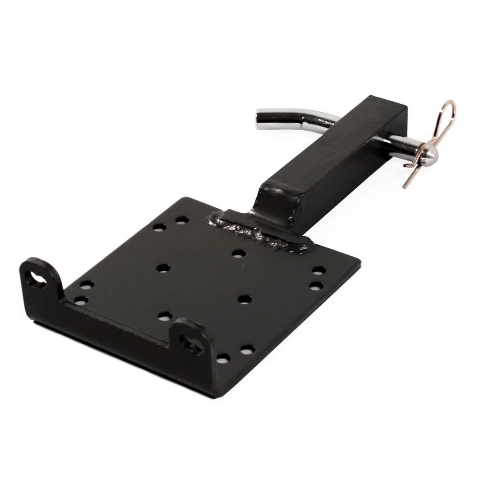

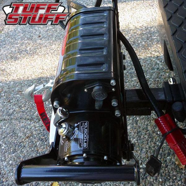

I would like to not worry about interfering with trail or 360 road cameras or even carrying around the weight and extended bumper for parking lots. A nice simple receiver hitch integrated into the FRONT bumper would be optimum. Anytime I am on the road I can get out using another vehicle (usually around to help) and mainly used the winch to get myself out of trouble when I was alone, always carried a pull pal (land anchor) which is money in the desert without any trees around. Would put in quick power disconnects and throw it in the back when I hit the trails, otherwise have a mean looking bumper loaded with LEDs...
The winch on the front was alway a problem (my green LR Disco II clean just before taking onto Joshua tree) if you need to reverse to get out of trashing something. Receiver mounted winch on front and/or back was always better and pick any winch you want to use. The looks of a front winch, is agreed, meaner but 90% of then I see still have the factory cable perfectly wound around the drum... mall crawler.
