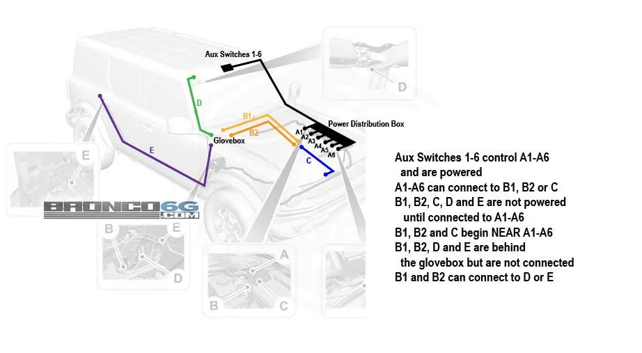

the Bronco has pre-run wiring (even without the factory Aux Switches) that can be used for this.
Where is this, so I can talk with my installer about this option? Thanks

Are the enough to run a light if I decide add one to each spot by mirror?
Depending on the light - yeah most likely. Most LED lights no problem.
the B-E wires are all 16ga, so probably don't run lights that cross 10 amps off of those. i think we're all scratching our head as to why the one at the roof line wasn't 14ga and directly home run
the aux wires however are gauges that match their amperage
Yup.
Most LED lights don't come close to that though.
Just an example - if you wanted a Diode Dynamics SS3 Max (one of the brighter ditch lights you can get - I just happened to have a spec sheet for it). Those are 3A each. As a ditch light setup, you might run them both off the same switch, so 6A total. Well under 10A.
http://images.diodedynamics.com/doc...Stage_Series_3in_Worklight_Pod_Info_Guide.pdf
If you wanted a laser light, like the BDXL, those are 6.5A each - so there you may run into issues trying to run a pair. Same with old school halogens. Similarly with an entire light bar -- it all just comes back to amps.
I totally agree about the D wire, I don't know why they ran a 16ga up to the roof - makes no sense, can't run much of a light bar off that.
