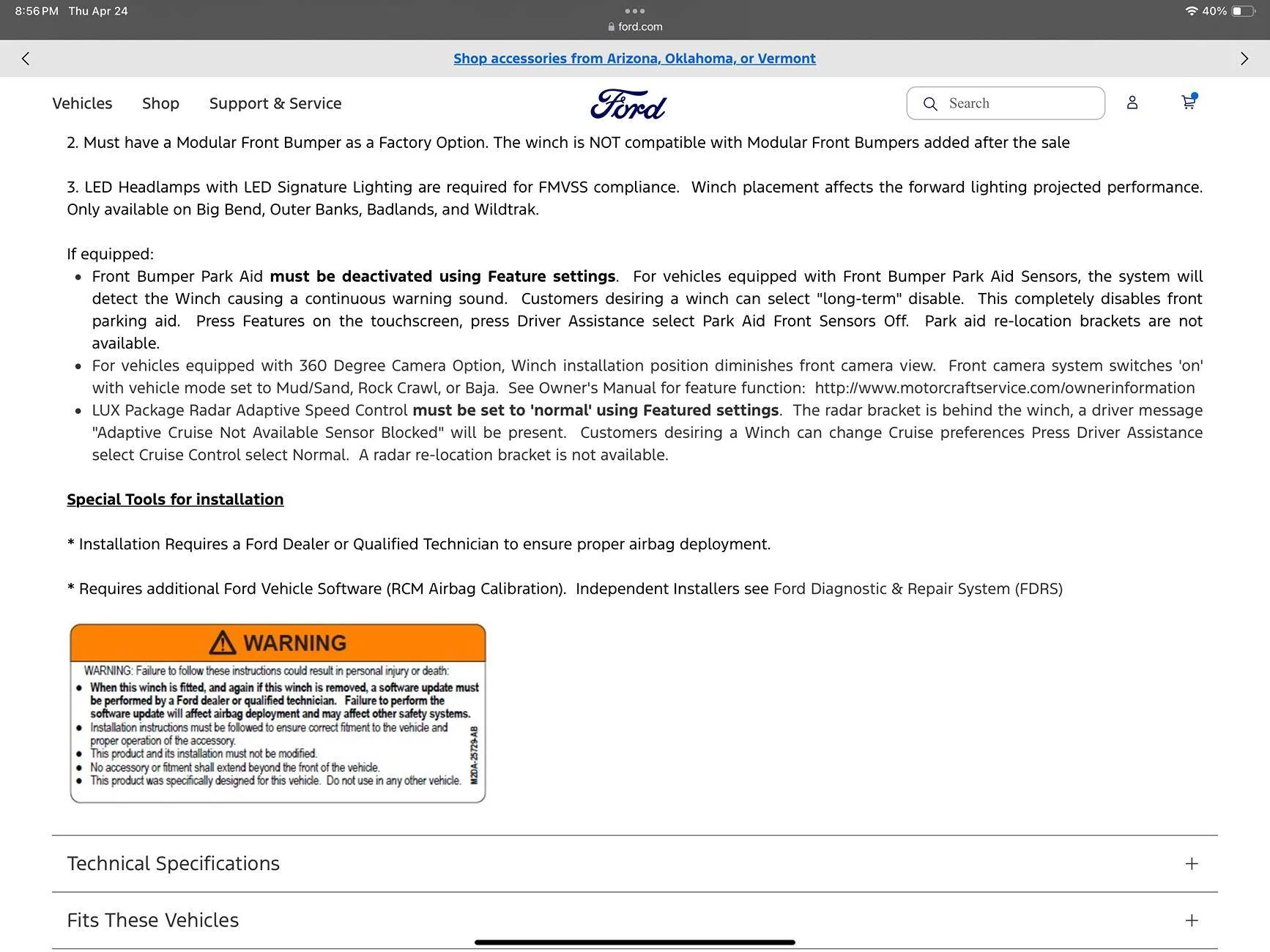

So just to confirm, those who have bought OEM set up. The comments below about disabling ACC and parking sensors is NOT needed. And if installed by the dealer and they set the settings to disable them its just a matter of going into the settings and adjusting back?

With the OEM setup? No modifications needed? I read they had to disable those and the parking sensors?
They disable the parking sensors because the factory mount doesn't have provisions for the sensors. 1-1/8" step drill solves that easily!

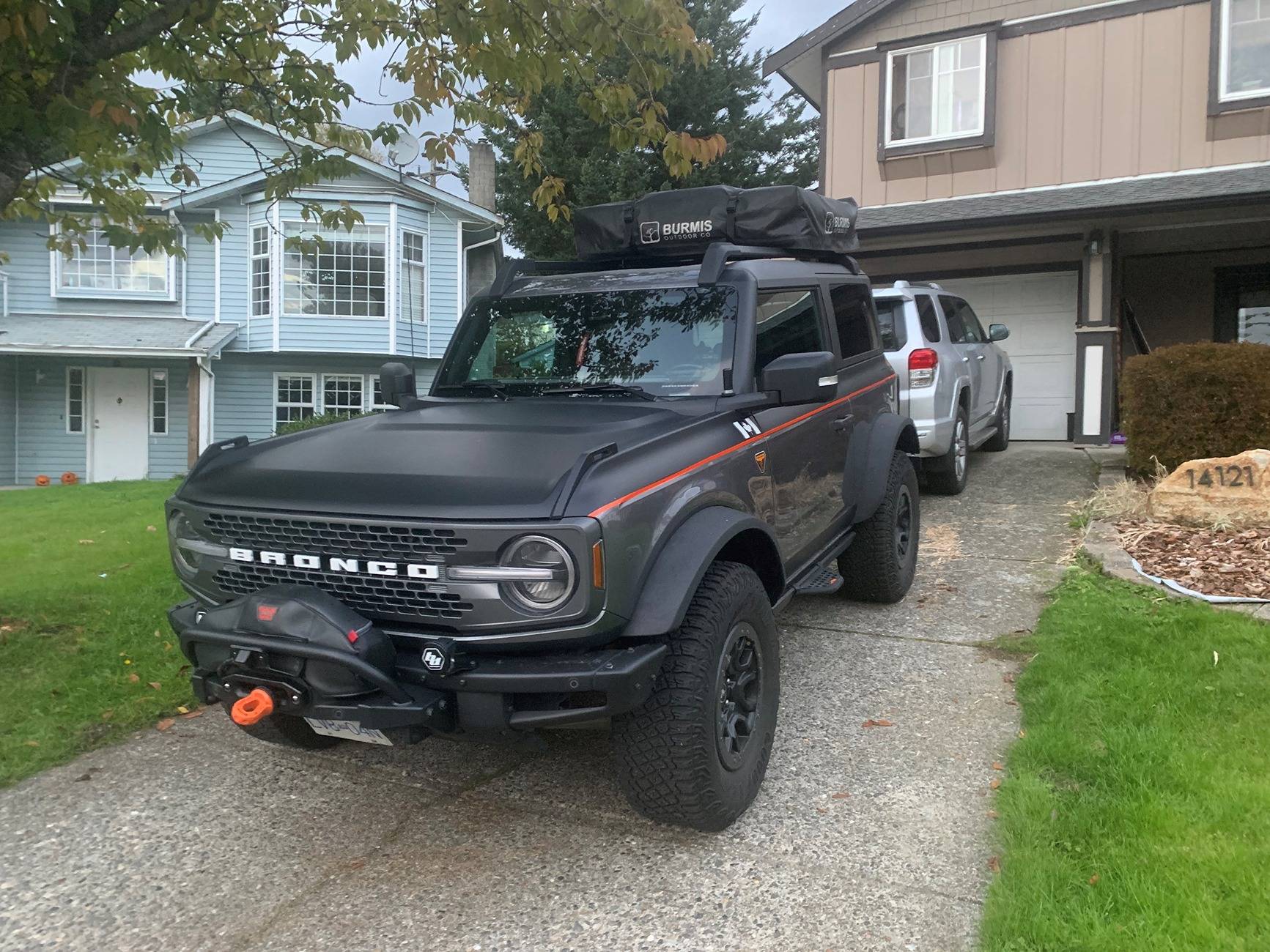

I wanted light and functional...I went with a Chinese OEM copy from Amazon and Winch from Facebook Marketplace...$1300 Canadian, so about $50US! lol

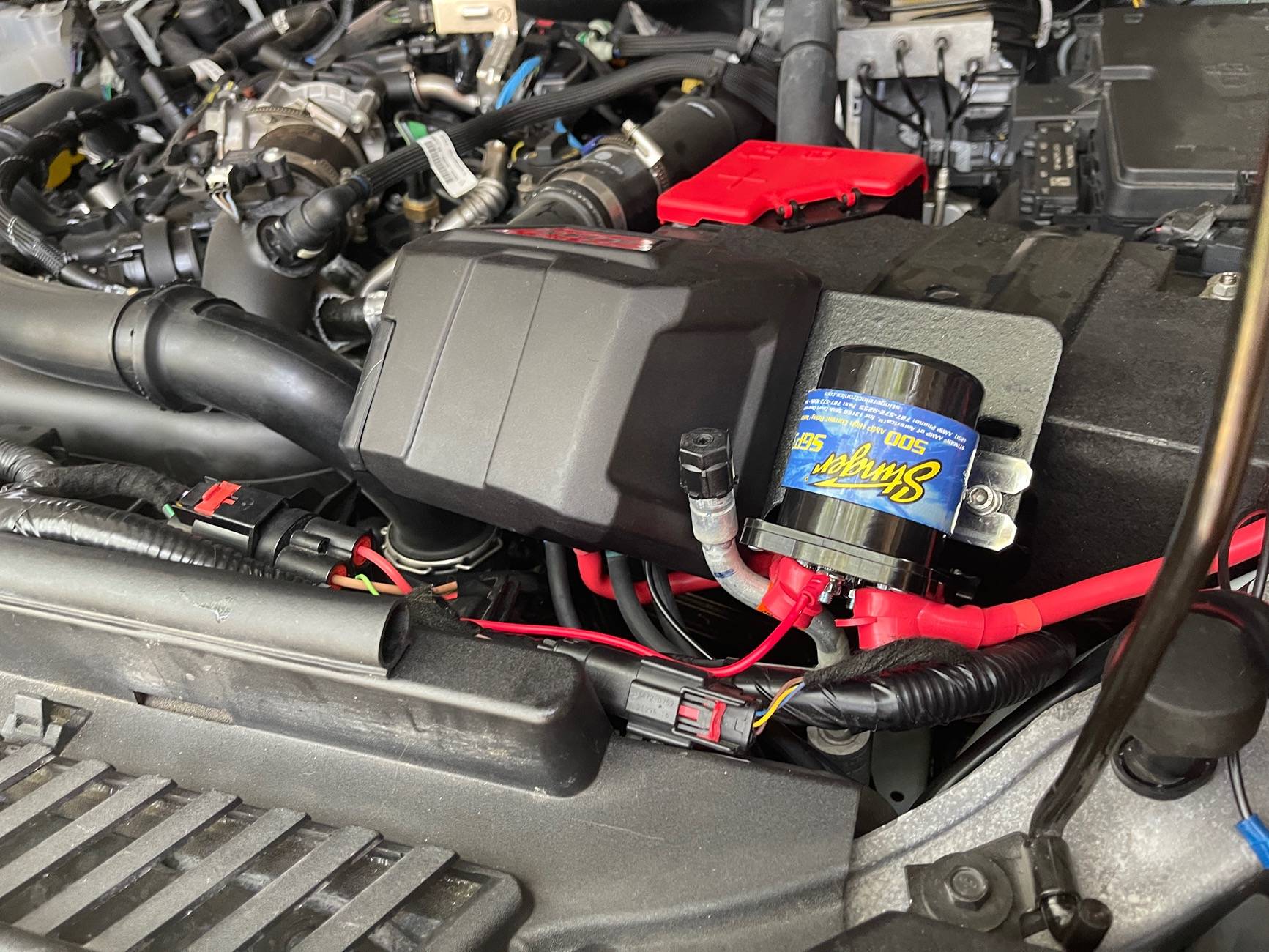

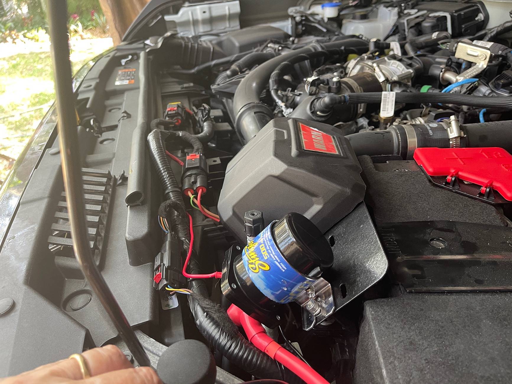

I used the BAMF relocation kit and bracket in front of battery. I mounted the isolator lower using new holes and rivnuts. Control box is mounted upside down. I connected isolator to unused aux lead directly in front of that area to Aux 3 switch. My hood has insulation panel so not as much space, a tight fit.
Cool. Thank you. Installing the Maximus 3 kit this weekend and want to do this.
