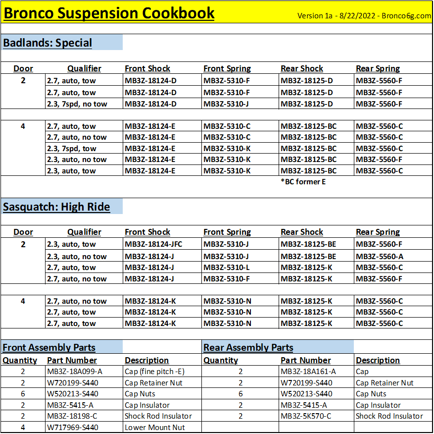

Looks like what I am needing to buy is the following.
I am planning to ask my Ford dealer to get me a quote on the parts.
I do have a wholesale part account with them, so prices should be a little under retail prices.
Needed parts list.
2-Door HOSS 3.0
  • Front
    • Struts: NB3Z-18124-A
    • Springs: NB3Z-5310-C
  • Rear
    • Struts: NB3Z-18125-A
    • Springs: NB3Z-5560-B
I have a high spec 2dr Badlands SAS with 2.7L and Tow pkg.
Would those part numbers be correct?
CC1999
Feb 15, 2023
254
522
KS/OK
2023 Bronco, 2021 RAM TRX, 2023 GMC Denali HD
No idea if this is accurate but look at the 4-doors the Badlands non-sas, and 2-door Sas Broncos with the 2.3 Engines, they show different rear springs with the tow package.
The Definitive Guide to 2021+ Bronco Ride & Lift Heights with Wheel & Tire Sizes | Bronco6G - 2021+ Ford Bronco & Bronco Raptor Forum, News, Blog & Owners Community
Based on the cookbook here I should have the following springs on my Bronco.
Front = MB3Z-5310-L
Rear = MB3Z-5560-C
If I understand what I am reading in this thread correctly the springs I have now would fit on the Fox HOSS 3.0 shocks.
Is that correct?

The used set of take offs have totally different numbers.
Springs
NB3C-5310-AVB
NB3C-5534-AYB
Shocks
NB3C-18045-KC

Those are the AY springs that I have they work on the 2 or 4 door. The 5534-AV springs are for the broncos with tow pkg so they are a bit stiffer but you are good. If your lucky enough your front springs are 5310-AV but are most likely 5310-AY because of the modular front bumper.
The ones I bought today are AYB and AVB?
Does the B matter, if not then sounds like I have bought the softer 4dr springs which should be ideal for my 2dr if I am following the info in this thread correctly.

How did you know if you got the lighter or the heavier springs with the takeoff set you bought?
The spring code AY is soft and AV is heavy.
Since you have the 2.7 up front you should be ok.
i lucked out and got both AY since i have the 2.3
Springs
NB3C-5310-AVB
NB3C-5534-AYB
Shocks
NB3C-18045-KC
Those are engineering part numbers, here are the corresponding service parts numbers:
NB3C-5310-AVB = NB3Z-5310-C
NB3C-5534-AYB = NB3Z-5560-B
NB3C-18045-KC = NB3Z-18124-B
Aliass24
May 15, 2023
NJ
No, your good to go that’s the softest setup your gonna get from a 4dr with hoss 3.0. They should work well on your 2dr let us know how it works out.

I have run multiple vins on both 2dr and 4dr wildtrak and all the 4drs in the heaviest setups with the heavier modular front bumper run the AY front springs but I have come across a few soft tops with the lighter capable bumper running the AV front springs also a few 2drs running the AV front springs so with that I would say AV’s on the front might be a bit lighter but either way it should be fine. They are the 5310-C springs.
