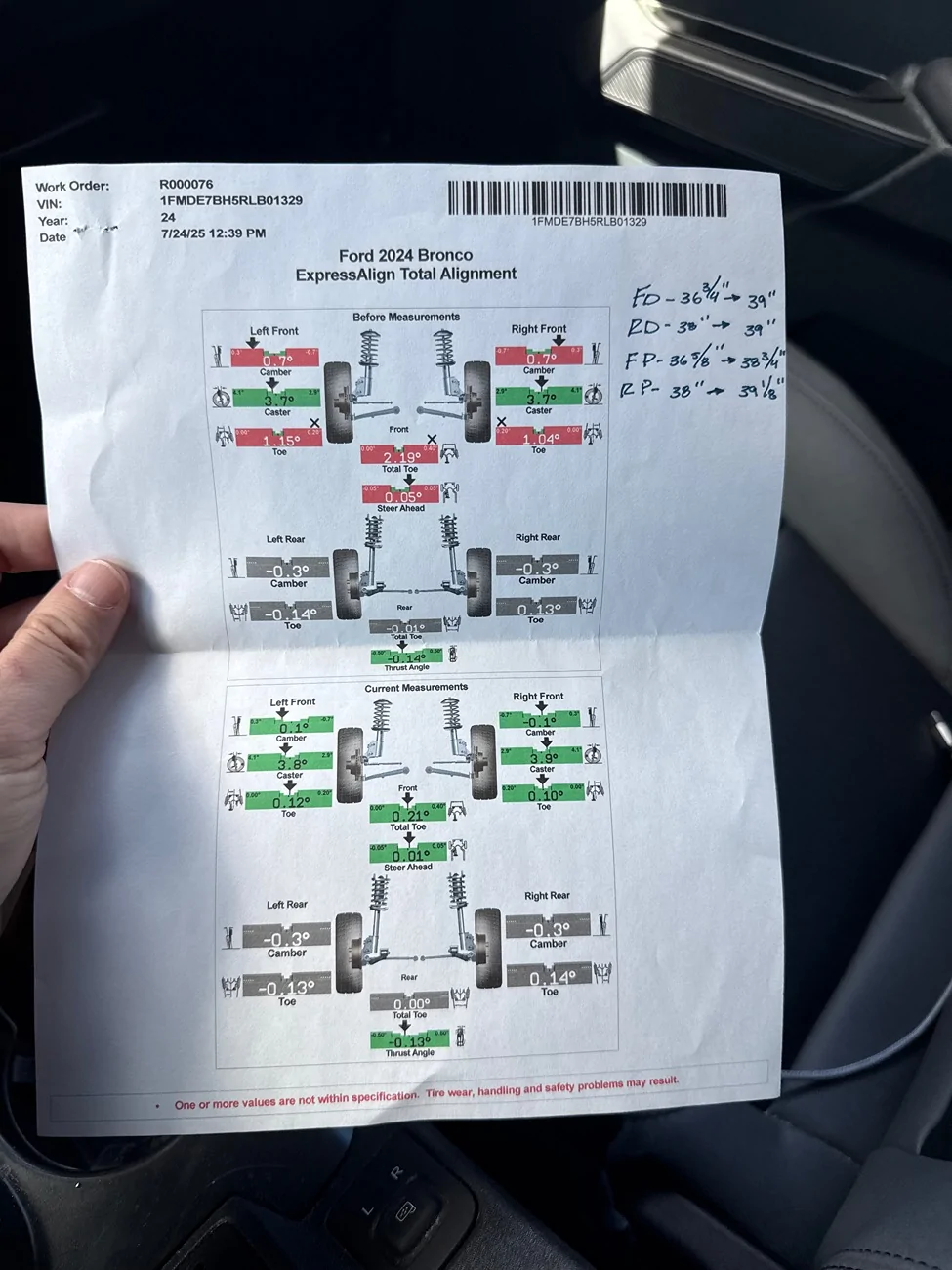

In case you were still wondering. Made the swap. Same spec as you. Awesome upgrade. Had my shop measure the lift those numbers are at the top right. About 2” in the front and 1” in the back. I’m sure it’s settled some since then as well.
