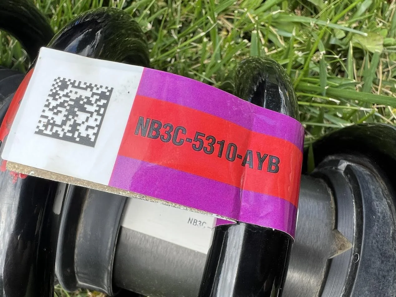

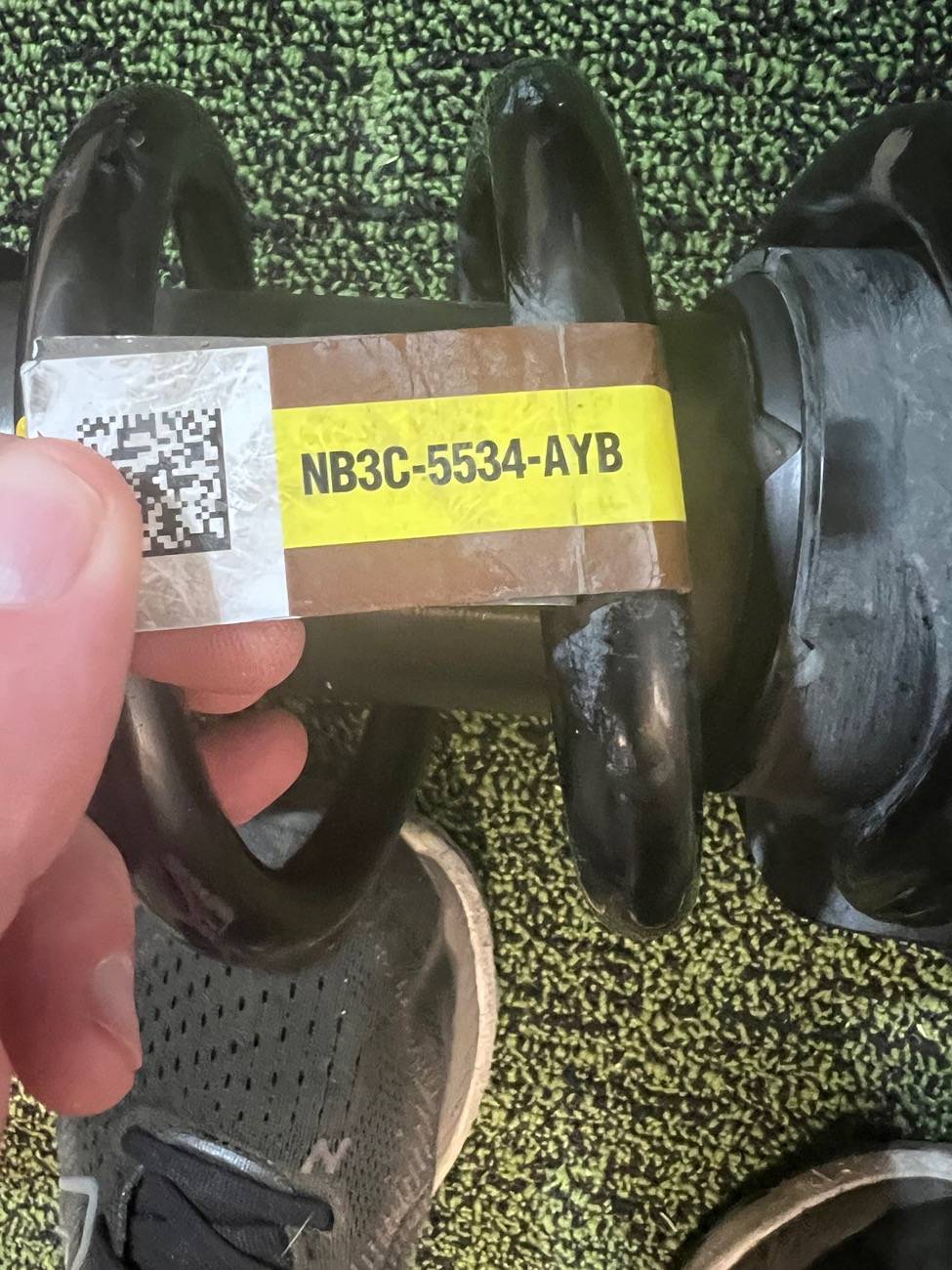

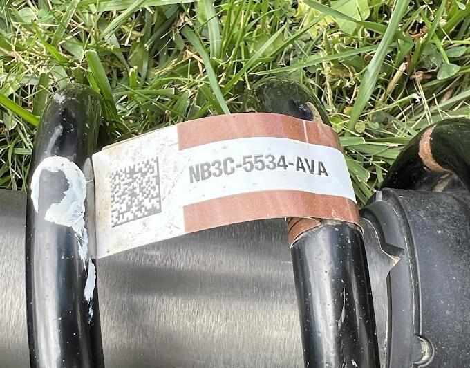

Anyone know what these springs were on originally (2 door or 4 door Wildtrak, with or without modular bumper?):
Fronts: NB3C-5310-AYB
Rears: NB3C-5534-AVA
I found similar codes listed in this thread but not these exactly. They're going on my 4-door Wildtrak with base (not modular) front bumper and a tow hitch.

Not sure why this post is duplicating the 2nd pic - I've tried to delete it 3 times now but it just comes back.
I googled these part numbers and they both return ZERO results...

Those are from a 4 door, bumper makes no difference.

I found @flip 's spreadsheet and found that the Hoss 3.0 has just 1 spring. I have the 4-dr shocks and the spreadsheet doesn't have the front shocks ending in KC, so I assume they are from the 2023 Wildtrak since the spreadsheet shows a date of Nov 2022 on the KB part code.

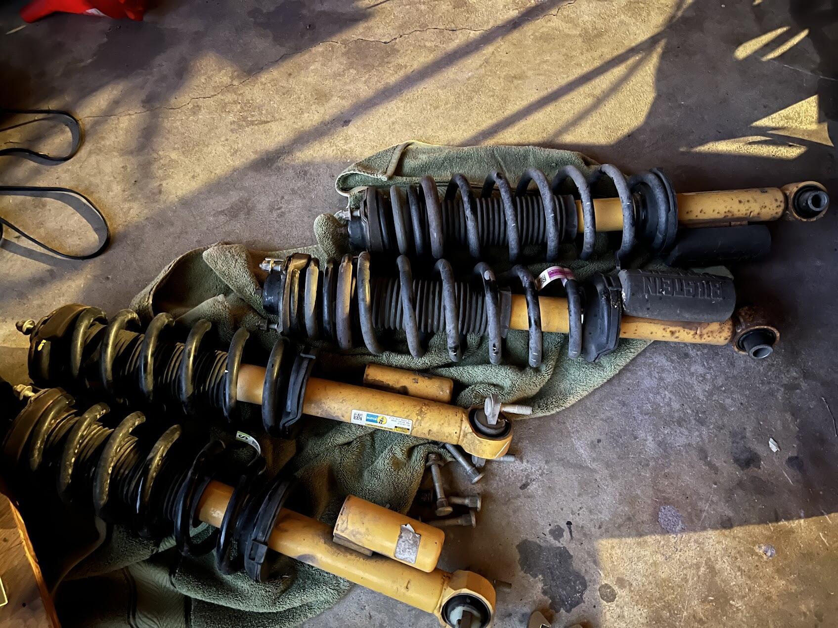

Here's an ugly pic of Hoss 2.0 shocks with 39k Idaho miles on them, going up for sale on FB MP for cheap, I'm thinking $250:

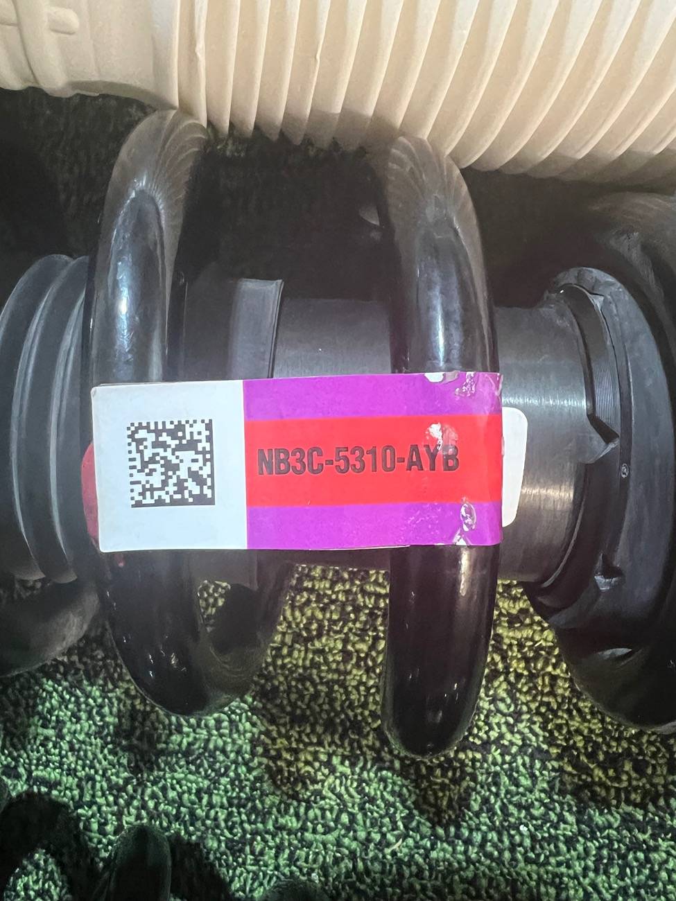

I picked up a low mileage set of these. Does anyone know if they are from a 2 or 4 door and would they work with a 4 door hardtop?

You will need the top hat and shock boot from the bilsteins to swap over. I did all this about a year ago. I also bought 2 new strut nuts.
I was checking out the suspension cookbook and it appears most of the assembly parts are different for HOSS 3.0/Fox?
