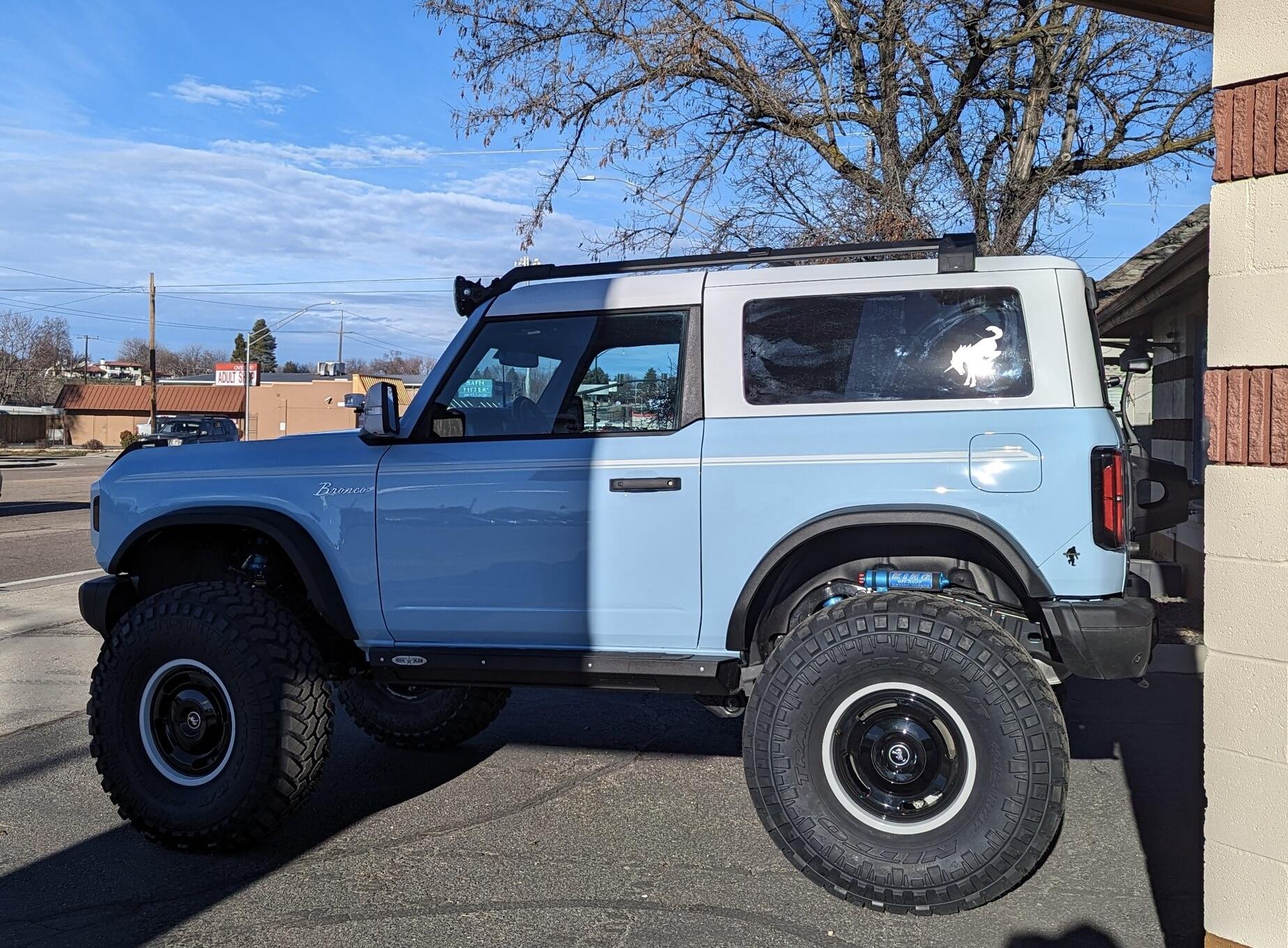

Y’all are lacking vision… @5GENIDN
Ford Bronco Purchase HOSS 3.0 Suspension IMG_7242

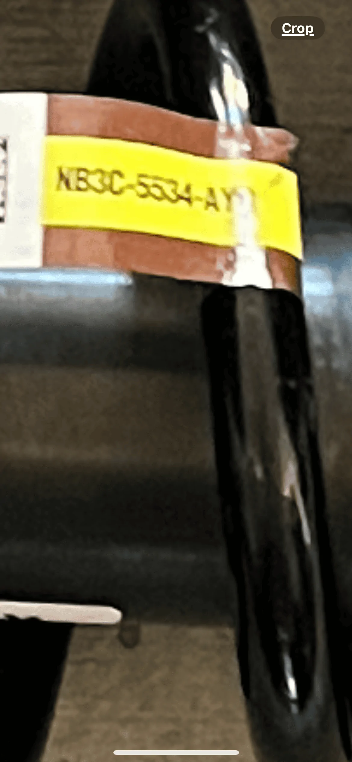

i just bought some Hoss 3.0 take offs and will be swamping them from the Hoss 2.0. My bronco is the SAS Black Diamond 2 door 7 speed with tow/roof rack (steel front bumper and steel rear bumper).
The take off's was a 4-door with with modular bumper. So hopefully it balance out because of all the added weight the black diamond has with the skid plates and everything else
What’s the part number on the tag attached to the coil springs say? This will tell you what springs you have, I just went through this about six months ago when I did this. They should say 5534-aya or ava for the rears

Ford Bronco Purchase HOSS 3.0 Suspension IMG_5532

Those are the AY springs that I have they work on the 2 or 4 door. The 5534-AV springs are for the broncos with tow pkg so they are a bit stiffer but you are good. If your lucky enough your front springs are 5310-AV but are most likely 5310-AY because of the modular front bumper.

Thanks ill check when i get home, this is good news to me so far
