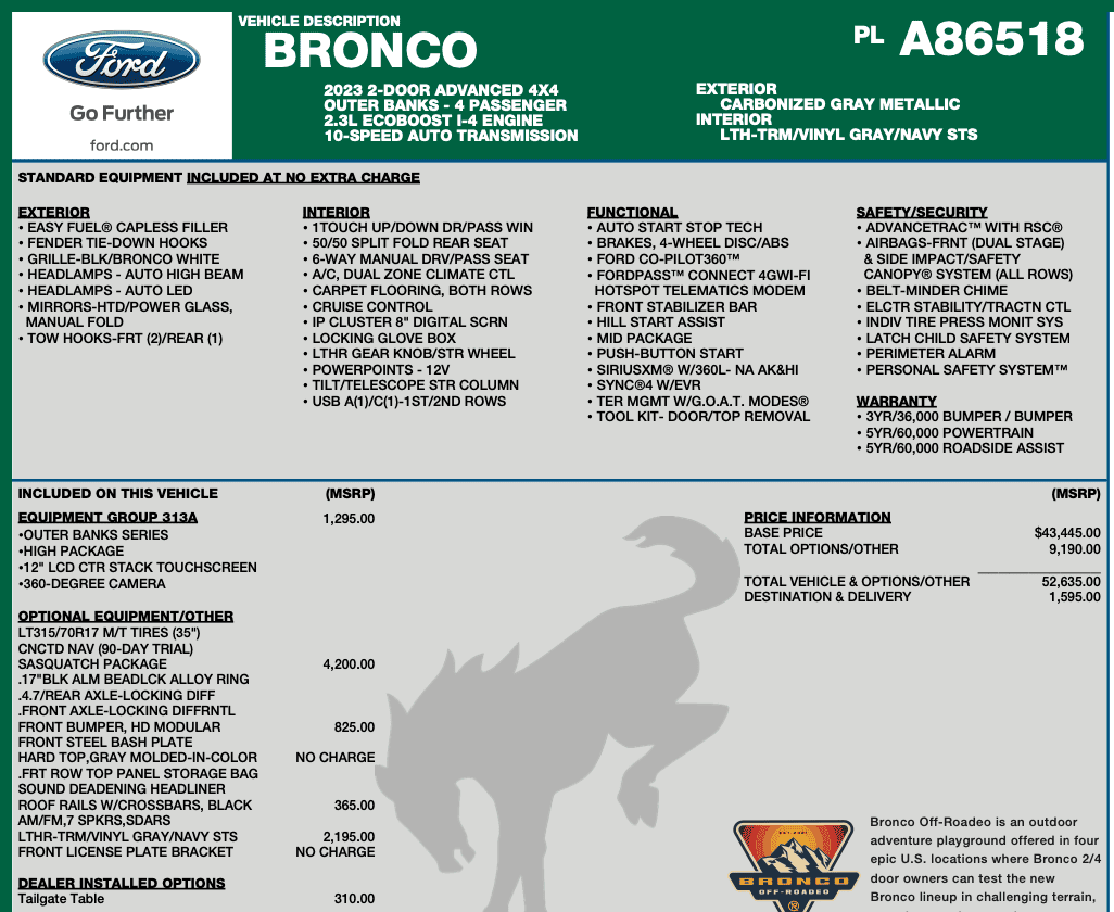

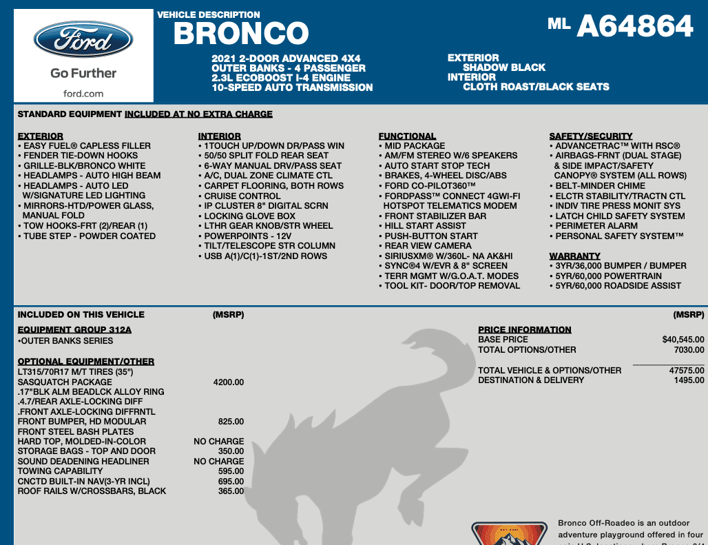

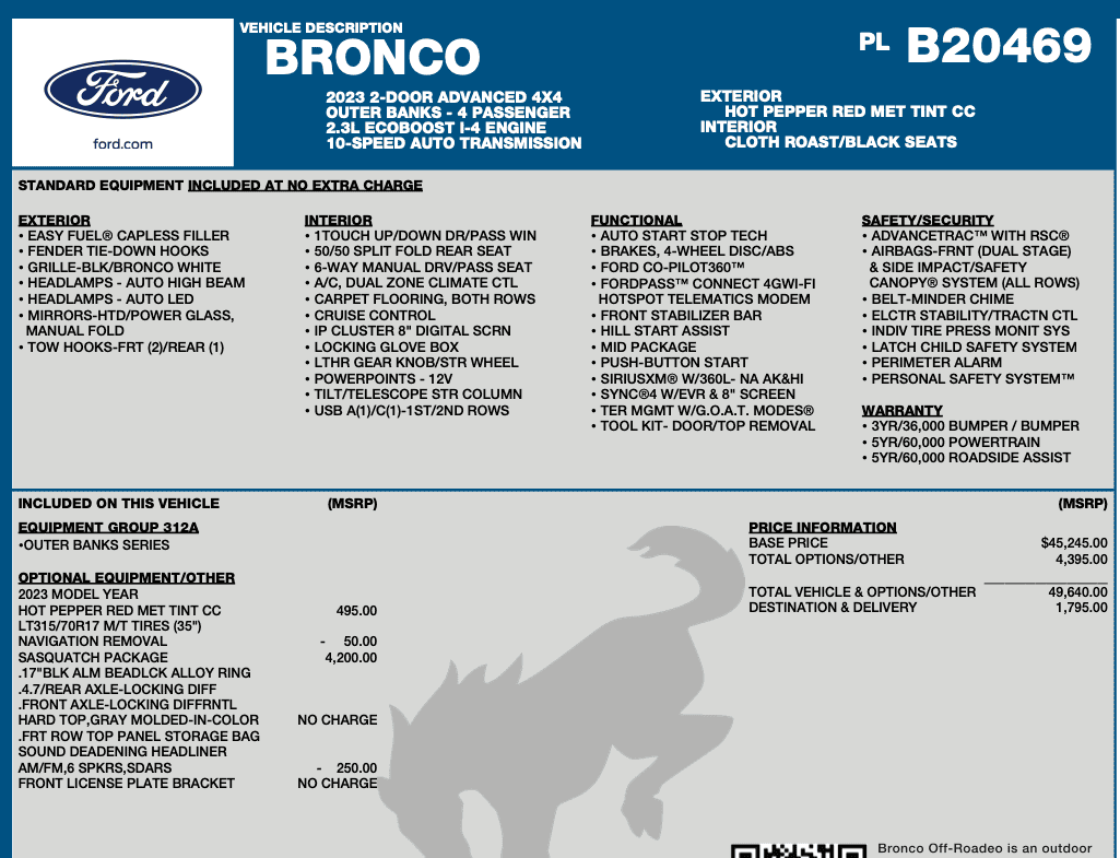

So I went and looked up every single 2-Door Outer Banks Sasquatch I could find. All of them had the "A" variant EXCEPT these two below. Both of these had the "F" variant that I found on all of the 2-door Badlands.
The first one does indeed have the tow package. The second one does not. But they both have the steel bumper and roof rails.
Either way, that Cookbook doesn't seem to fully accurate unfortunately.

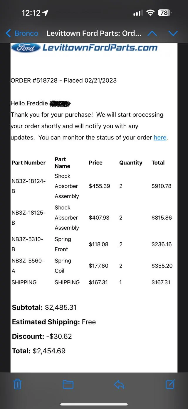

Yep, definitely possible. I own a Wildtrak now, but I purchased a set of Fox struts and springs for an Everglades that I previously owned earlier last year. I used the Bilstein shocks from the Everglades to assemble the Fox shocks.
Yes, all of the parts are cross-compatible, and are probably assembled from the same parts bin. Since the shaft on the Fox strut is larger, the ID of the Bilstein bump stop needs to be drilled, but that's it.
The struts and springs were purchased from Dave at Levittown. I will see if I can find the receipt.
EDIT:
Here's the receipt from almost a year ago.
