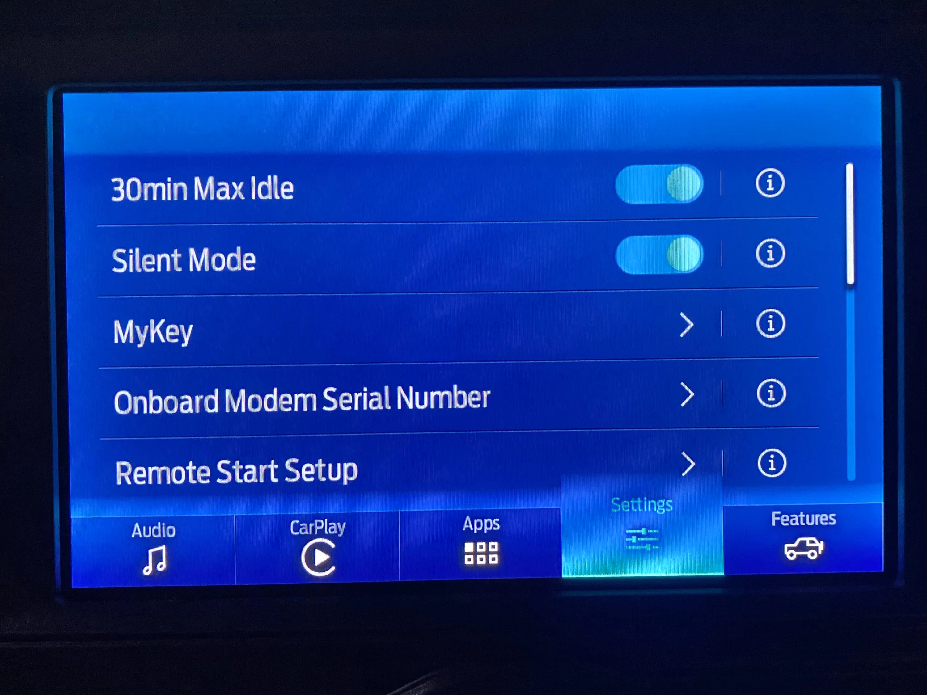

Sorry…
Sounds like I made it even more confusing. I’ll explain it the best way I can.
in a nutshell…
I came across that police idle thing, thinking that that overided
The 30 minute idol you guys are all talking about on the screen in the middle of settings on the display.
but what I came across was that playing with the Forscan settings,
I ended up getting an extra button underneath that 30 minute idol button that allows you to turn the silent mode on an off from the actual screen
And not in Forscan.
Has nothing to do with the idle time.
It’s an extra function that showed up in the menu from playing around in the computer.
It is normally not on the Bronco.
So in addition to fixing the lock problem with the doors, I ended up getting that extra “soft” button
By pushing and pulling in, clicking and messing with the computer, I got lucky is all I’m trying to say!!!
