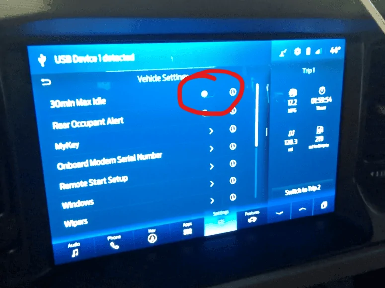

permanently disable 30 minute idle timeout

that turns back on with every engine restart. but yes, it disables the timeout. i'd like to shut it off forever.
I didn’t realize it resets itself! That’s another dumb thing ford did added to the list.

I may have figured it out!
Ford Bronco permanently disable 30 minute idle timeout 1677883676002
in forscan, in the IPC config. You can disable auto idle engine shutdown, but it has a message attached that you must change one more thing in the BCM config. But it doesn't tell you what. Well after a little experimenting, it appears to be "police idle" that has to be enabled.
Once both were applied, the 30 minute max idle is off on every startup!
By god, if i want to let my vehicle idle for 2 hours, i want to let it idle for two hours!
